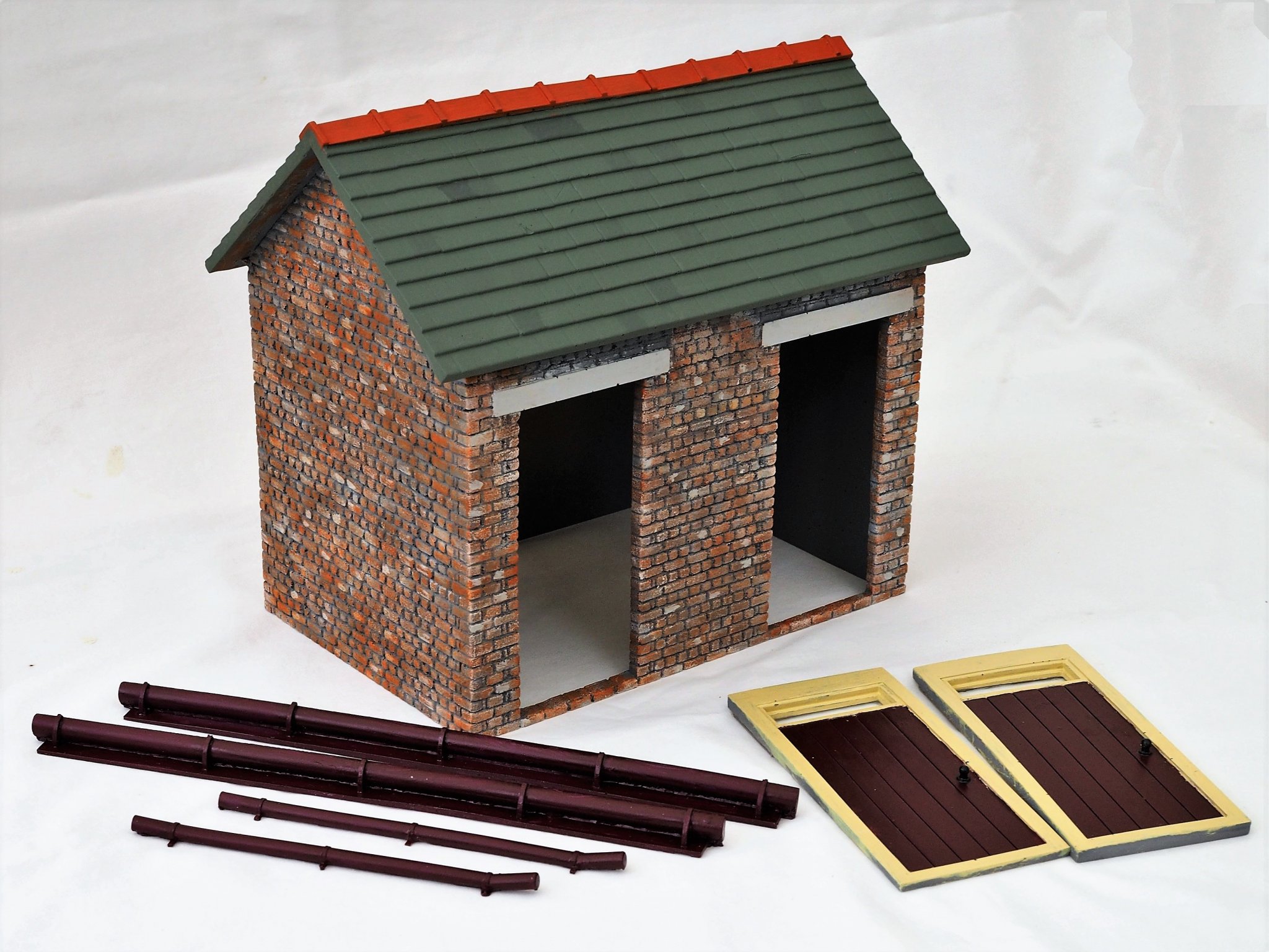

The next photos show the building with the doors, guttering and down pipes, painted and ready to glue on. I am waiting for some 'weathered concrete' paint to arrive, to overpaint the lintels above the doors, before I complete the assembly. Also waiting to be added will be some facia boards on the gable ends. Until the guttering is in place I cannot gauge the size and fit of them.

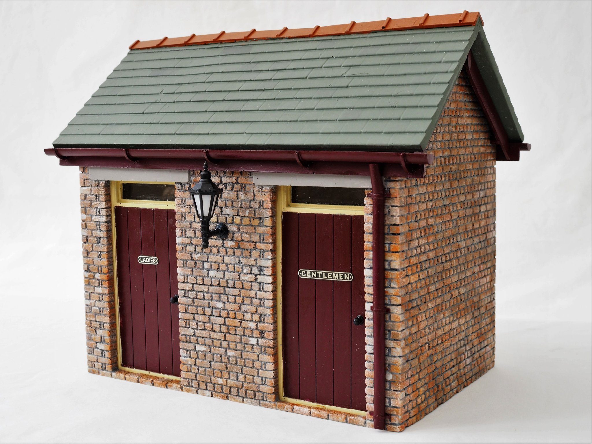

Once the guttering was glued on to the front and rear I was able to properly assess the fit of the facia boards to the gable ends. The angle of the facia boards did not co-inside with the angle of the roof. Rather than fabricate new boards from plasticard, I decided to alter the resin castings. The first thing to do was saw through at the apex and file the ends to alter the angle. I then glued the two halves together and added a decorative plasicard offcut to hide the join line. I then reduced the lengths of the sides to fit between the guttering. Once painted, they were glued straight on to the gable ends. The downpipes were then glued to the guttering.
One substitution that I did make was to replace the ‘Ladies’ and ‘Gentlemen’ moulded signs, supplied with the kit, as these appeared to me to be over large. I substituted them with smaller, neater brass signs purchased from Pendle Models.
An addition to the building was to install a 3Volt LED wall lamp, purchased from eBay, to the front of front of the building. This is powered by a 2 x AA switchable battery box. The battery box is held in a cradle, glued to the building interior, and secured by a moveable arm to facilitate the changing of batteries.

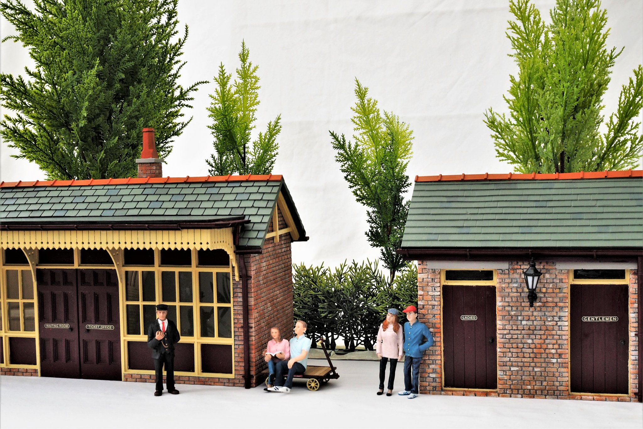

The finished Kippo Models Toilet Block for Gernise End Station on the Claptowte Railway.
