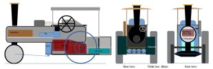

Greg,
With regard to the sound, could you reduce the boiler length so that it does not go so far into the chassis and put a speaker in the box area left making it a sort of amplifying box?
If room is an issue I have shoehorned a Hobbyking RX into the backhead of a loco similar to a Stainz by taking off the plastic body, once the body is removed the circuit board is not that bulky and the pins can be bent to fit the plug or maybe the connection could be hardwired to the board.
It could be mounted over the PICAXE board leaving enough room for a sound board or running a parallel program in the PICAXE that is just a chuff with no variation.
Food for thought or maybe some tormenting depending on the point of view, you can chastise me on my next visit. ;)

Thanks for the suggestions Graeme. It possible I could cut the boiler where it projects into the 'box'. I had left it there as I was worried about the strength of just gluing a short tube section onto the box front. BUt maybe a whole lot of epoxy around the joint would be strong enough. I do tend to lift the engine up by the boiler when I'm not thinking.
Interesting idea to take the hobbyking Rx out of its case. Filed away for future reference. I have an old failed Rx, so could experiment with that.
