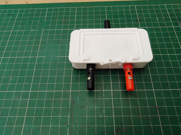

Something like this, box from Screwfix, Debox In-Line Connector Box, two holes at the front for the sockets. grommet on the rear for the two cables out, once I've connected it up the little test layout outside, will cover the exposed solder connections, and make a seal around the inside of the lid with Liquid Electrical Tape, used them previously for all manner of electrical connections around previous Analogue and DCC layouts, both inside and out.
Box will screwed on the underside of the test layout, somewhere with easy access, when done playing testing, unplug the Banana Plugs, wind the cables up, easy to take back indoors,

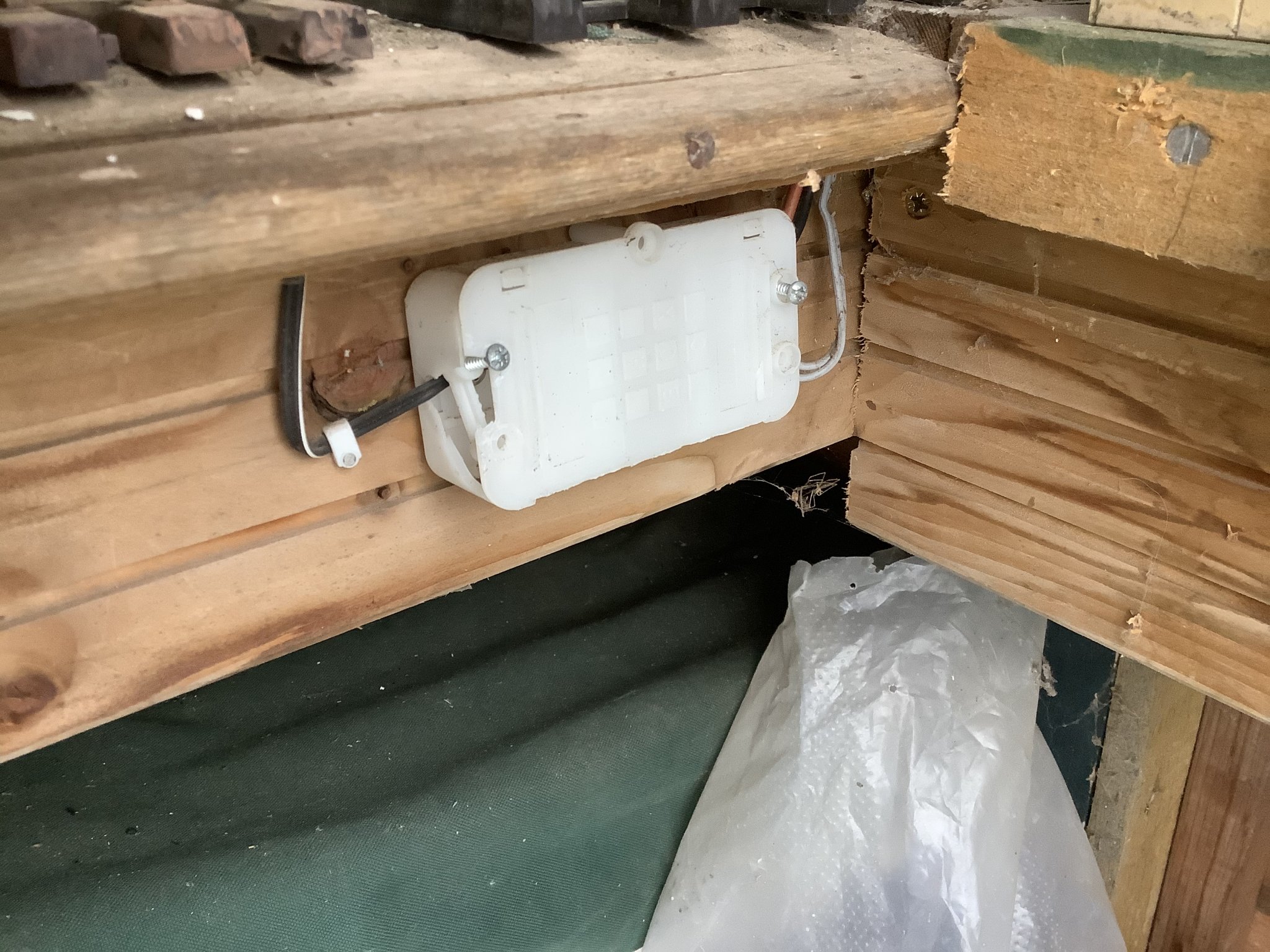

Have used some of these as junction boxes for the layout. This one has almost disintegrated as it gets morning sun. Another disintegrated completely as it got sun all day.

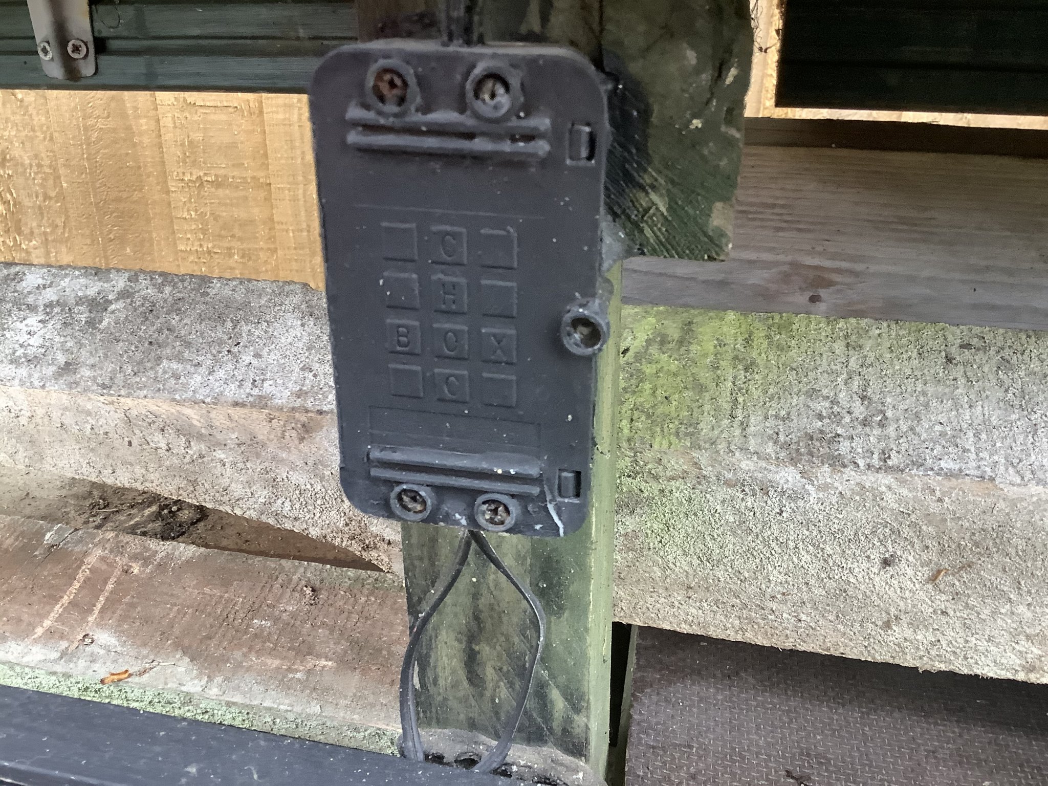

This one has survived quite well, gets morning and sun till around midday but has been preserved by the spray of halfords matt black rattle paint. Note the Rusted screws, perhaps a dab of grease or vaseline when fitting may help.

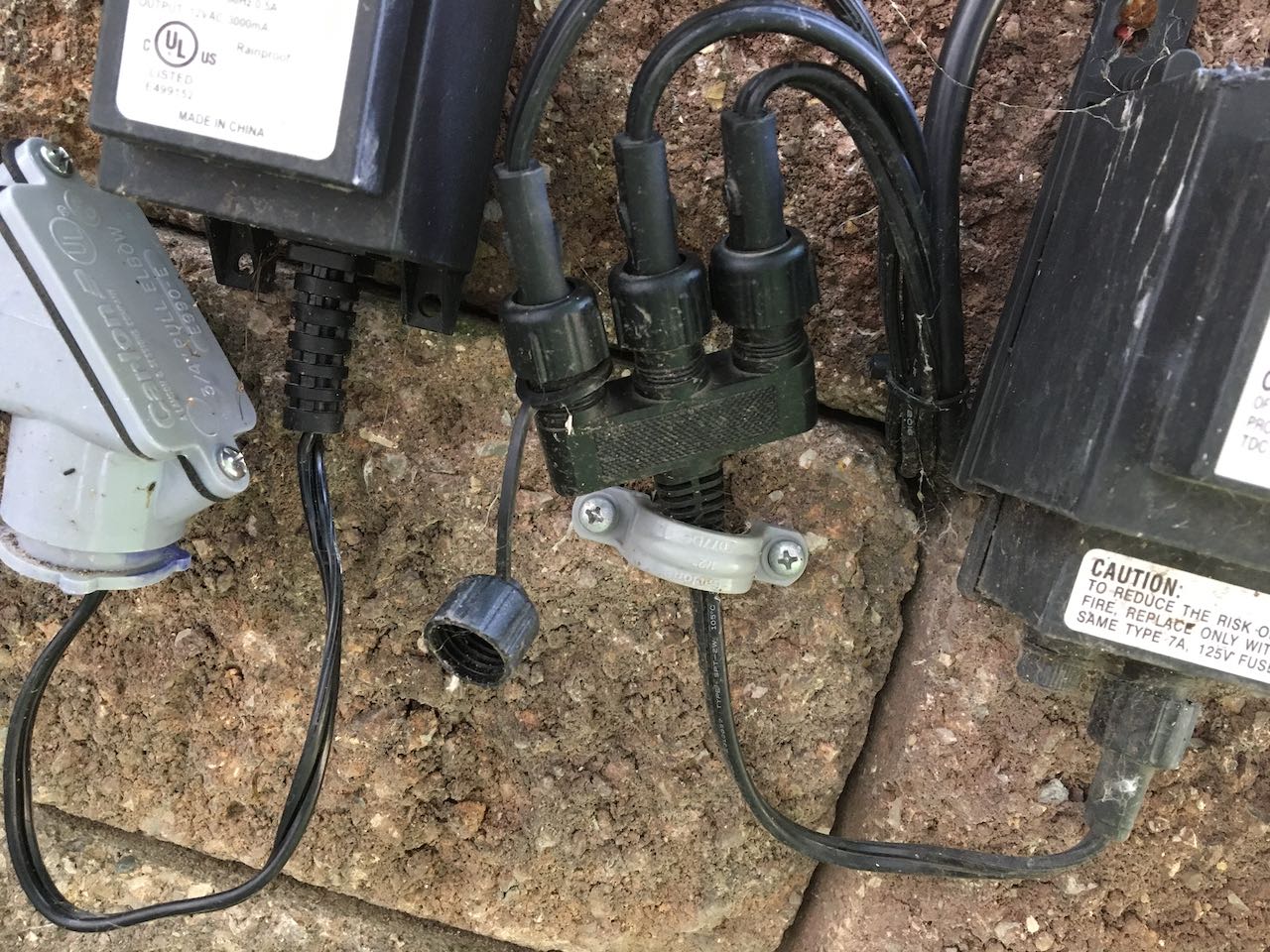

Here's another thought if the bridge clamps don't work out. Try looking at low voltage outdoor lighting extension cords. You'll get a plug and mating socket plus a screw on cover for the socket when not in use. The wire is typically 12 - 16 awg so no significant voltage drop if kept short.

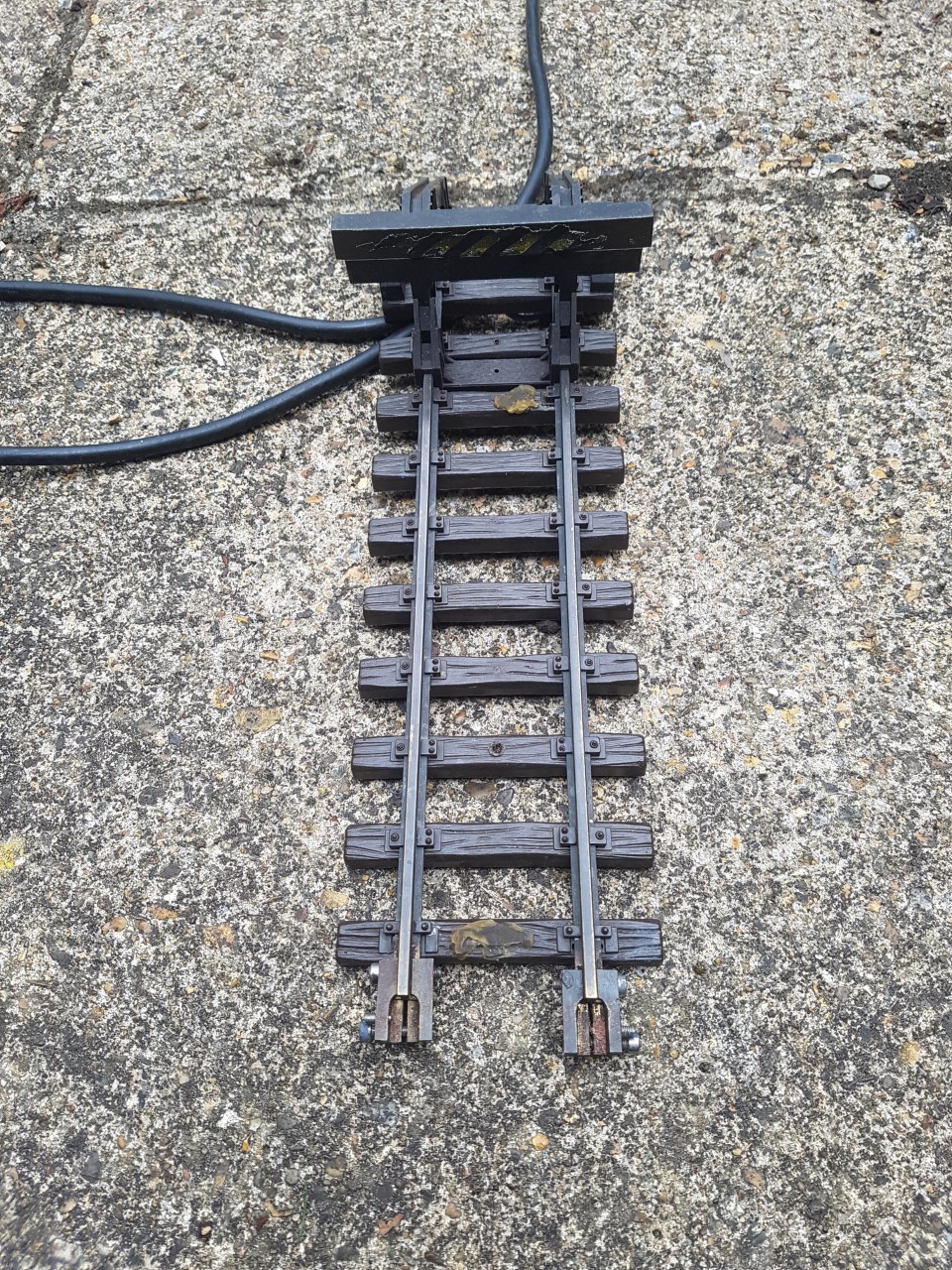

Today after I arrived home from work, I fitted the bridge clamps I received last week from Chris.
A quick test and it seems to work well!
