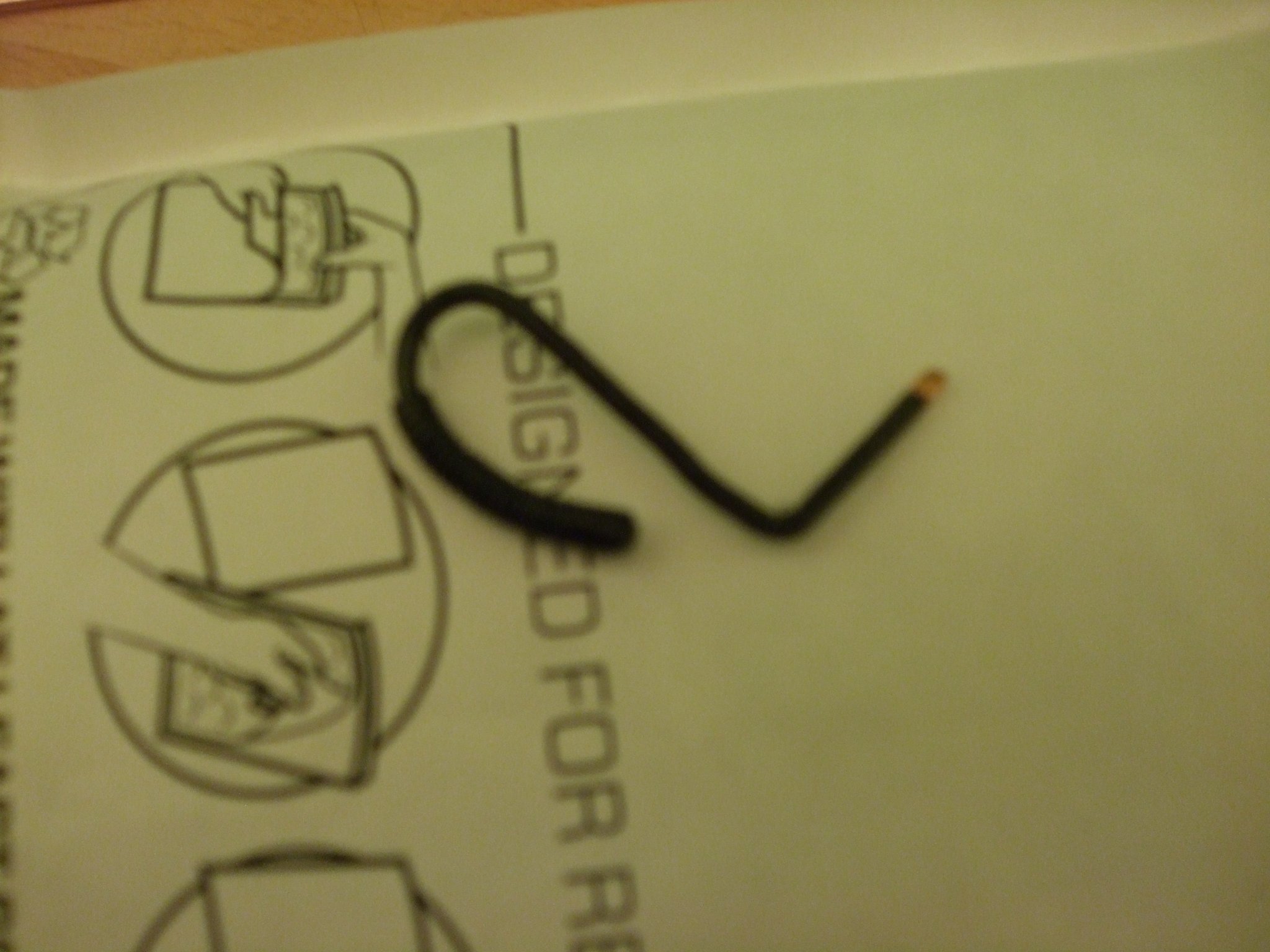

A few weeks ago, on a thread relating to the Bachmann Lynn, someone (I beleive it was Jon Dunnyrail) suggested using copper wire to make replacement brake pipes. So, as I had some coaches crying out for such things, I decided to have a bash. Please note, this is not in anyway accurate modelling, in fact the 10 foot rule rather than the 6 foot is the order of the day!DSCF8804.JPG
Basic requirements. The thicker copper wire is stripped from a piece of 2.5mm Twin & Earth ring cable which is pretty much spot on for the thickness of the Lynn pipework, the smaller wire from a piece of 2.5 stranded control wire.DSCF8805.JPGDSCF8806.JPG
The copper wire is easily bent to the approimate sapeDSCF8809.JPGDSCF8809.JPGDSCF8810.JPG
The finished item, just needs a quick solder on the ends and a quick paint job.DSCF8811.JPGDSCF8812.JPG
Sorry, the pictures about as dodgy as the modelling!

Looks fine, even with the dodgy photography!

Looks good to me Paul....

Try bass guitar strings! Various gauges, perfect for this type of thing.
My lad plays heavy metal on 6 and 8 string basses with thick strings, and also an electric upright bass with really thick ones!
In the smaller scales regular electric guitar strings are sometimes used to create brake pipes.
If you pop into a guitar shop that does re-stringing they're bound to have off-cuts or old replaced strings.

A few weeks ago, on a thread relating to the Bachmann Lynn, someone (I believe it was Jon Dunnyrail) suggested using copper wire to make replacement brake pipes.
It was my request for thoughts, and this is what I came up with:
Grid squares are 1mm in this photo
Brilliant idea. It's something that most wouldn't have thought about usingguitar strings. Next time there's a double bass player at the folks club, I'll ask him if he has any spares.

Ah but nothing beats the work of all that twiddling with spare bits of varying sized wire, though the guitar string method works it is not as neat as yours. Yes I have in the past suggested this method, may even have shown some somewhere in the long mist of time.
