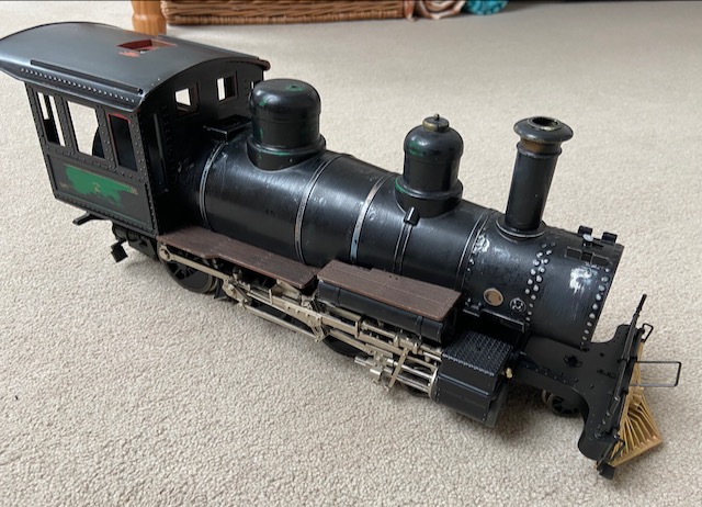

I'm really a British outline modeller, but it caught my eye because it was marked as not working with a very tempting £40 price tag! I do love a bargain and a project, and really liked the look of the chassis - great looking metal side rods, etc., so I couldn't resist. There didn't 'look' much wrong with it functionally and as I suspected on opening it up I found some RC gear inside (I'm selling those bit on eBay so expect to recoup a bit of the investment!). The motor turned nicely when given a bit of power, so I have removed the RC gear, put a DCC decoder in it and it now runs very nicely indeed!
I went with a reasonably priced Zimo MX635 decoder - really an 0 gauge decoder, but it has a decent current rating (1.8A continuous). I'm fairly convinced that my locos rarely draw more than 1A - trains are quite short on my line and top speed is very limited. In any case my 4 year old tested it for me at maximum speed with a couple of coaches and it ran very well. I've now limited the top speed to something more sensible for my line!
I think what I've got is an old Bachmann Ten Wheeler body - sanding the tender revels Atchison Topeka Santa Fe on green, red cab roof, number 7. It has been sprayed black and had most of the detail parts removed. The tender has been fitted with metal wheels in brass bearings (which needed an evening of fettling, but now run nicely).
I'm pretty sure the loco chassis is a newer replacement in excellent condition - missing only the cowcatcher and bars to the smokebox I think - in any case this is in great condition and happily runs really well.
I had thought that I would extract the chassis and ditch the body, but quite quickly became attached to the whole thing - so instead I'm going to attempt a bit of a restoration. In order for it to feel at home on my railway I will imagine that my narrow gauge railway company has imported this large tender engine from the Baldwin in the US (much like the Lyn on the L&B). I'm going to sand it down, repaint to look a bit more British and detail it. My wife and son have decided on red for the loco, so red it shall be!

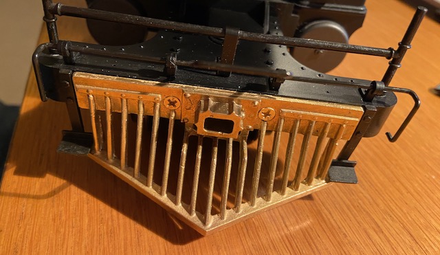

I have added a brass cow catcher - also bought from GRS - and begun sanding down the body.

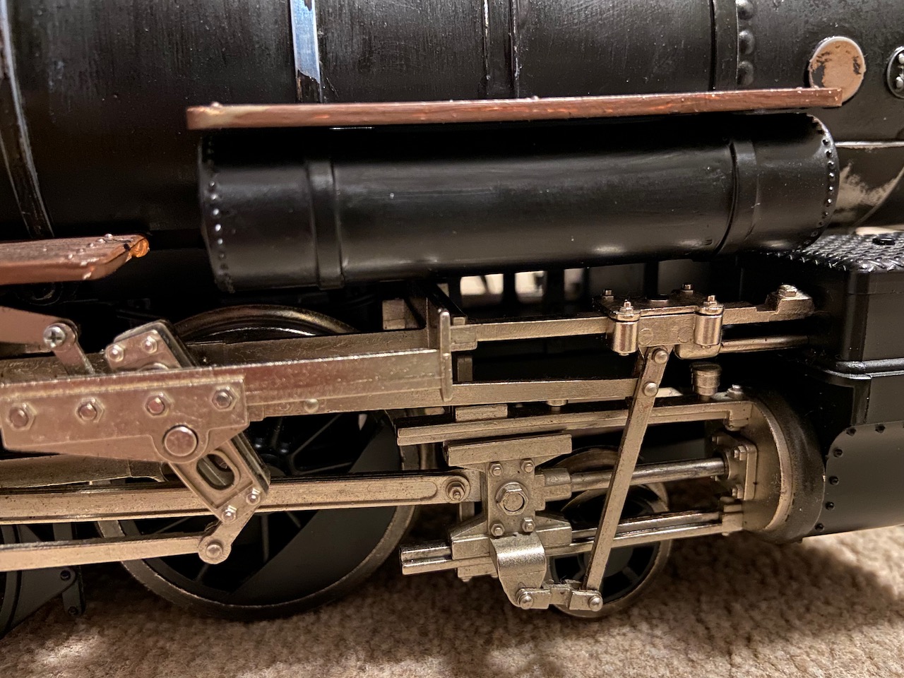

I have started sanding down the body - just figuring out how far I need to go. The smoke box door and light have been removed for painting, but I couldn't resist putting the loco back together with the new parts to see how it will look!
View attachment 295702View attachment 295703
When I carried out my refurb of a 10-wheeler with that valve gear the "crosshead"? caught on the underside of the tanks, the forward strapping which need a little modification, here is my blog on it:

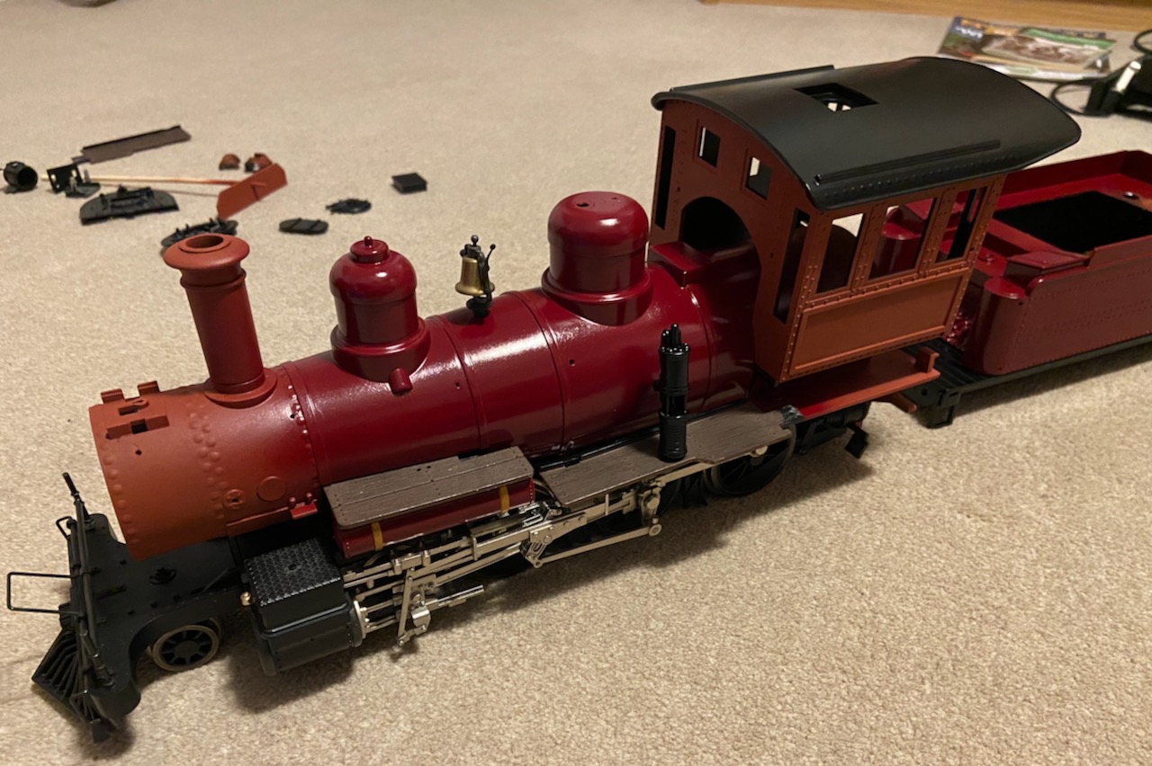

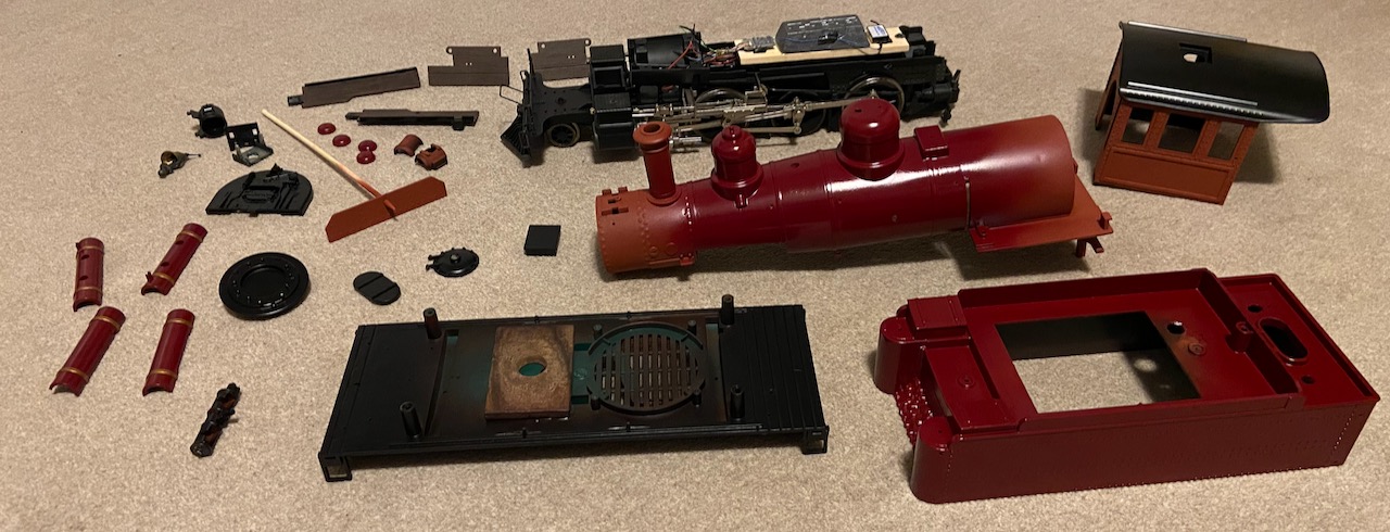

Some progress has been made!
The respray is well under way. Here are (most of) the parts...
And I couldn't resist a loose fit to see how it's taking shape.
I've also added a little more weight over the driving wheels - I understand a weight would originally have been here. When I test ran it I didn't see any problems with traction, but I'm generally in favour of additional weight with balance over the centre of the drivers. The support has also given a good place to fit the decoder.
For now I will continue to paint and spray the parts and will report back as I progress.
Thanks to Flying15 I now have a bell and a light for the tender! Just waiting for some bi-colour LEDs for the lights - I'm quite sure that these big headlights lights being red wouldn't be prototypical, but I really like having the light colour change from warm white to red with direction so I am applying Rule 8 - actually as ever Rule 8 will be applied liberally!

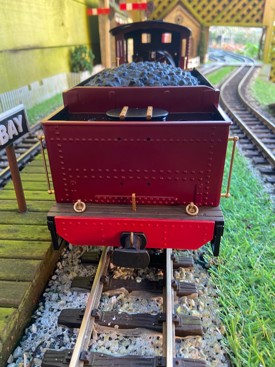

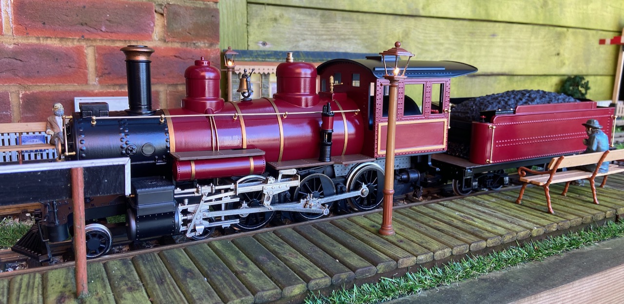

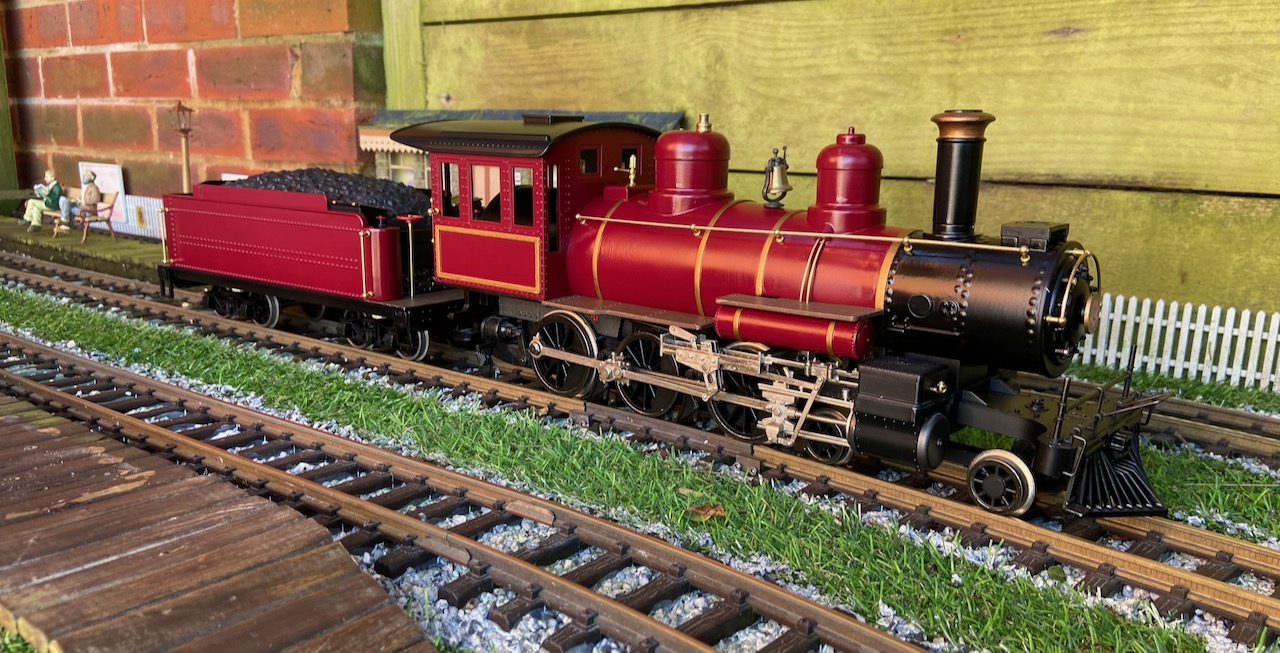

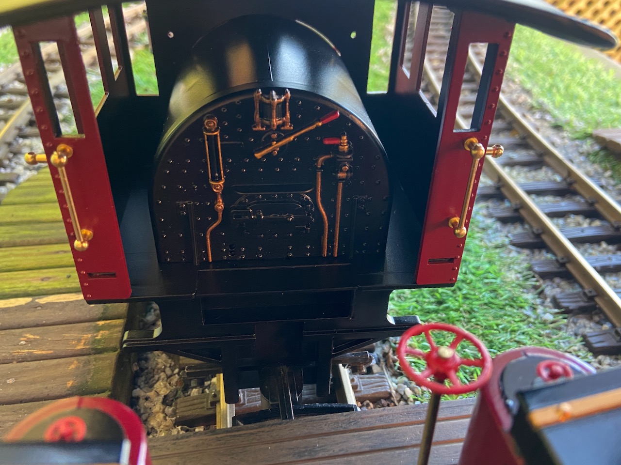

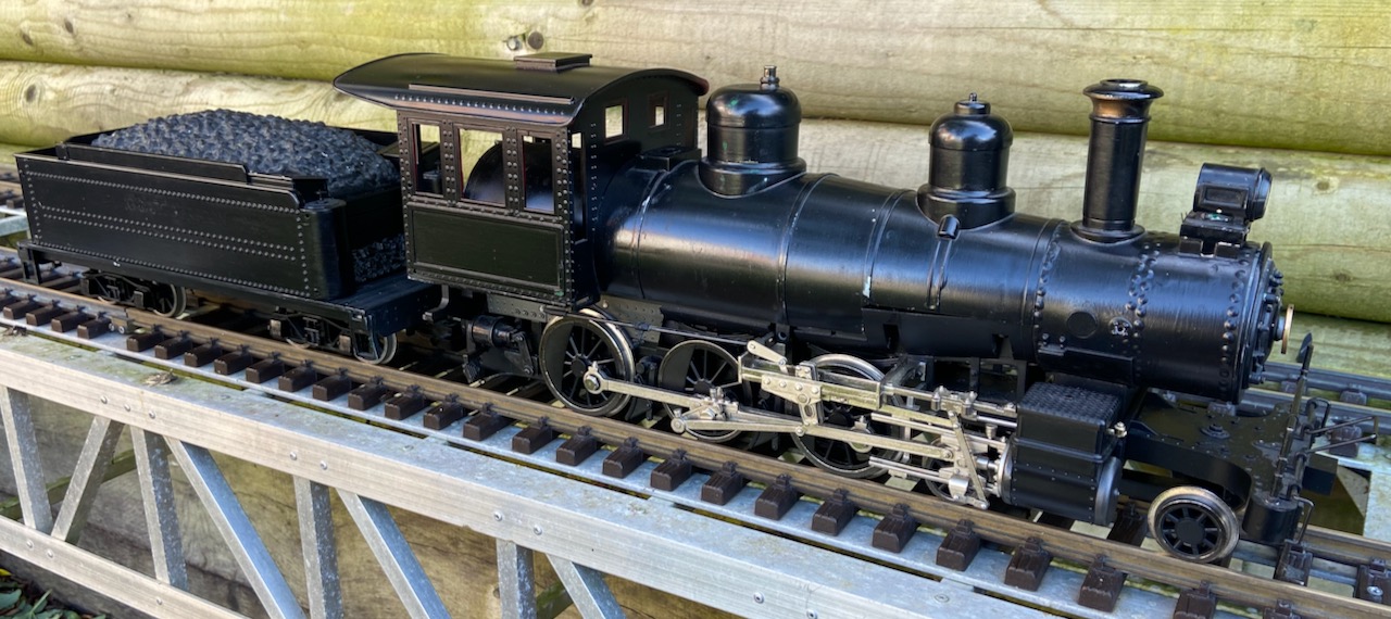

More progress. I've reassembled the loco which is now mostly repainted.
Still to do are the lights (awaiting some bi-colour LEDs), finish the handrails (I ran out of of handrail knobs - it's surprising how many it takes!), maybe some more pipes and as my boy pointed out - a wire from the bell to the cab! I will probably add a number on the side of the cab and the tender - just waiting to see if we come up with a name for it.
However, for now it's added to the roster of locomotives on the railway.

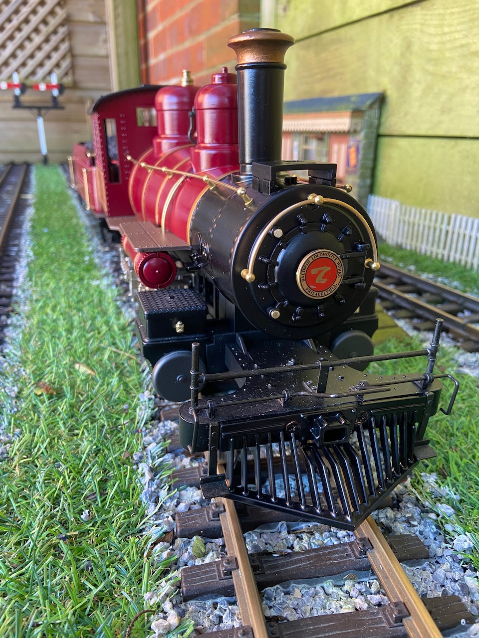

Lovely colour
Thanks Paul, it is Halfords Vauxhall Burgundy Red on top of red primer. Something like LMS red is what I was going for - just a colour I happen to like and we don't have any red locos!

One thing I do find quite puzzling is the gap between the tender and the loco - both the distance between the two and the height difference are pretty enormous. I might be tempted to look at that some time.
JimmyB
23 Feb 2018
7,000
929
70
Weston-super-Mare
www.tumble-down-falls.co.uk
I did notice that with mine, I will be doing a bit more work and look to add some checker plate.
