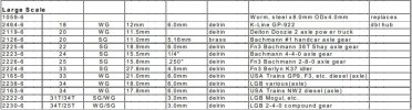

I just received an e-mail today stating that NWSL are now open for business which is welcome news. NorthWest Short Line
The website is still without images etc. and I can't find the gears for Large Scale.
Below is the Large Scale part of their replacement gears from the PDF on their old website.
I hope this helps with ordering from them if they still supply these items. As said before, it is best to count the teeth on the gear you need rather than going by their description for the 4-4-0 (or 2-6-0) which can be misleading.
