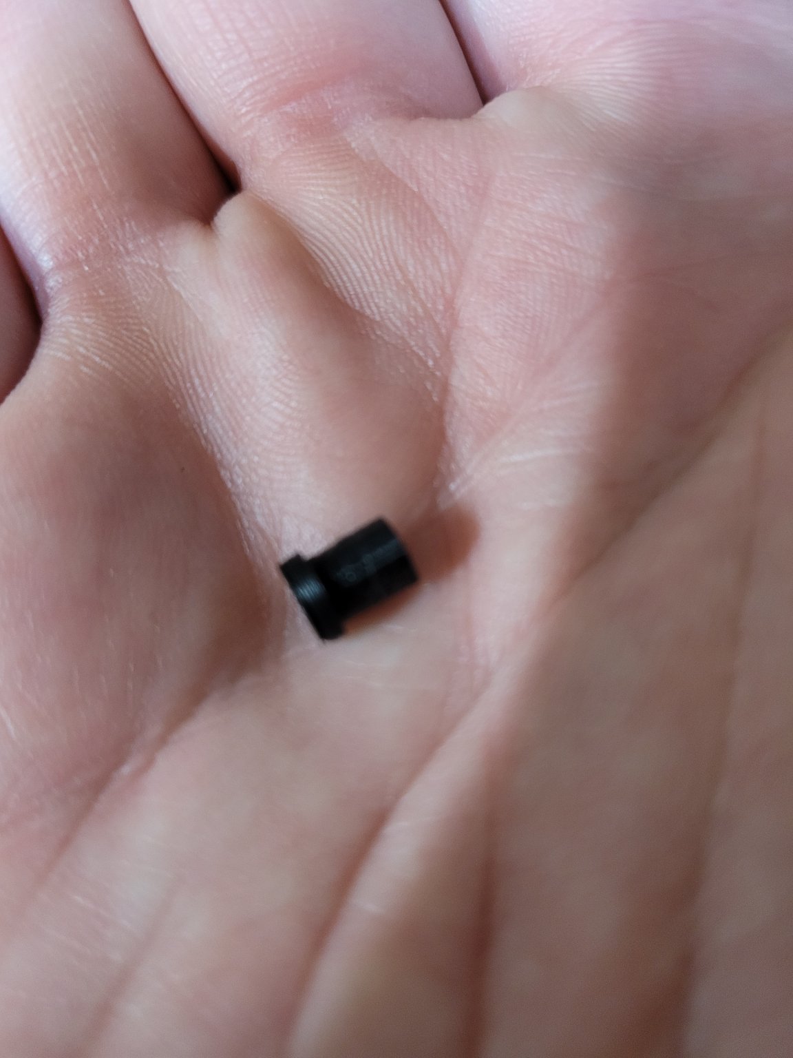

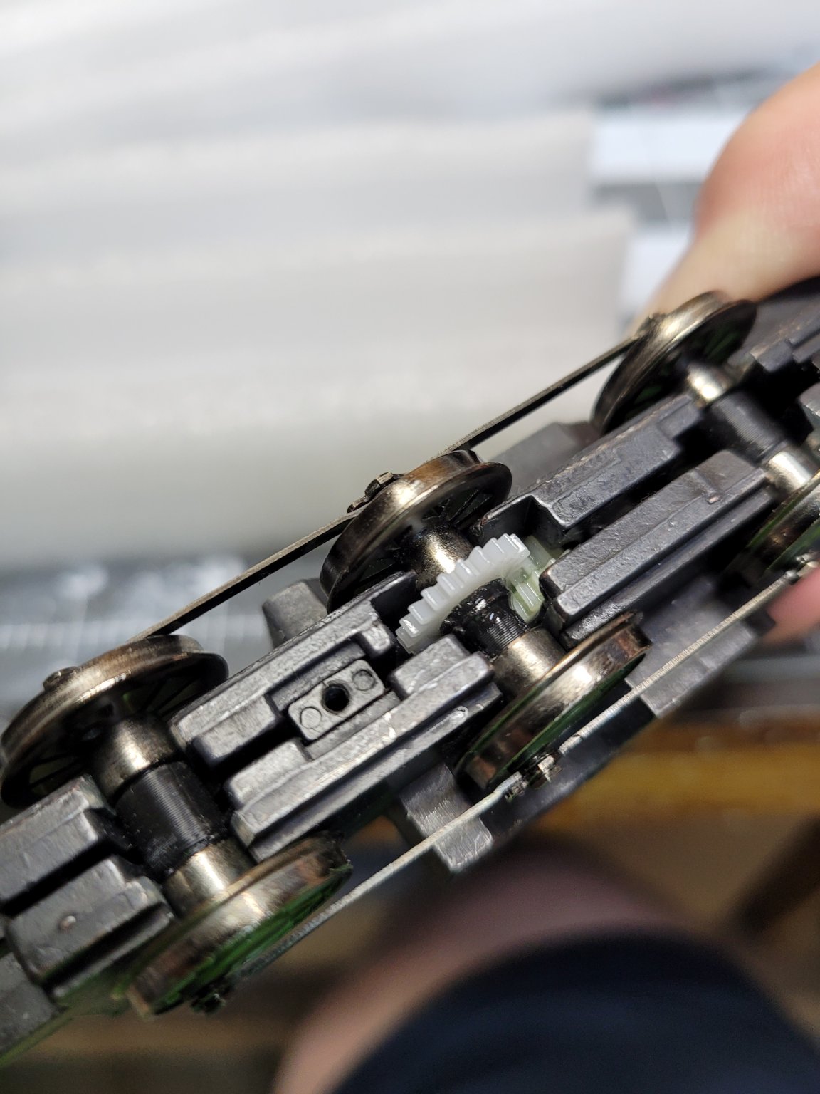

Not large scale but I love OO too. Has anyone come across a print file for the square peg split axel gears like the big haulers use but in OO? This thing is beautiful and I don't want to give up on it. All possible replacements I have found would be $30+ shipped to the US!

I appreciate that, thank you. I have asked Bachmann and am awaiting their reply also so we shall see. I have hunted high and low for a print file, if I don't hear back I may give designing on a go lol.
Pretty sure that is...I put it in the cart last night and it was going to be $30 shipped lol. I'll keep trying before I pull that expensive trigger! I emailed Bachmann UK so hopefully they are feeling helpful!!!
Well I'm calling it a mild success. Split the chassis, cleaned out all the had grease, cleaned the motor and lubed it up. Threw a quick down and dirty test gear together and printed it. Square axel pegs fit perfect. Length seems pretty good as does the gauge. Threw it on the test track and ran it around. I am guessing the gear teeth may be too fat and tight as while it does run, it is noisy. There is no play in the gears. I changed the pitch and shrunk it down just a hair. I'll test print another after work tomorrow...takes about 12 minutes at the highest resolution. The last rendered picture is V2.

A couple revisions later and I have a running locomotive but it is still horribly noisey. I haven't given up but after a dismal Rovex Princess Elizabeth purchase that needs major help...I'd really just like a running OO while I work on other projects lol. PhilP I'll hit you up in the DM to find out more if your offer still stands. Bachmann UK pretty much told me to pound sand lol.

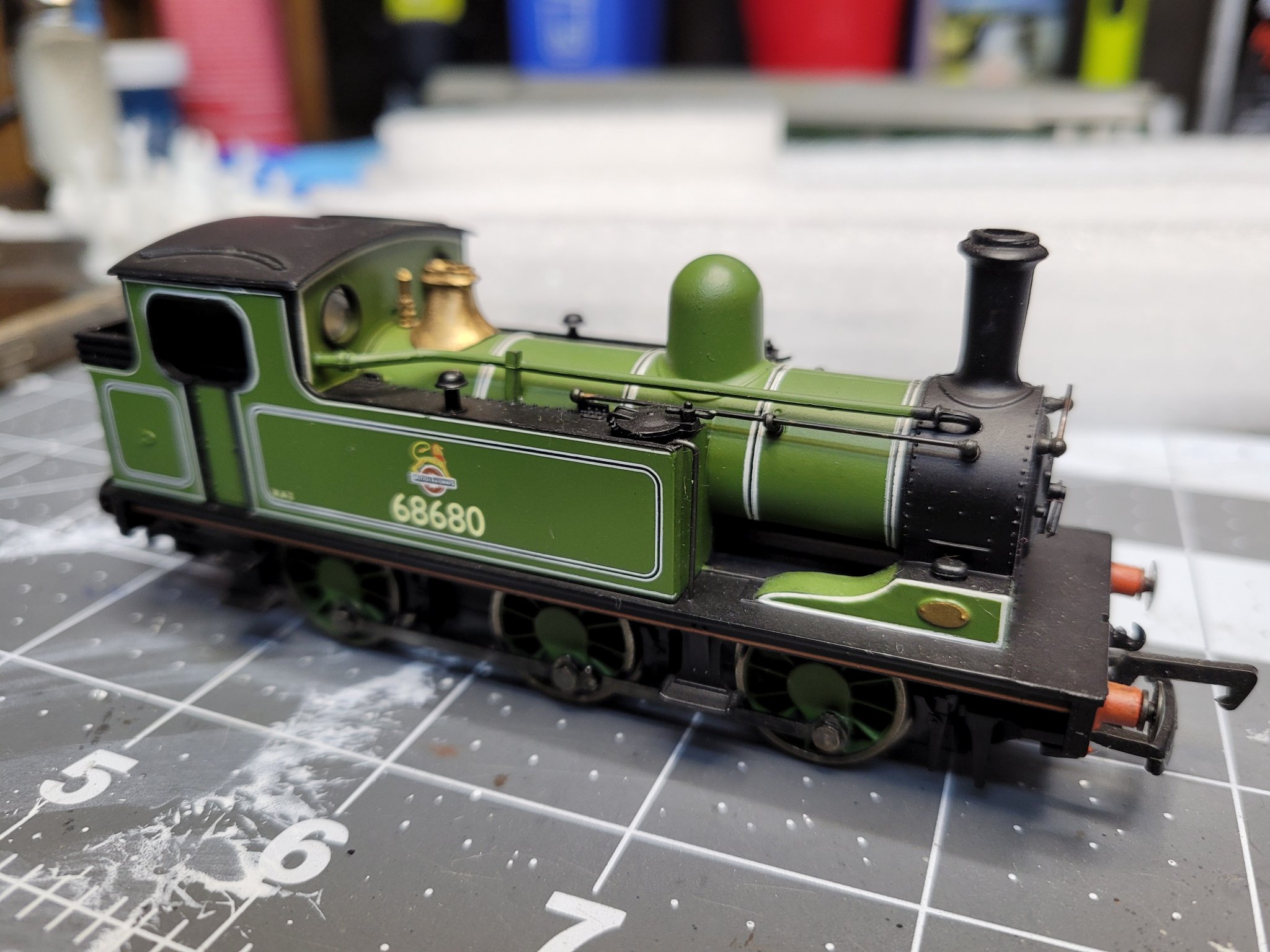

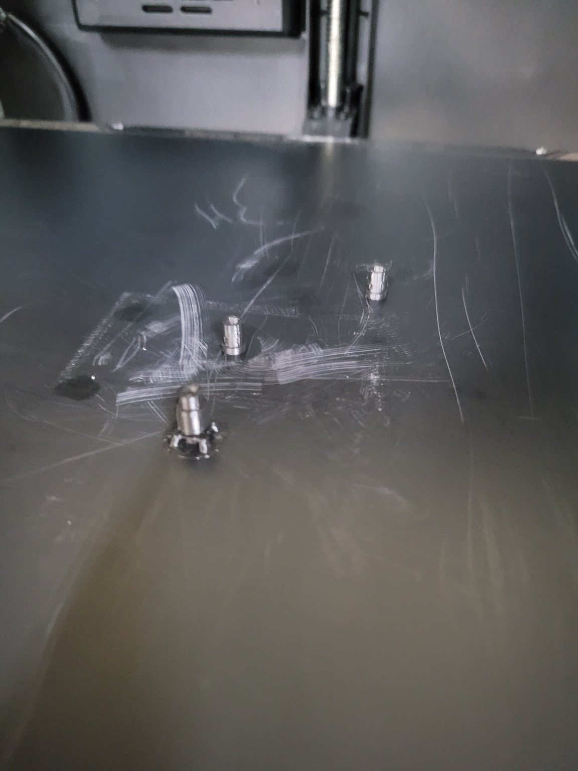

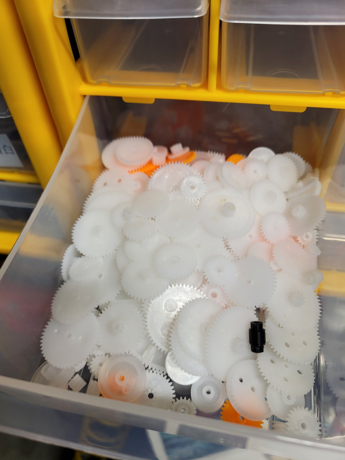

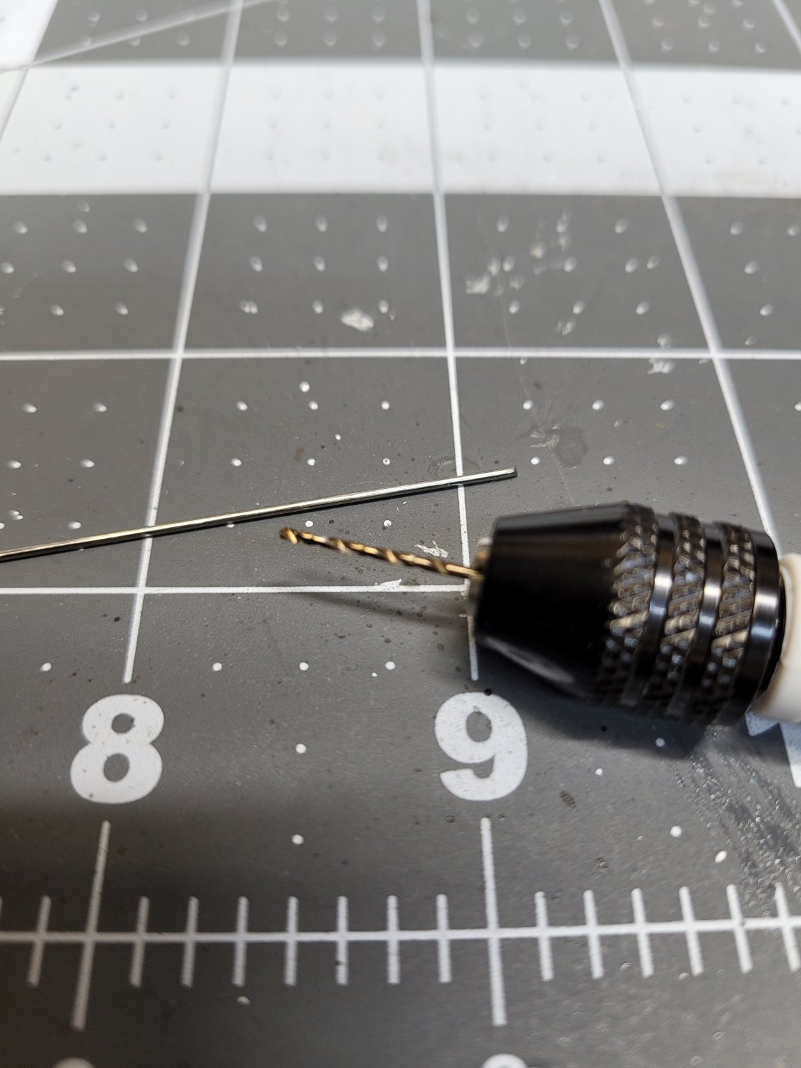

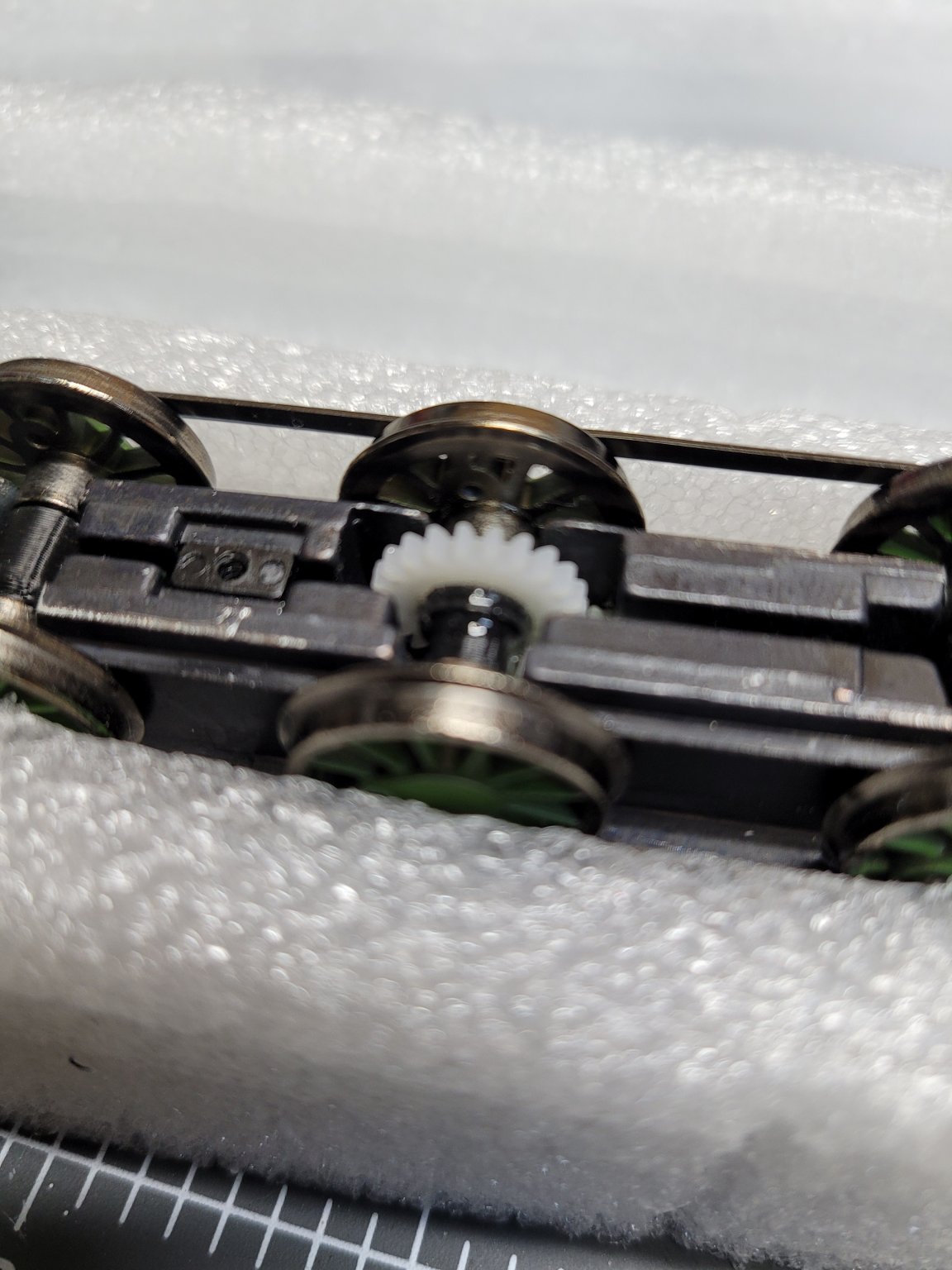

For anyone interested, I did manage to get this J72 fixed on my own! The ones sent to me very graciously unfortunately arrived broken. After giving up and deciding I'll just design a new chassis. The stock one is so heavy though I didn't want to give up. I ordered 2 huge grab bags of random gears from Amazon and started digging. Eureka! I find one that's exactly the same size and pitch. It had a round collar on one side so I drilled a 3mm hole through it. Being the collar had an OD of 4mm it fit perfectly in the wheel. I then designed the square peg shaft for the other wheel and added a flange to the end that meets the flat side of the gear. I designed a 3mm hole in the flange side so I could use a 3mm shaft through the gear as a locator peg. Using a pen vise I drilled 2 holes through the flange and into the gear and super glued 2 pins cut from stainless music wire. Mixed up a batch of slow epoxy, gave a layer to the flange side, then filled the peg side and fitted it on the other wheel and set the quartering. Next day, fitted everything and lubed it...she's a smooth, quiet runner!!!20250415_170452.jpg20250415_170523.jpg20250415_170510.jpg20250415_165207.jpg20250415_165051.jpg20250415_165142.jpg20250415_170427.jpg
