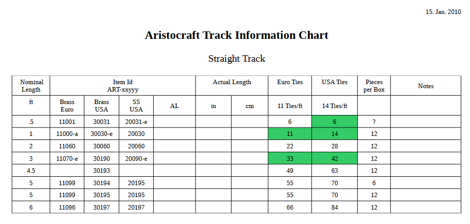

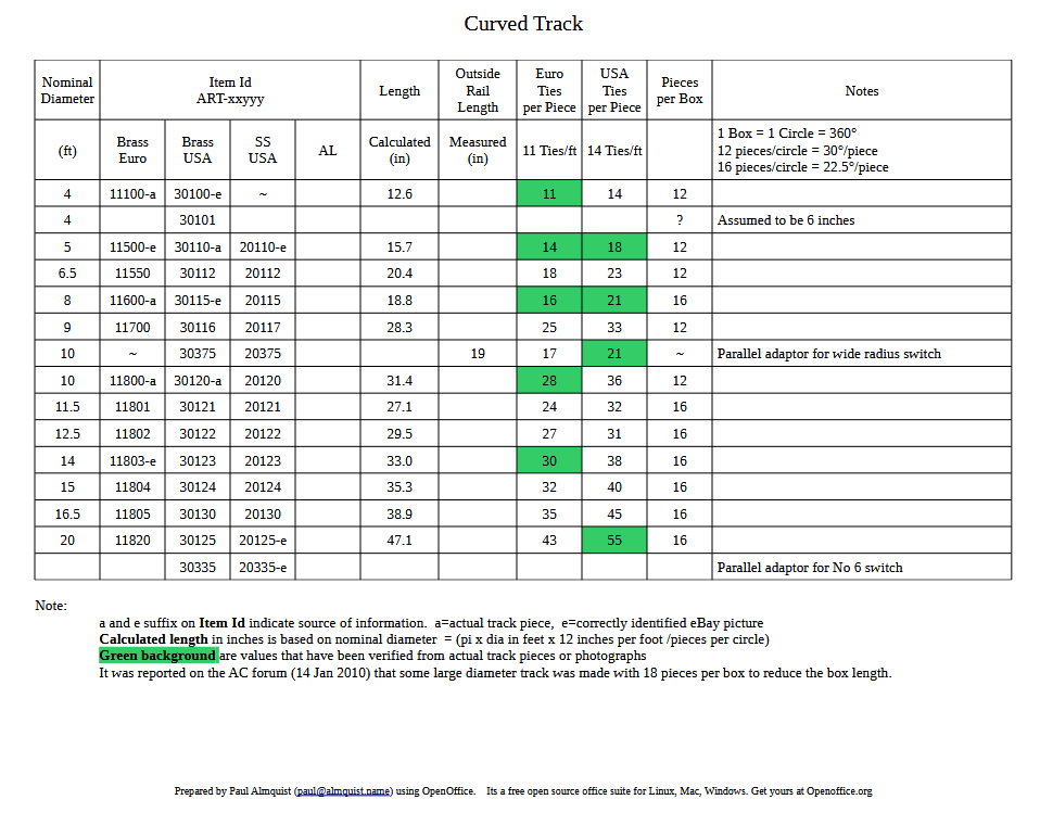

I remember there was a website that listed the numbers of sleepers in each track curved length by radius; does anyone have this information as I'm trying to sort out a big pile of used track I have into radius.
Thanks, I seem to have a lot more wide radius track than I thought I had. I think I will have a couple of spare circles of 15 or 16.5 foot diameter which I could sell if anyone is looking to build a large layout.
