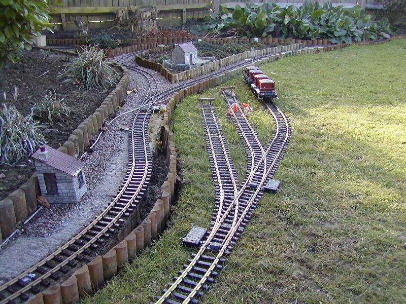

Oh and just to show that Trains set up and pulled apart can work Sarah, have a look at this short vid of my Auto Line that I take to BBQ's. Not DCC but fully automatic, though I have not yet figured out reversals and point changing to match as yet!
