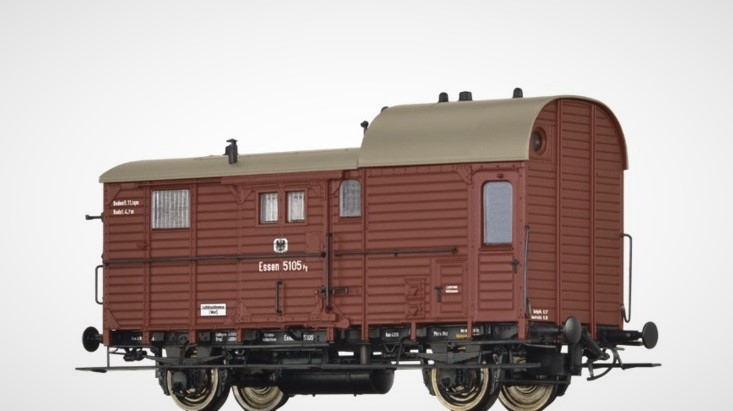

Hello, a few weeks ago I started to build a postal wagon to be added to the OcCre train.
I used wood I had at home and I took the measurements from the OcCre models BR 18 and Costa MZA that I just finished building.
As a first job I made the alluminium wheels with the lathe
I built the frame and the first walls
I do not have a drawing but only a couple of pictures taken on the internet, so I'm doing my best to build this model with the few information I have available
http://www.osterthun.com/0Laenderbahnen/Paeckwagen/paeck~pics/B49412-ann.jpg
http://www.osterthun.com/0Laenderbahnen/Paeckwagen/paeck~pics/B49400-Lv.JPG
probably it will not be identical but I will try to build a decent model

i like your "all wood" aproach!
thank you!!
the sliding doors were not simple to build, I had to make a track able to get them out to overcome the thickness of the windows and handrails
now I'm building the roof (still not glued) I put most of the glass on the windows and one led inside the cabin

I mounted the crossbows, they are made up of 32 pieces each
I built tanks and platforms
to get the bumpers I used jeans buttons
ladders are in brass and styrene
I start painting with Vallejo smoke patin
now I'm building brakes

How did you make all the bolt heads ? Or are they nails ?
wrighizilla
7 Apr 2018
127
242
54
italy
are all nails.. two type of small naval nails plate and round head.

Thanks. Im trying to look them up and the only thing I see are finger nail and belly button rings lol. Is there a site I might be able to find them? Thanks. I really like the way this is turning out. Great work..
sorry I don't know where to buy nails.. Cornwall model maybe?
i have a separate sector box with many different nails taken from boat finished kits.. the plate nails are from Artesania latina.. te round are from Occre train models..
also you can contact this comèanies and ask if they sell nails..
look at this way to do nails..
is very easy, I made 700 in one night.
freshly cut before being scrapped
about patience school. here the Surprise.. hms Surprise — Postimage.org
take a hand drill and mount a nail on it.. press a hole in the wood and insert inside a piece of iron wire, copper wire etc..
fix it with ciano or shellac, and then cut it .
sand it to flat or keep a small part if you like a button head
I have used this way on Costa coach, this nails are in copper filed flat, are a little more elegant respect brass head nails
