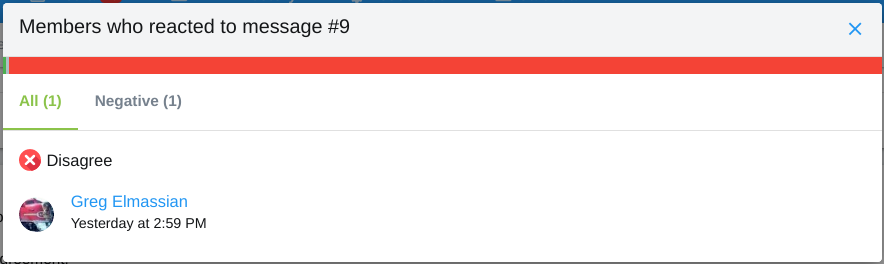

I understand now... You marked my post with 'disagree' because you thought it referred to the original locomotive(in which case you would have been right to disagree):
But the antecedent was actually my own prior question involving my loco, so there was some confusion. No big deal.
