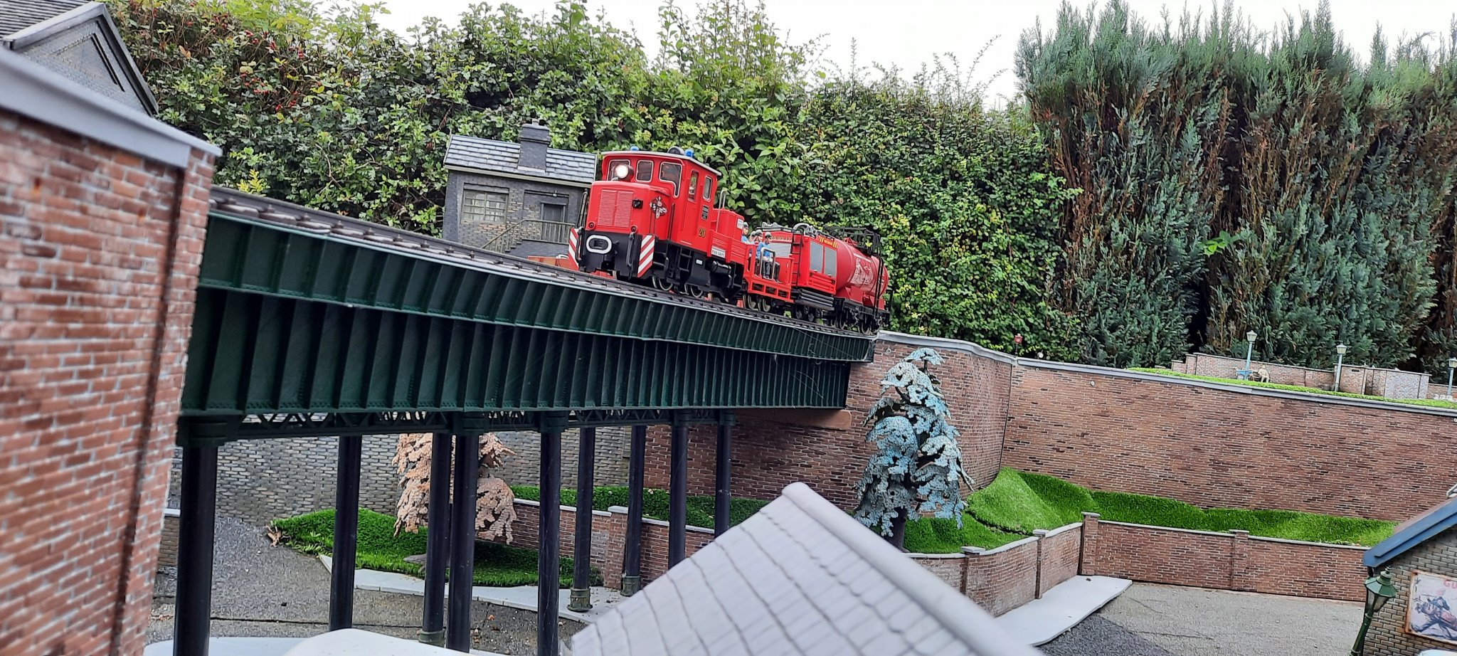

Nothing has melted this year ...pla bridge ,crossing gates ,phone boxes .control boxes , boxes ect all good 20210923_151147.jpg
