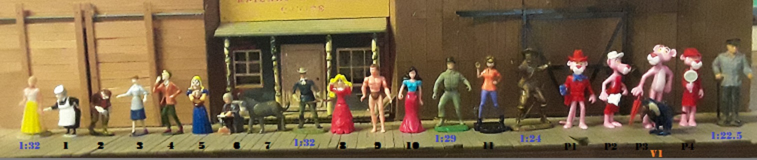

I hope this doesn't complicate things any more but these graphics were on the Argyle Loco Works web site [https://argyleloco.com.au/] and they help me understand the issues a bit...
cheers,
Ian

Basically, in some areas you can mix different scales without creating problems. For example, using 1:32 scale vehicles in the background on a layout can work because they give a feeling of depth to the viewer, but using them alongside 1:22. railway stock, they would look far too small.
