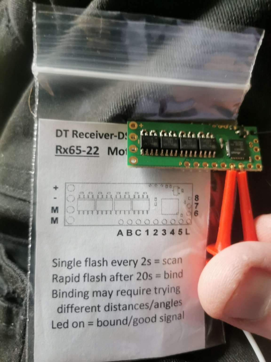

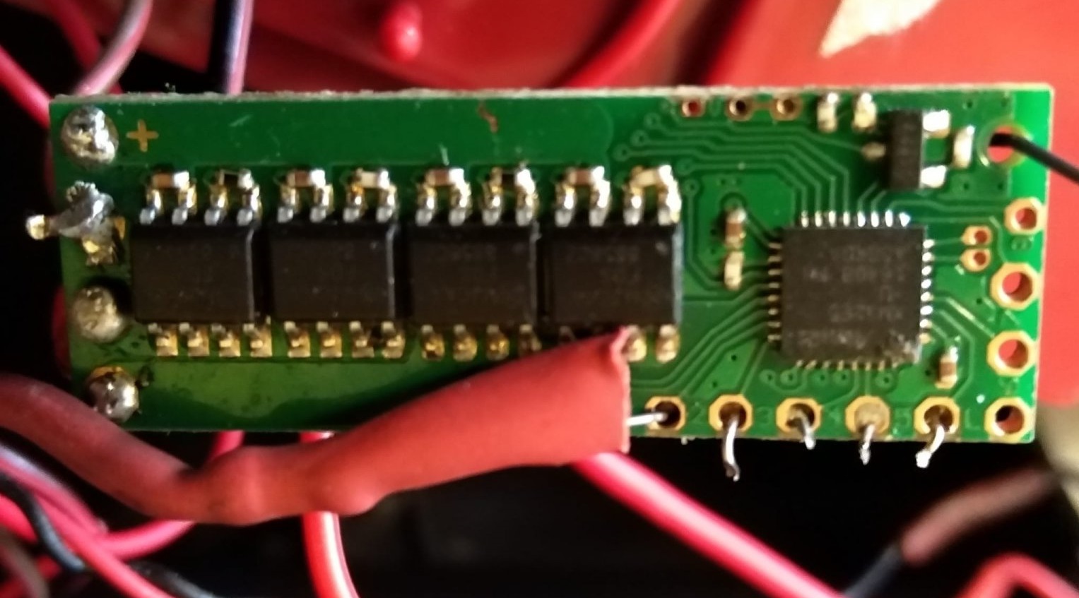

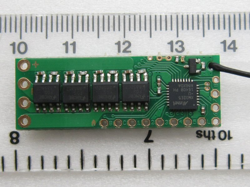

I can not see the port numbers

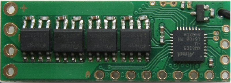

If you look closely at your second photo, you can see the numbers etched beside each pad. Alternatively, it's a bit clearer on this image from the Deltang website
A B C 1 2 3 4 5 L along the base and 6 7 8 up the side

Sorry , I not the best at sorting things out , but you need electrical engineering degree to work this out. I contact port 2 and 3 to turn off LVC , Think it work but as soon as I run the loco it cut out , I am using a 3300 mAh 7 cell = 8.4V, what do I need to do to get it running as it used to, PLEASE HELP
IF you connected ports 2 & 3, then you will have changed from centre-off to low-off throttle. - I doubt you have done this.
You need to connect pins 3 & 4.
Then switch the receiver on..
You should see one flash per second.
If not, turn off and back on again.
When you get one flash per second, turn the receiver off. Remove the link.
You have now turned LVC off, so if you still have a problem, it is something else.

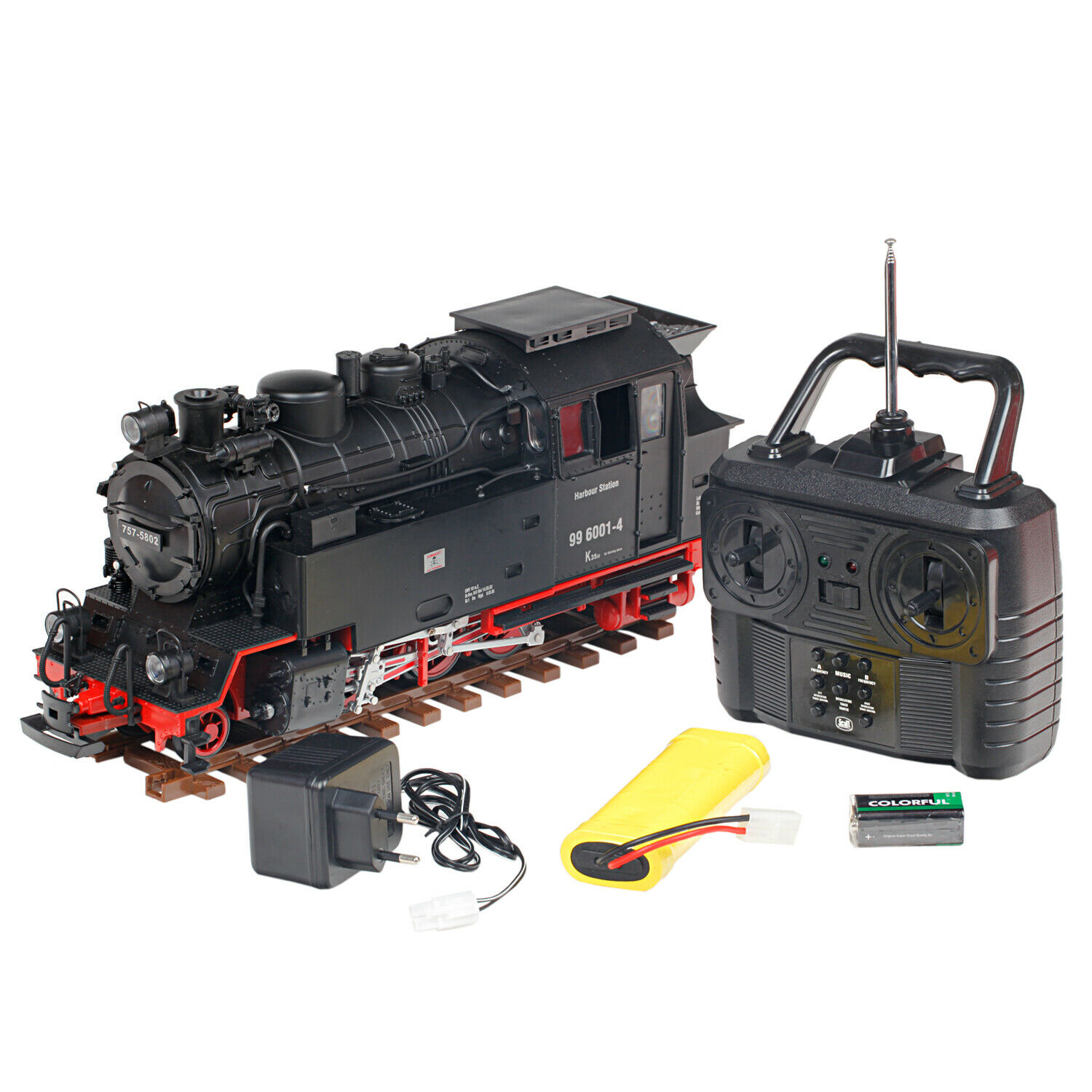

Thank Rik I try to set the LVC when wife come home, This the loco I trying to use Piko it was with its own TX and RX run a 6v , will a small 7.2v or 11.1v lipo burn it out ? just the TX ans RX changed with mylocosound card
