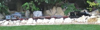

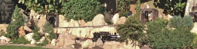

Live stream came to the layout about 9 years after the initial start of the build, and I found that, again, geared locos were the way to go. Excellent performance and great plumes of steam as they toiled up the hill!
The layout does have the appearance of the Rockies and Utah about, it so it does look okay especially with the trains winding around tortuous cliffs etc.
