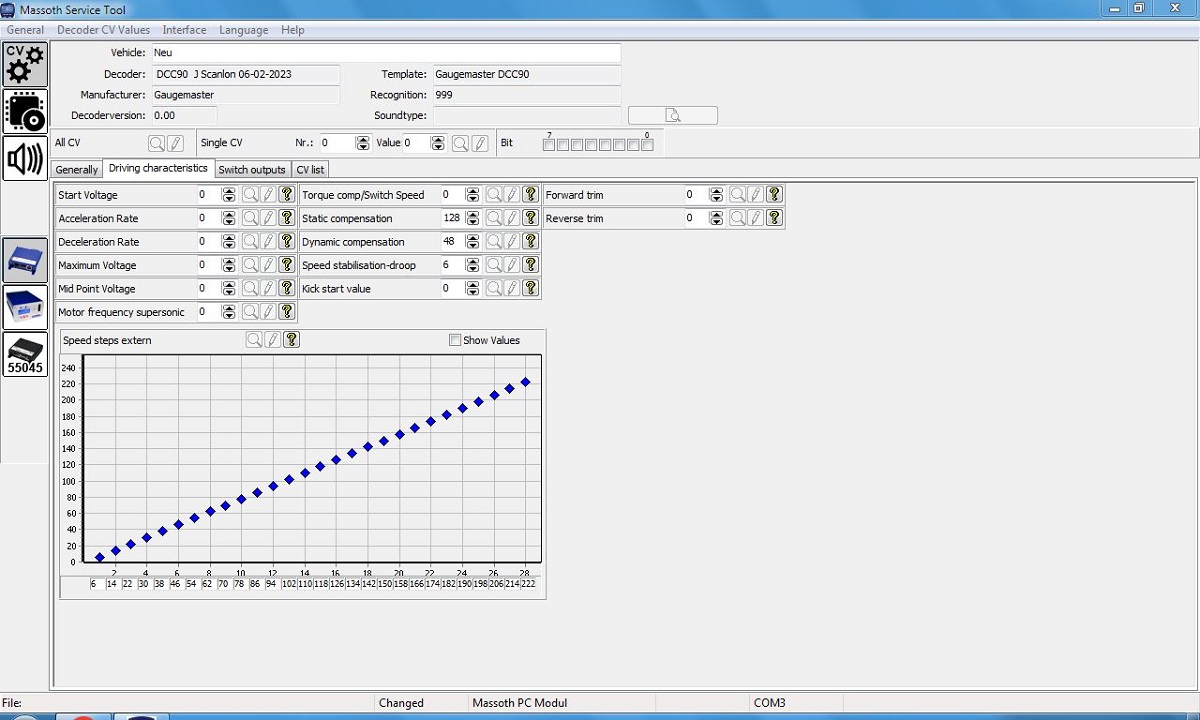

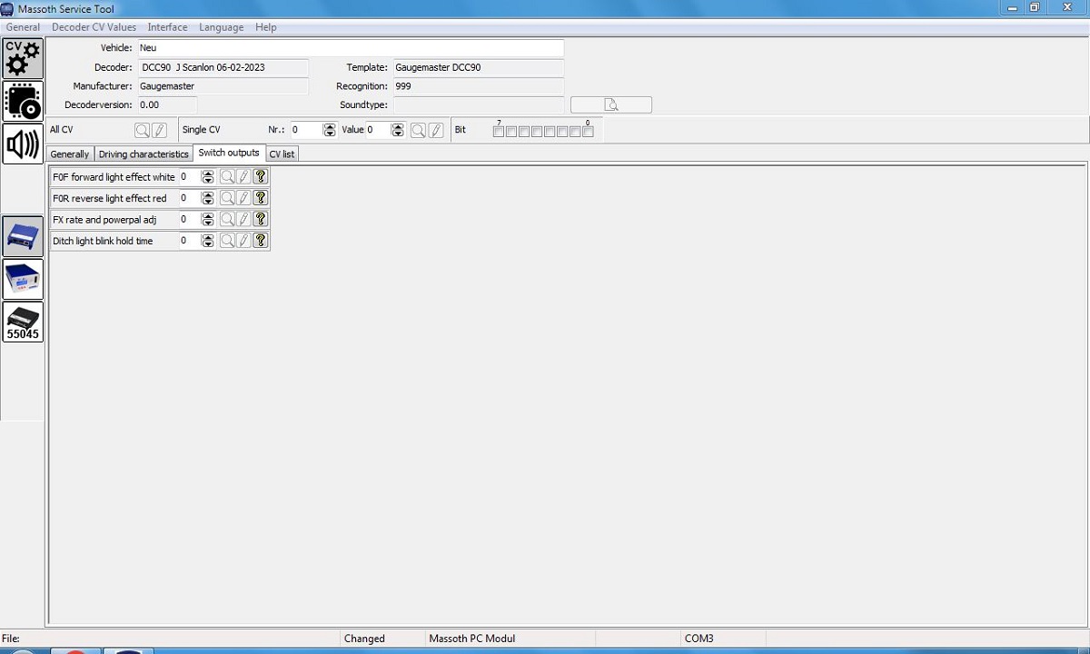

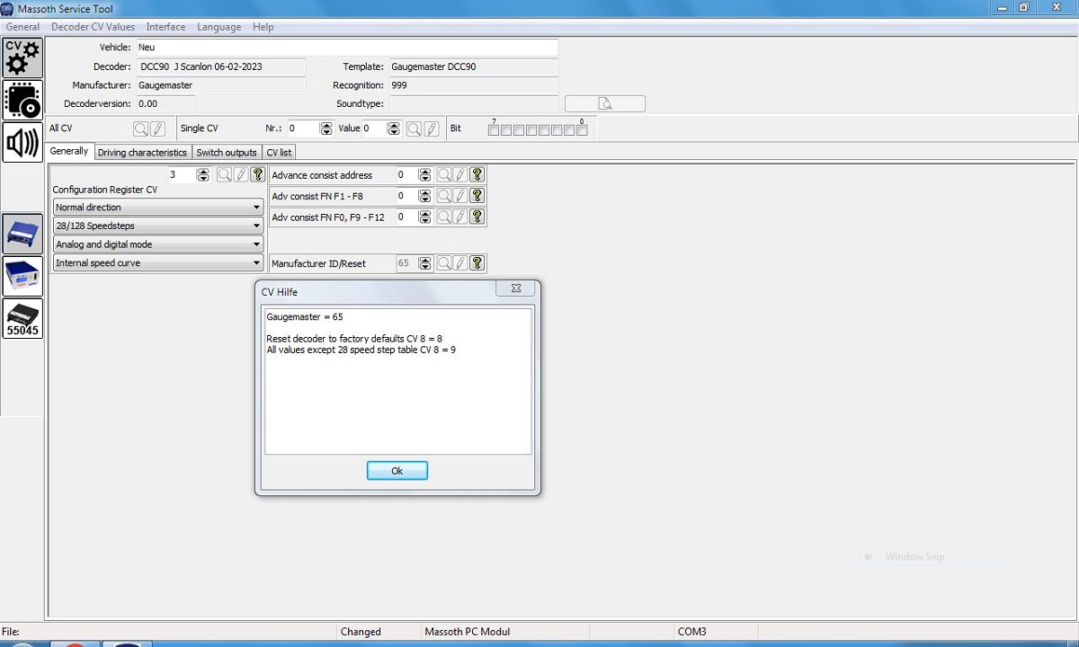

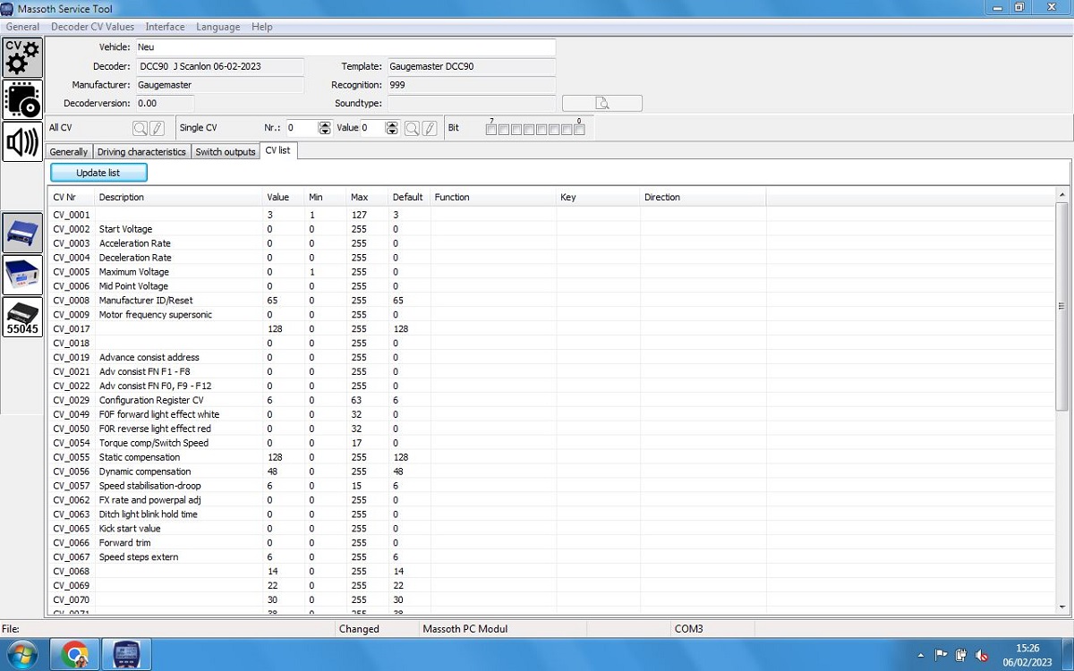

Yes this is critical whish I head read this post prior to using the update template instead of a single CV last night I managed to mess up a Gaugemaster DCC90 Ruby Series 2fn Standard DCC Decoder 8 Pin using MST tool.
Luckily there is a CV that you can reset the DCC90 decoder by changing CV 8 which worked.
I then set each CV in turn and tested.
Phil i wonder if there is a way to create a template for other decoders off their CV setup table might be useful ani ideas ?

HI Mr Shed
Many thanks for the pictures showing decoder and yes that's what I did reset the cv 08 and the decoder was reset many thanks
