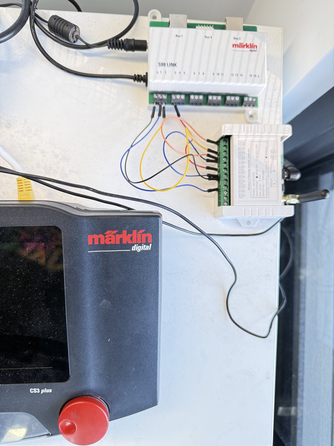

I use LGB con connected a a marklin central station 3, I have a temporary layout setup on my deck. I’ve fitted all my points, signals with single decoders, so I can just plug and play. I’m getting into some automation that involves track sensors. It amazes me that there seems to be no product that is wireless. I’m thinking about the concept of a simple roller door remote, the button wired to a reed switch, the receiver wired to one of sensor imputes on the s88 located inside the house, has anyone tried this? Thoughts?

Can you give a bit more detail are you using the the remote transmitter to send the state of the sensor to the S88 input?
