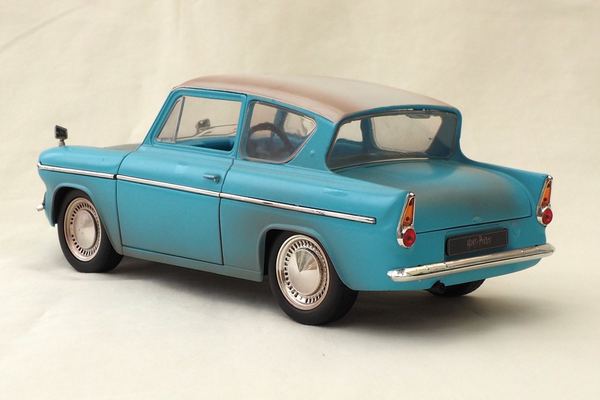

The Harry Potter version appears to be a good model, but spoilt by the toy like application of a brown overspray, intended to represent dirt and weathering, picked up by various exploits in the plot lines of the films. This overspray is applied on a toy assembly line with no modelling artistry involved.

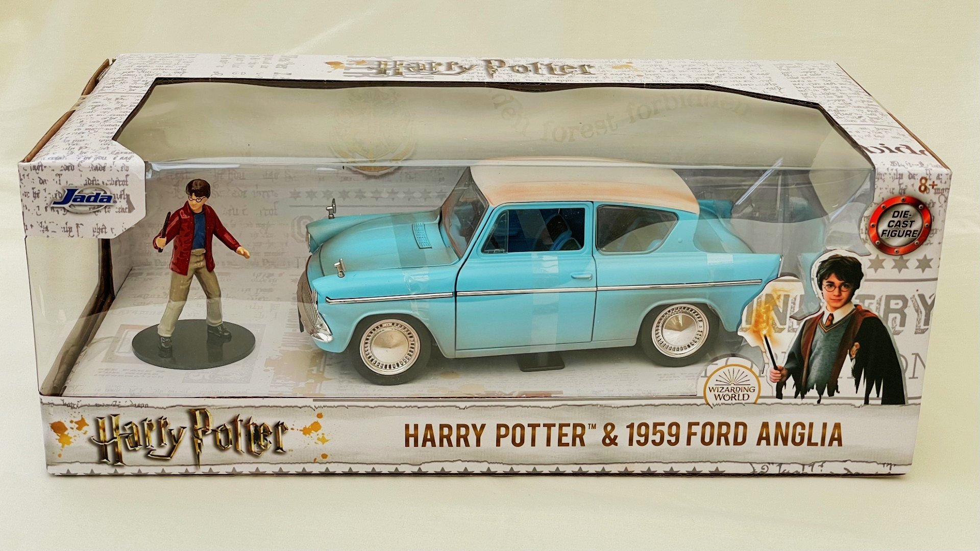

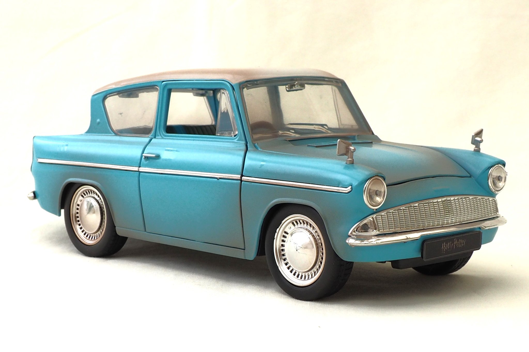

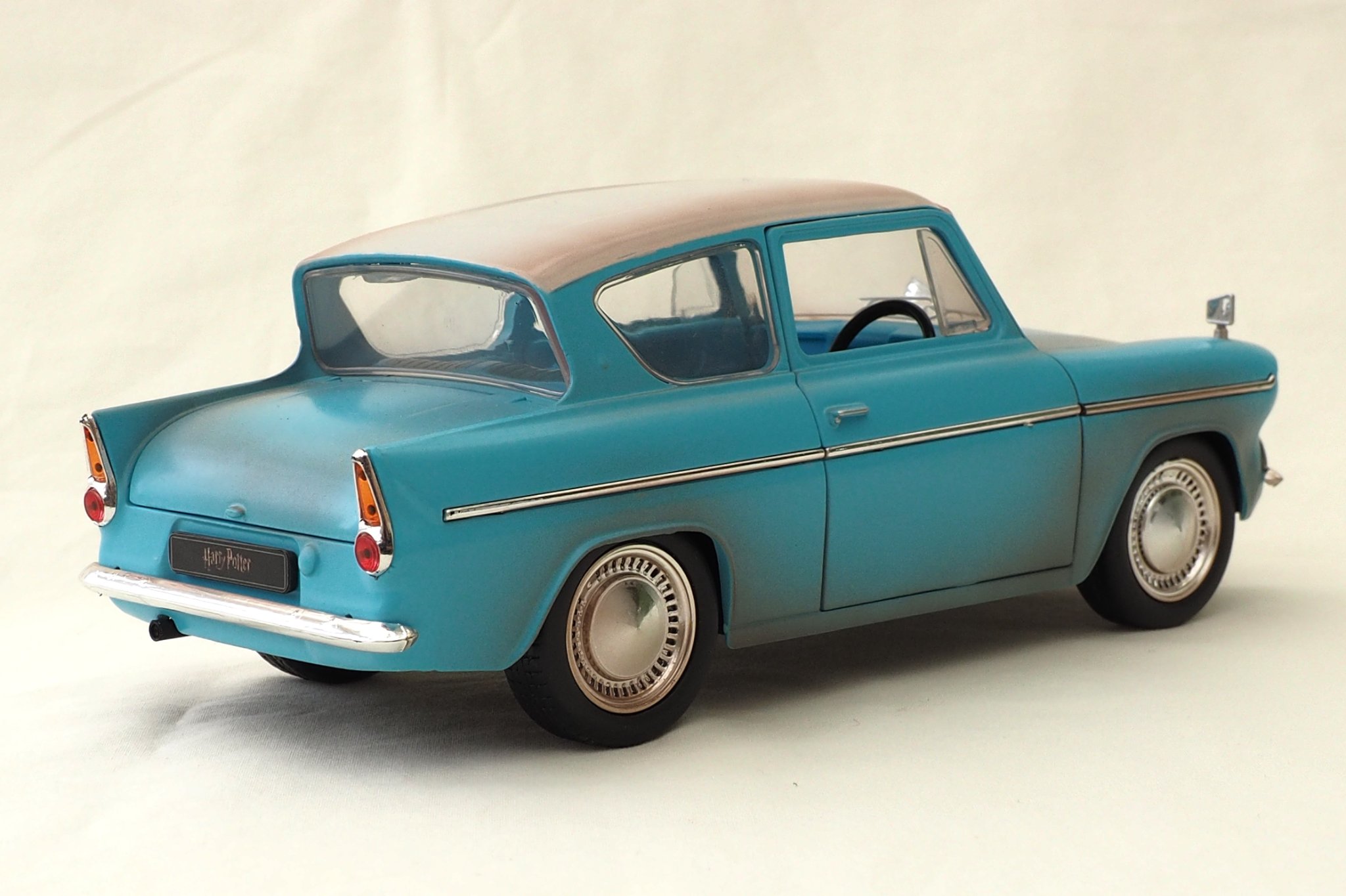

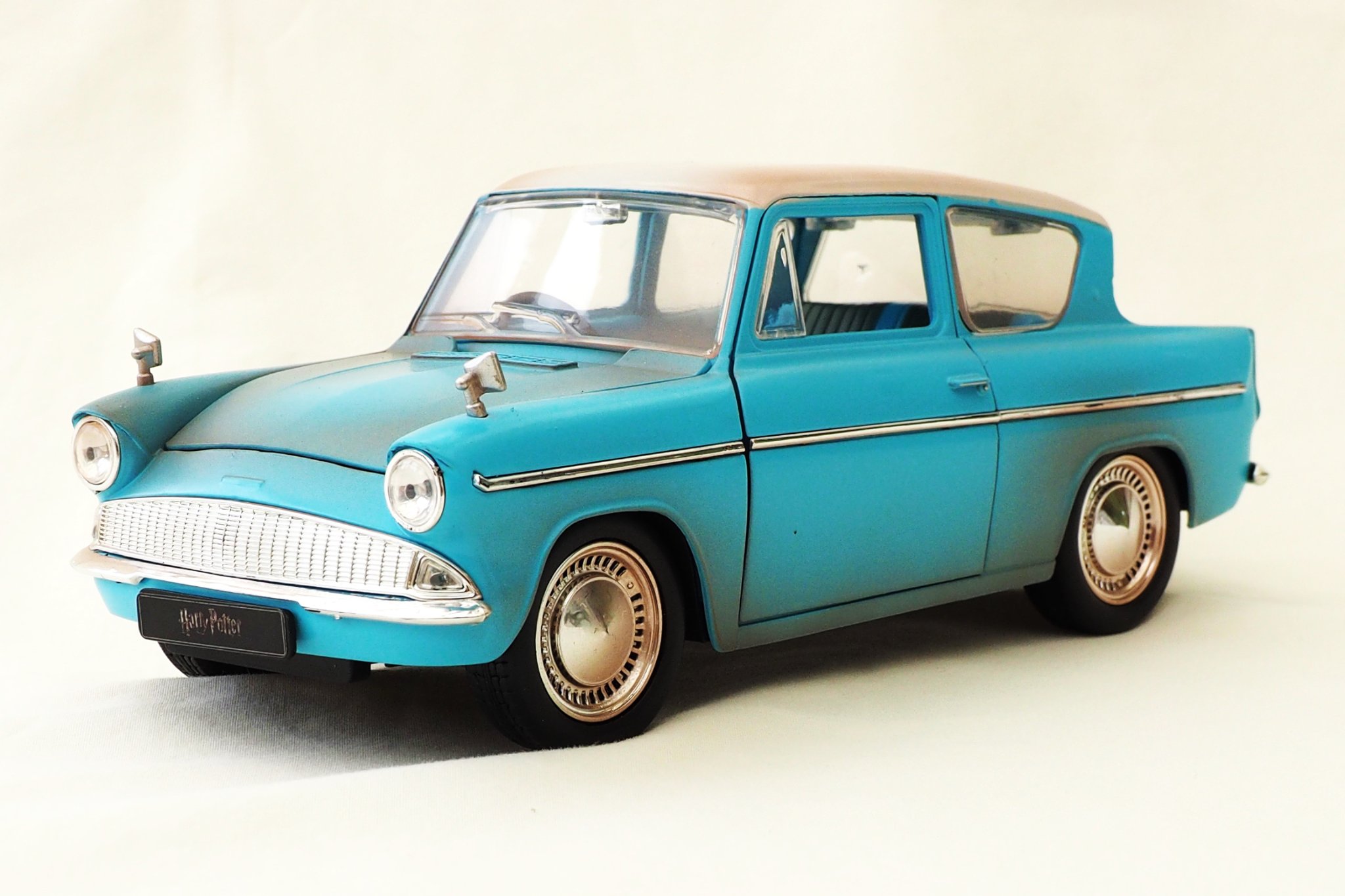

I decided that I would acquire a ‘Harry Potter’ Anglia and attempt to remove the ‘weathering’. My daughter was aware that I was seeking such a model and gifted me one as a Father’s Day present.
The model as received.

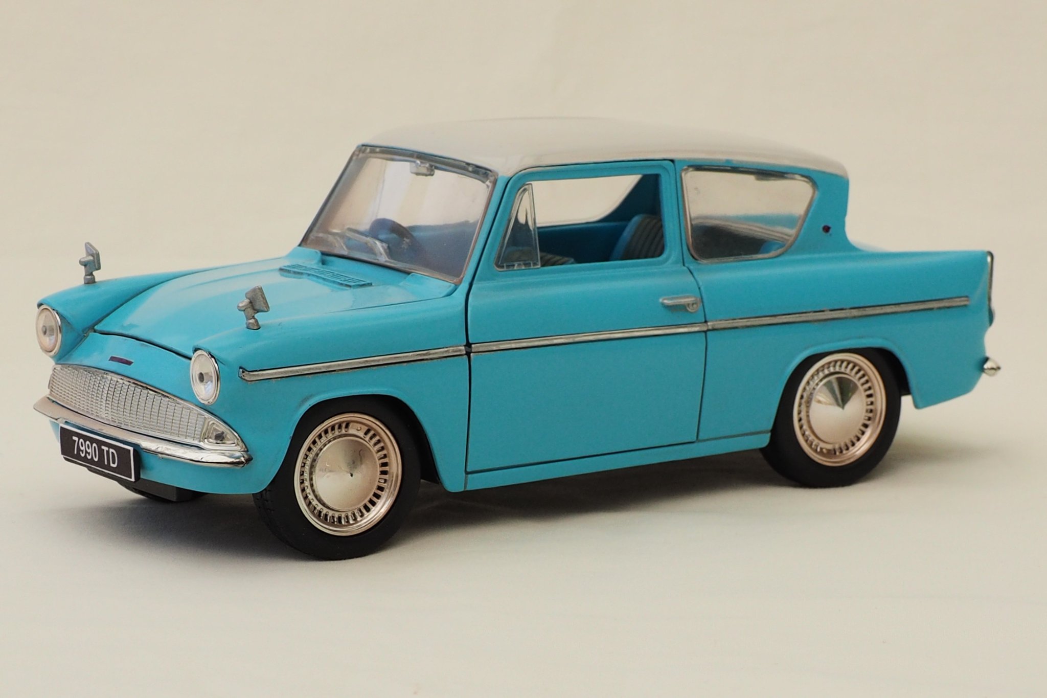

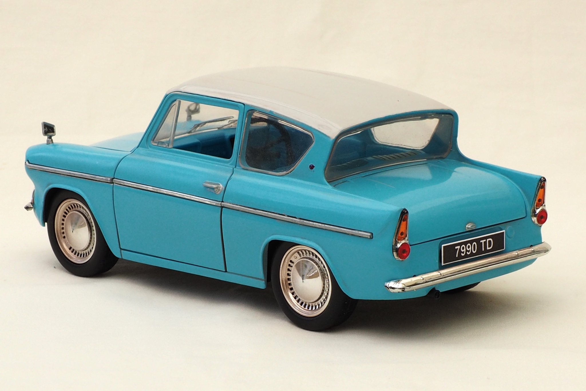

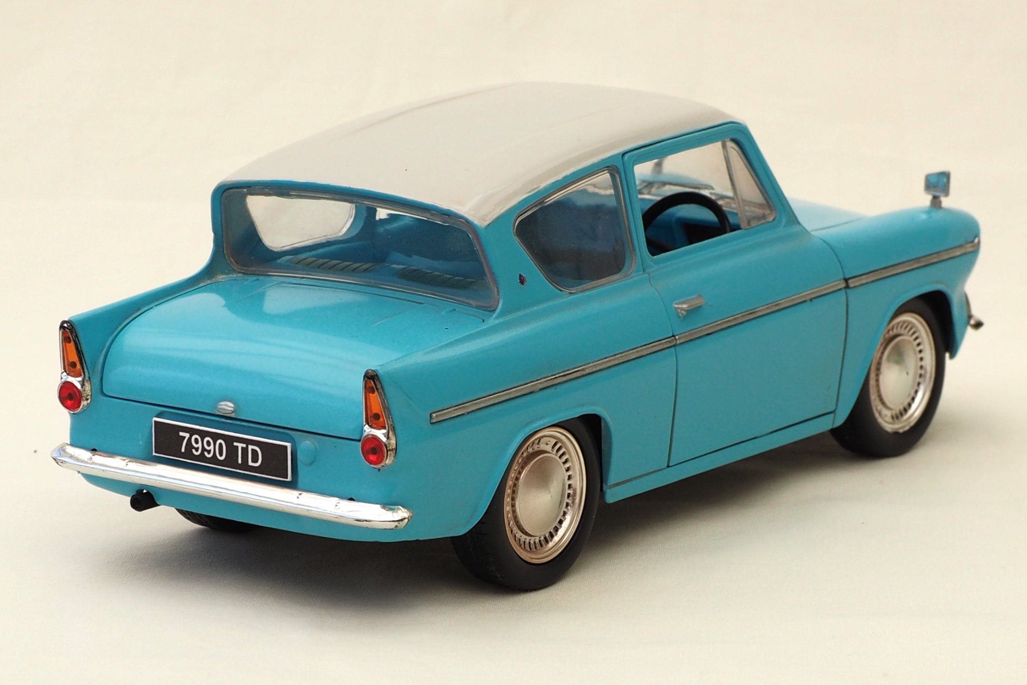

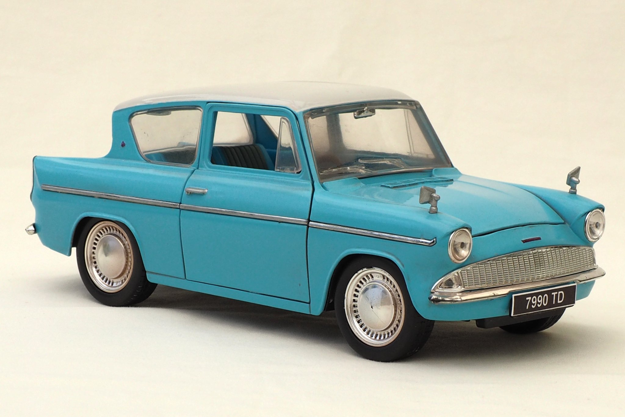

The base coat of paint on the model appeared to be durable and well applied. The brown weathering looked to be just a light overspray. I tentatively gently attacked the weathering with a cotton bud dipped in T-cut automotive colour restorer. The brown paint came off with a minimal amount of rubbing and with no damage to the original paint surface of the model. As a result, the whole model was cleaned off with T-cut.
The chrome trim on the sides of the car suffered slightly in the process, so these were masked up and silver plate paint applied by brush. I also painted the door handles, boot handle and windscreen wipers in silver. The name badges on the front of the car and on the sides, to the rear of the windows, were picked out in maroon. The last job was to print some card number plates on the computer and glue them on. The number plates match those of the car in the Harry Potter films, so there is some continuity.
I am pleased with the result and now have a superb little model of a car appropriate to the period that I am loosely modelling.
The re-worked model 1959 Ford Anglia.

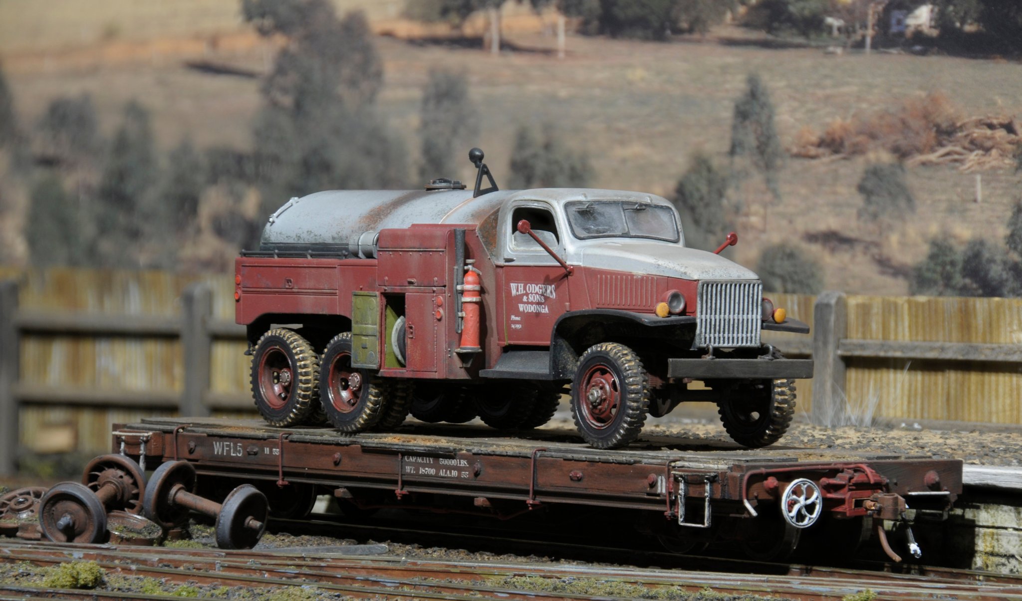

I like my vehicles weathered - have a few 1:48 vehicles yet to do like this fuel truck:
