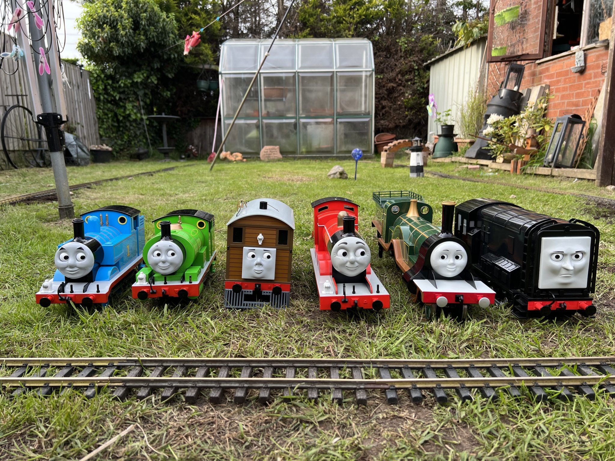

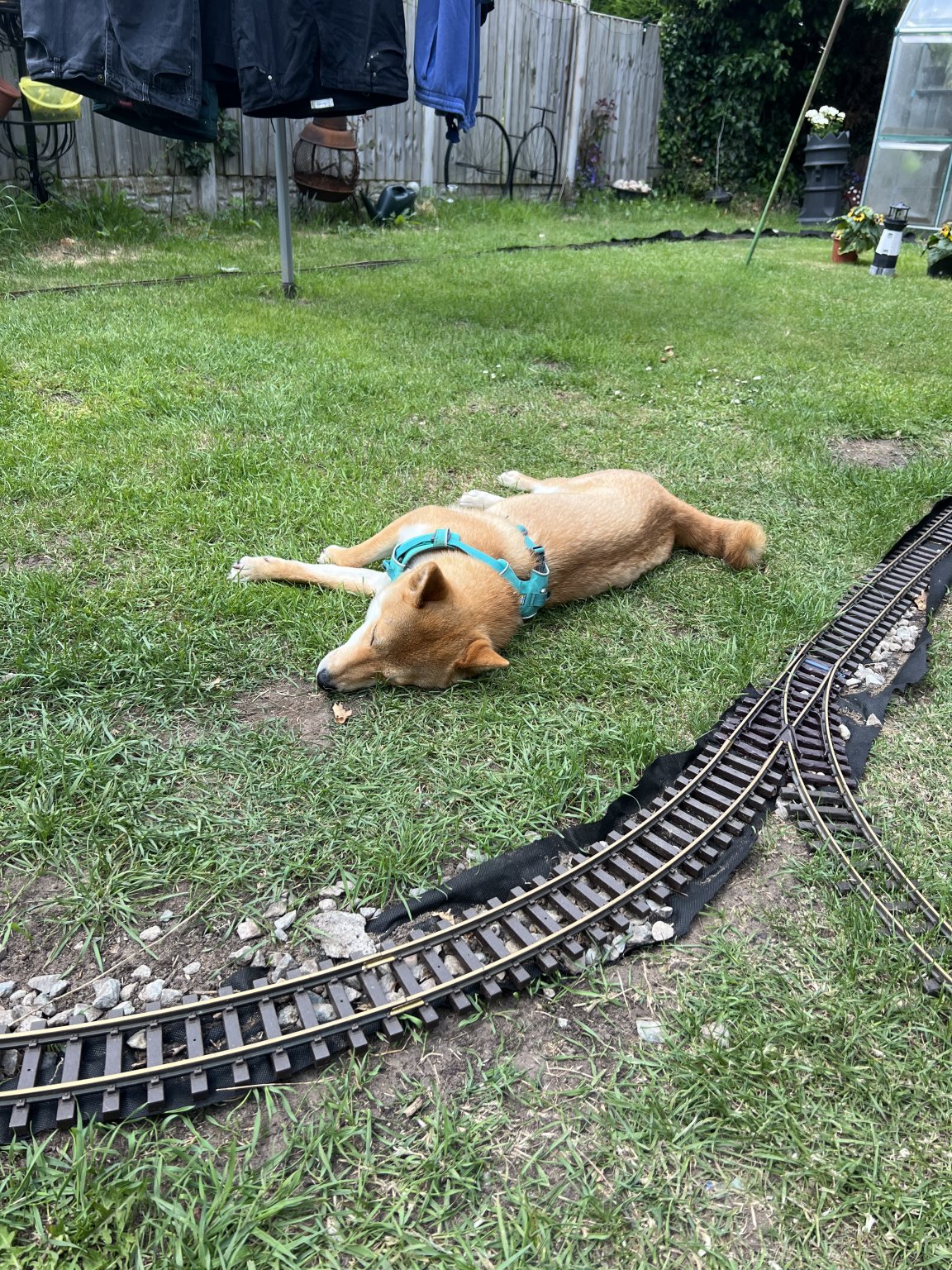

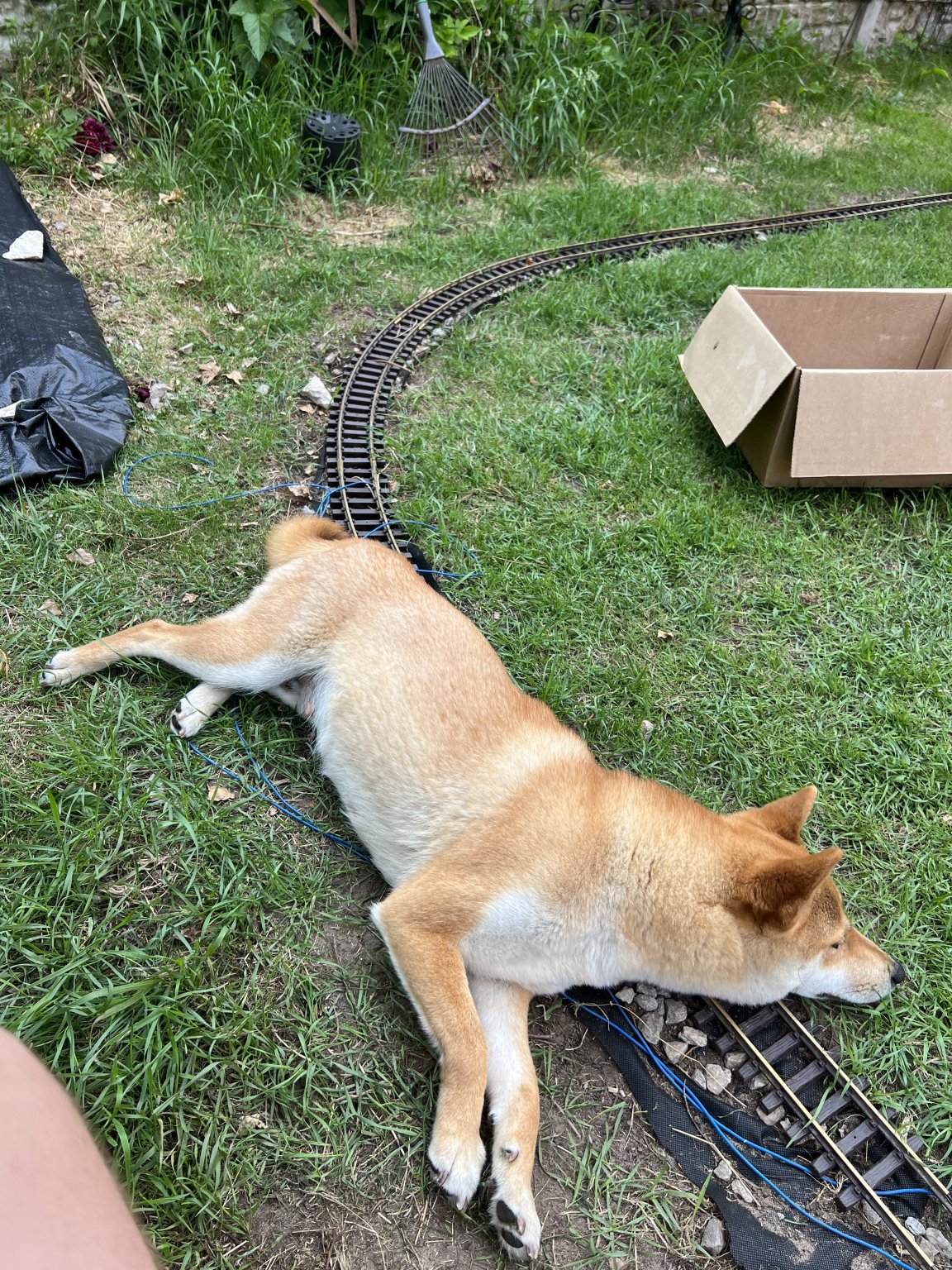

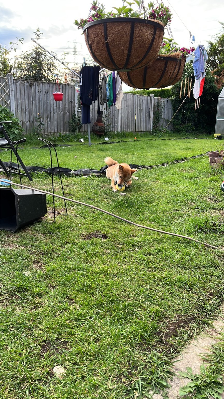

(Telford) Hello, I’m a new G scale modeller, I own Thomas & Friends G scale stuff, I wanna start building my garden railway, I have the track but I’m struggling with what the best would be to buy for ballast under the track, my close friend was chatting to me about it but he has sadly passed away so I can’t ask him for help, he suggested digging 3mm under the soil then filling self binding grit and a foundation geit sprinkled on top but I cant find any of that in the UK, below are photos attached of my garden, thank you so much!

Your biggest problem is going to be your four-legged friend..
You will probably have to 'bond' your ballast, with something like SBR. - Else a boisterous doggy, may well disturb your track formation?
