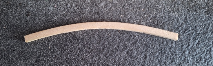

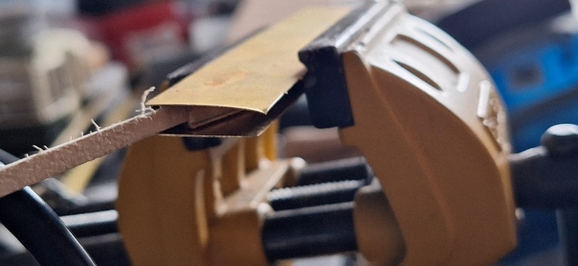

Well here's mk1, wife was distracted so I managed to get the use of the kettle.
The wood went in to the boiling kettle, once pliable I sandwiched it between the two formers made earlier it works.
Even if it forms the wood to an even curve it'll be a success, just slow going with only one former.

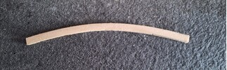

As a first attempt I am calling this a success in shaping the wood to a curve, and a failure in my ability to have patience and let it dry before taking said piece of wood out of the formers, hence the flat section.
