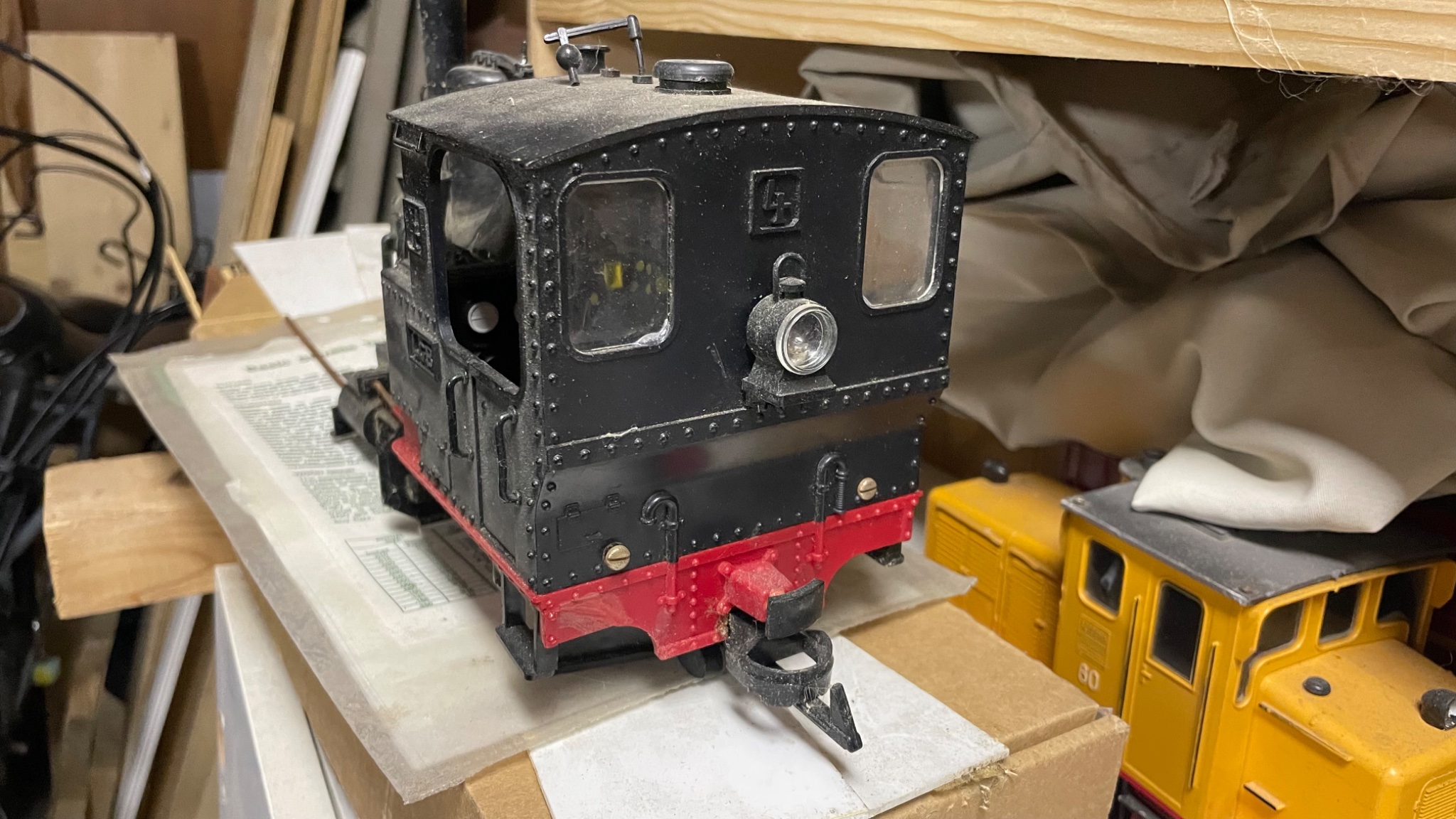

The only Stainz I own is so old it doesn't have an auxiliary socket :D

I don't think I'll convert the old Stainz, just because of it's age and pretty good condition.

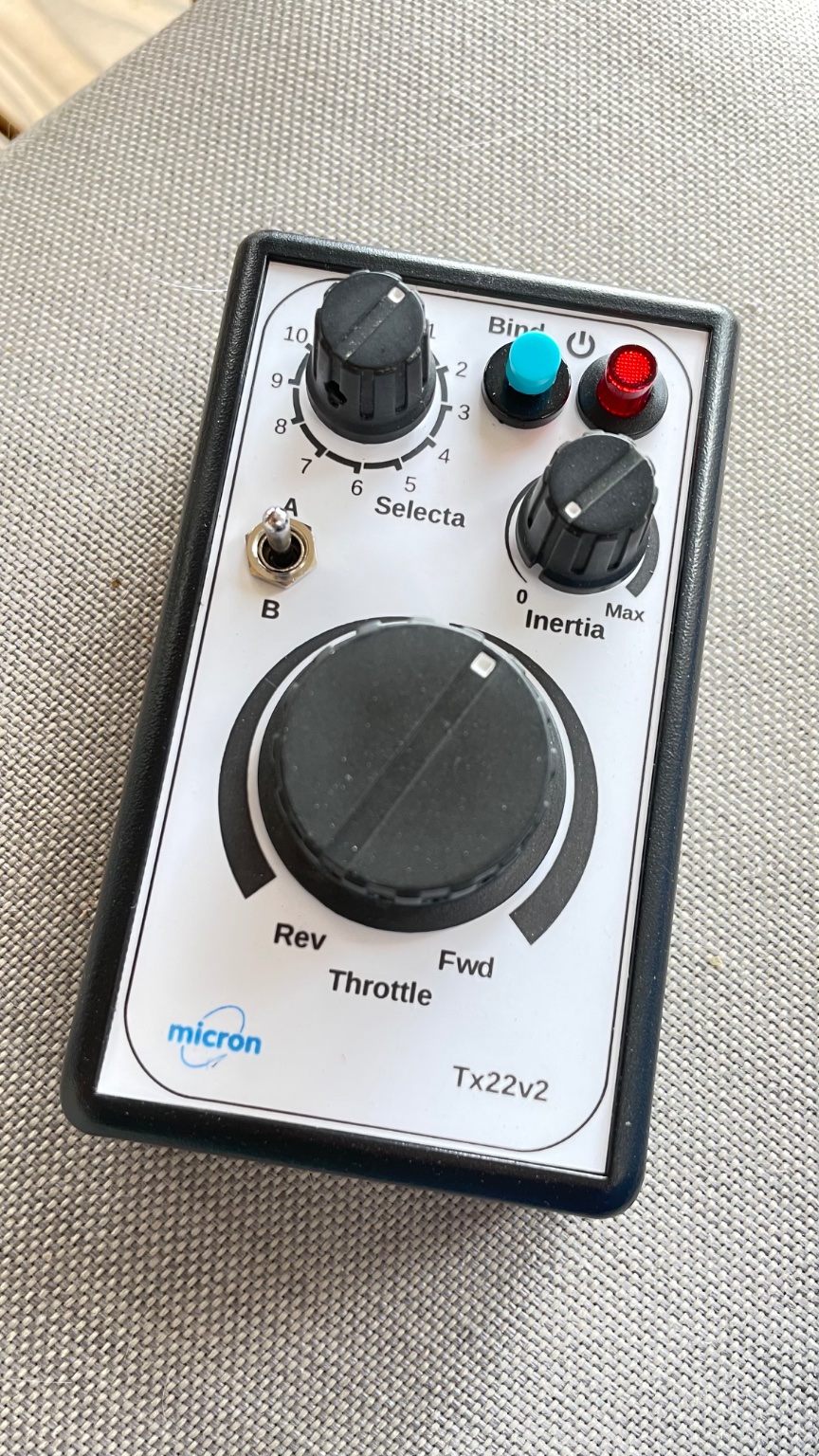

I thought I saw somewhere that you had some Fosworks or perhaps it was someone else. Look at some of the Handsets, the ones with the selecta button in the left can control up to 10 different locomotives.
Post 1, paragraph 1, states Micron-based kit..
The MR603b does not have shuttle functionality, but the later receivers do..
Someone :blush: can even supply a kit, with this enabled, and reed switches wired to plug into the receiver.. - Can also be switched off, for manual radio control.
This Tx22v2 can control up to 12.

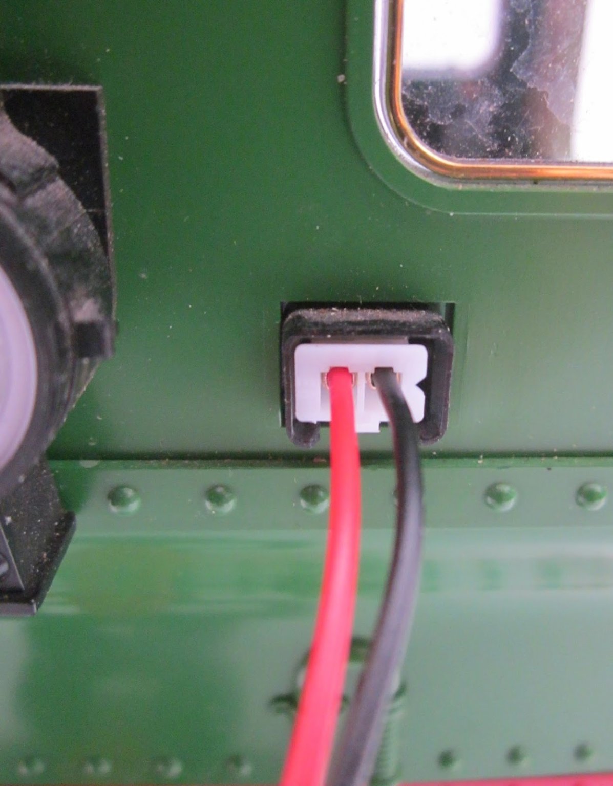

You'll need a polyswitch fuse in the circuit, as shown on ge_rik ge_rik 's installation page (to protect the battery from shorting) but not on the two wires that feed the loco.

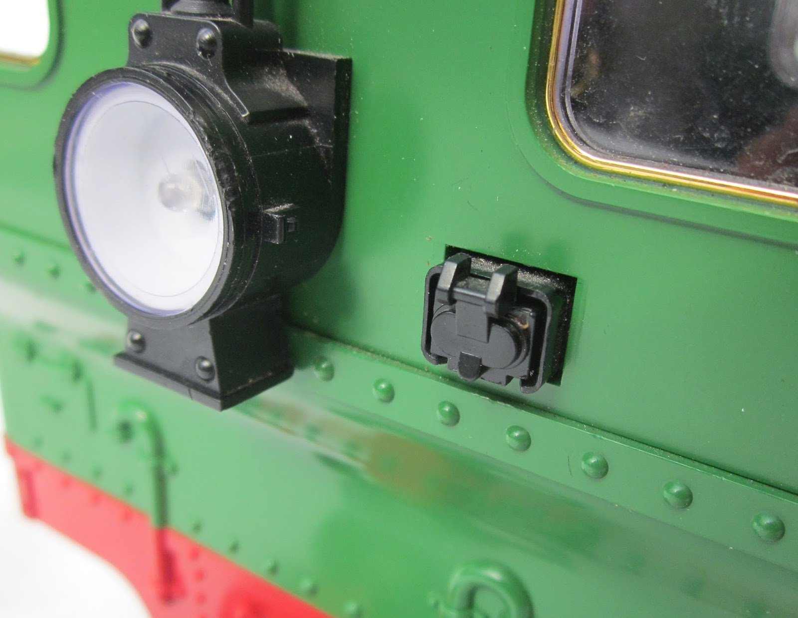

Are you sure your Stainz doesn't have a socket, Henri? They are disguised.
Rik
None of mine did, I installed them myself.
Thanks. I hadn't realised the early Stainzes were so different.
Rik
