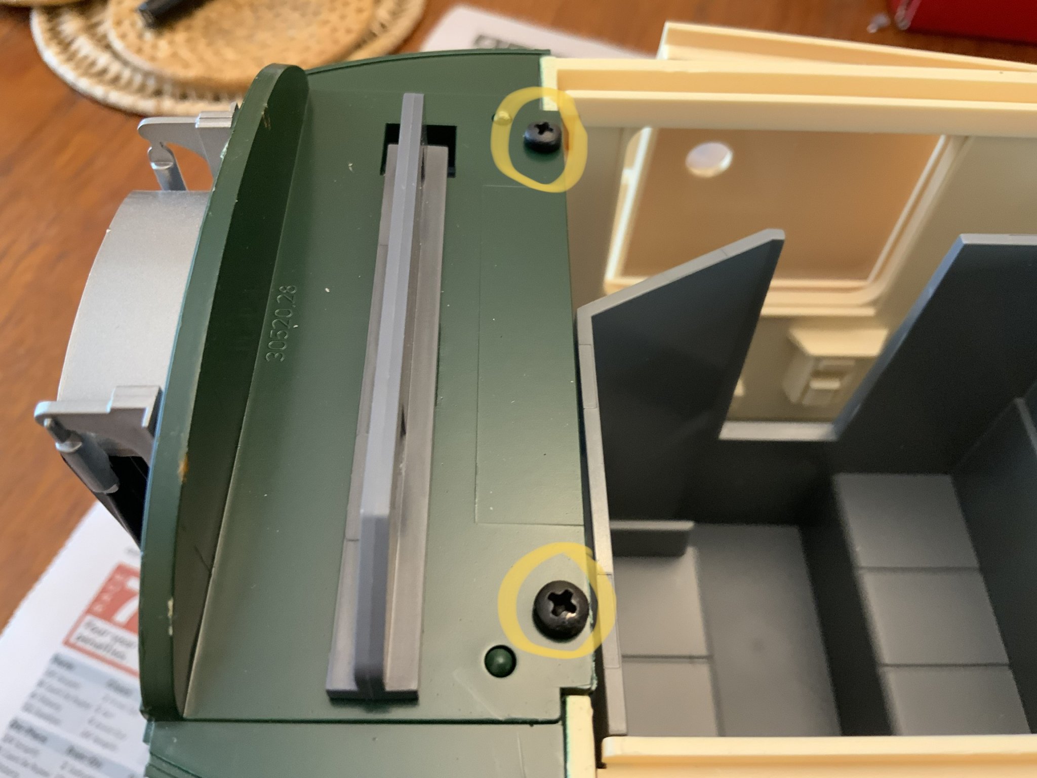

During all the handling of the coach while figuring out what to do with the roof I managed to dislodge the "window glass" in one vestibule, so that needed to be remediated. There are two screws at the top and another two underneath the car which secure the vestibule to the rest of the carbody. When these screws are removed the vestibule slides off the carbody, and it was an easy task to secure the "window glass" panel with a few drops of PVA adhesive.
