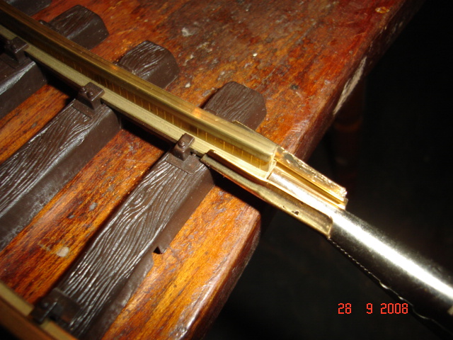

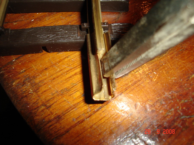

Take some needle nose pliers and open the joiner so the crimped part is at 90 degree angle to the bottom of the fish plate and the rail is exposed. Hang the part of point with the joiner off the edge of table. Then take the pliers and grab the front of the opened fish plate and pull down. The embedded tab in the sleeper will slide out under the rail and the joiner is removed. If force is applied incorrectly you can damage the little plastic clips that hold the rail to the ties (by lifting the rail up with pulling down). With some practice you will figure out how to avoid this by putting downward pressure with your hand on the top of the rail when pulling down
I should note this will destroy the fish plate joiner
You can just slightly open the joiner with pliers or small flat screwdriver, then slide the rail back out of the sleepers and joiner, then just pull the joiner out. Nothing destroyed.

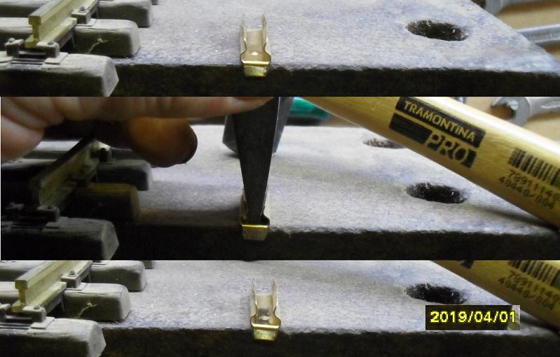

Many suggestions posted in here both now and in the past tend to trash the LGB fishplates. This one does not, but don't do it on the living room carpet?

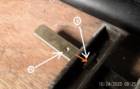

drilling out the dimple
for what? if you refer to ( A ), it is not necessary. the moment one widens the fishplate, the dimple is free floating.
(only if you want to re-use the fishplate the dimple must go. (second pic)
if you want to do something about the rectangular prolongation of the fishplate ( B ), with a screwdriver and a small hammer one can beat it into a 45° angle (direction as the orange arrow). that would save one or two "wiggles".
