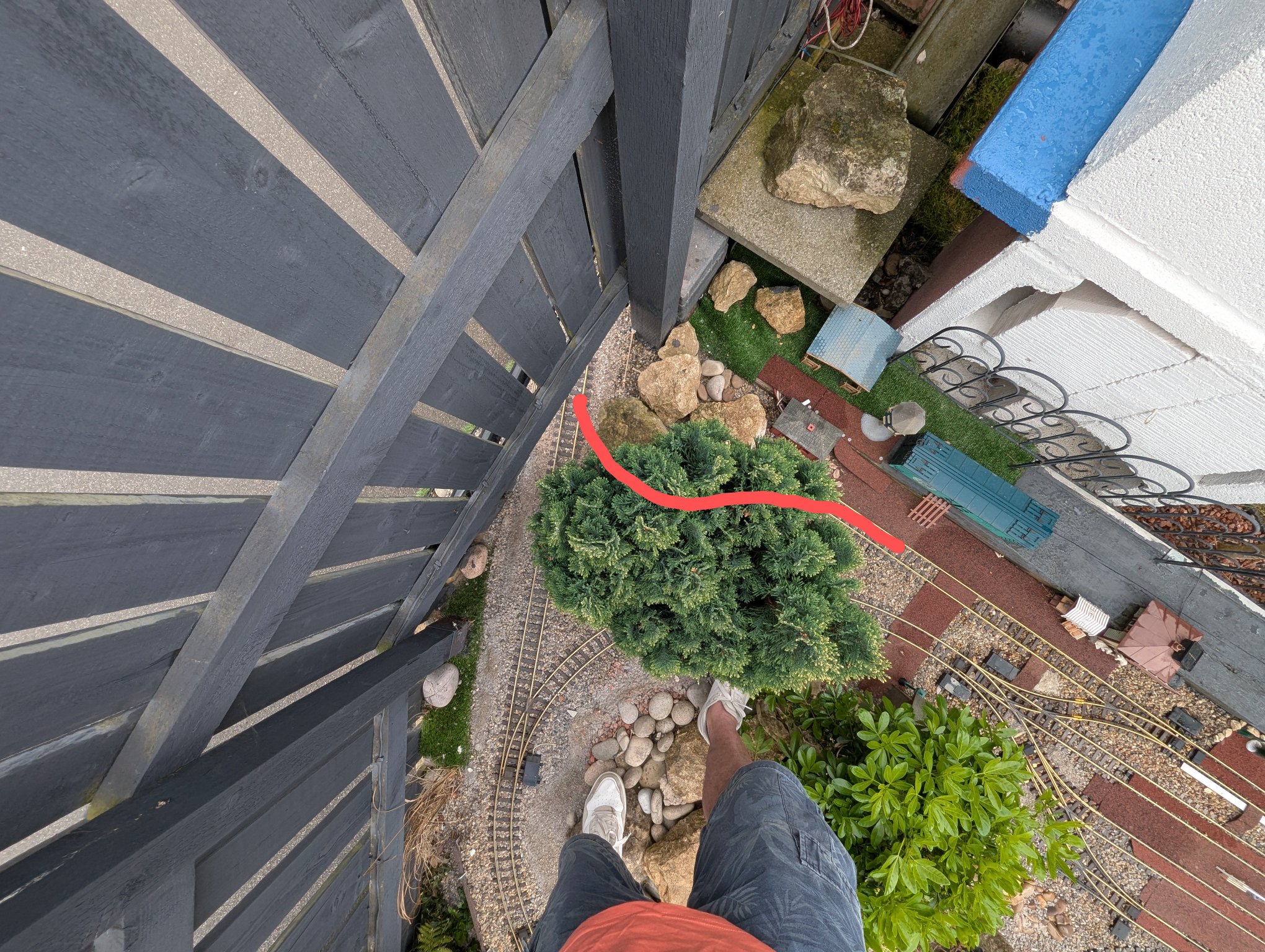

Has anyone any experience or pictures of R0 track alongside standard R1 of the LGB variety? Toying with an Idea for my Field Stock, but would like to see it before ordering from Heyn, or using Flexible Track to gain the curve.....

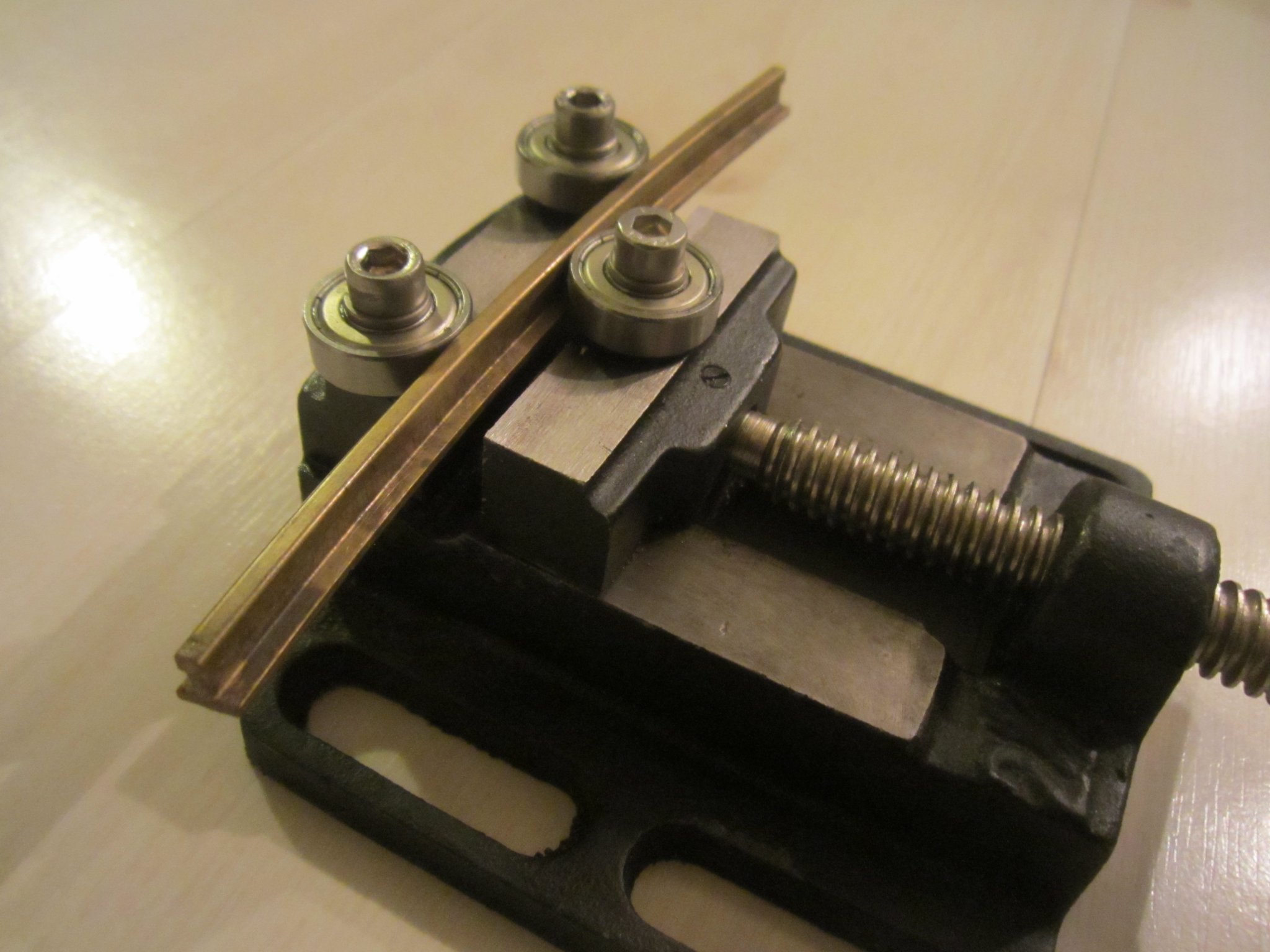

the Massoth rail bender is too expensive and not worth the effort for a few pieces, so i built this tool to go from the R2 LGB curve to the TrainLine 90cm radius curve, using ball bearings. It's not perfect, but when you put the rails in the sleepers, I'd say it's ok for short stretches
