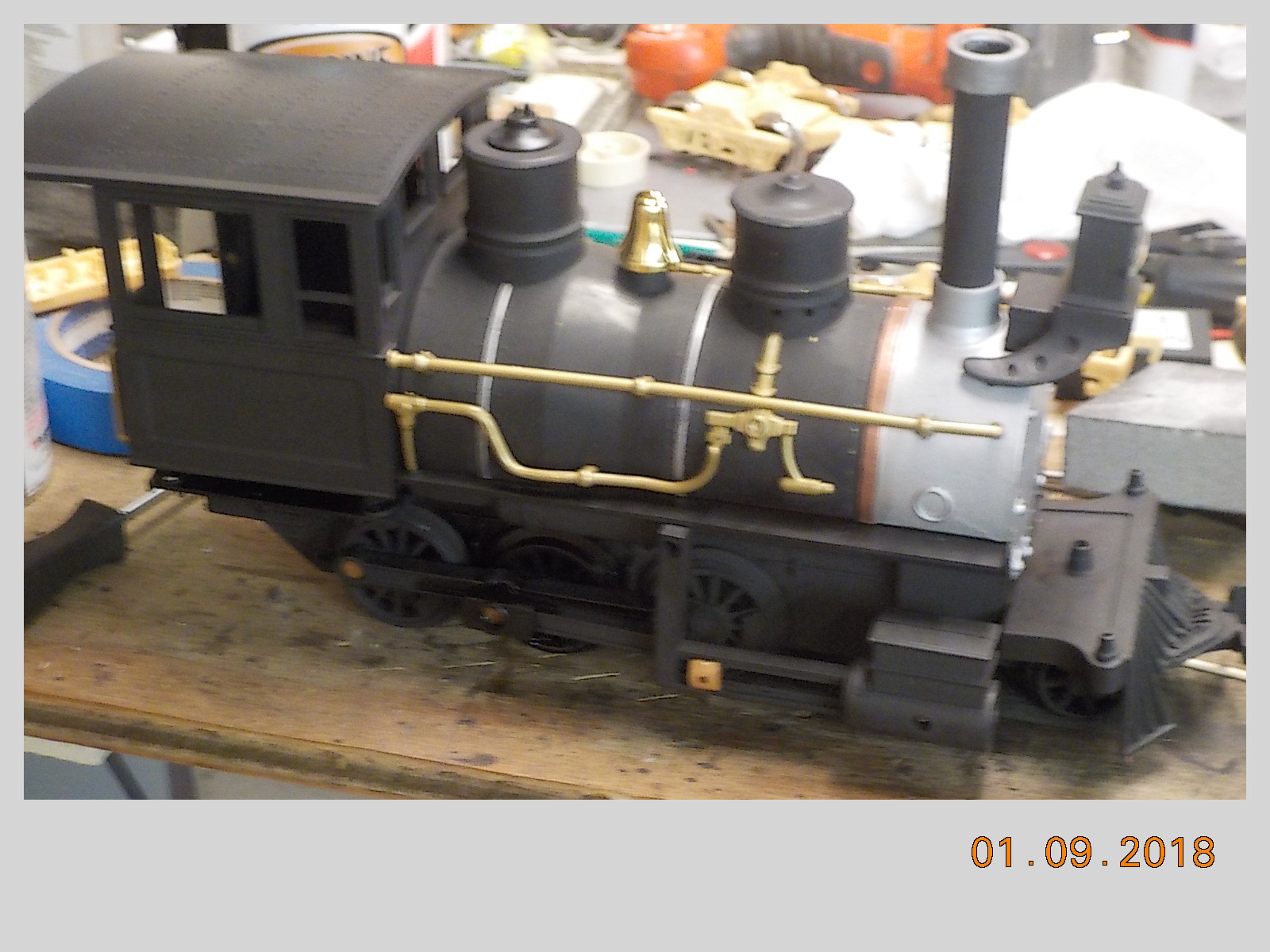

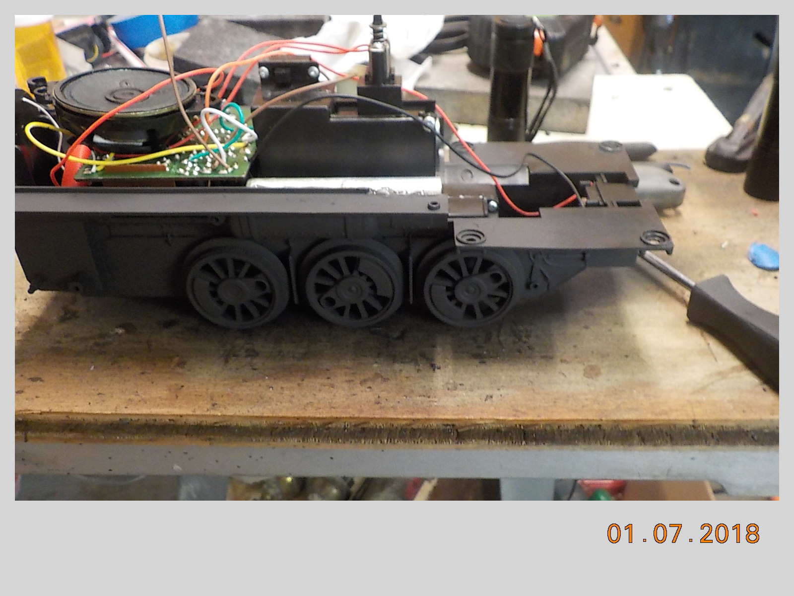

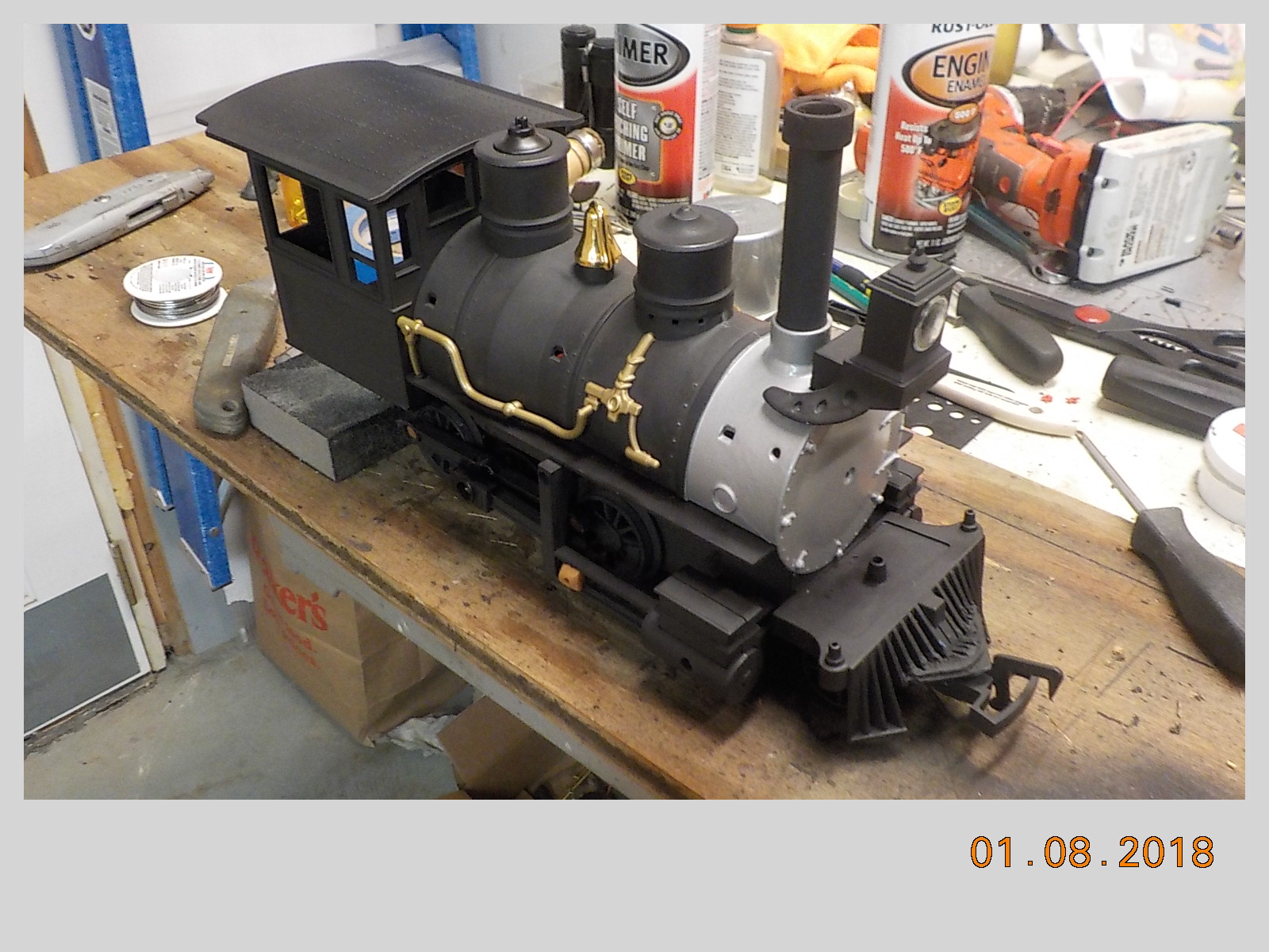

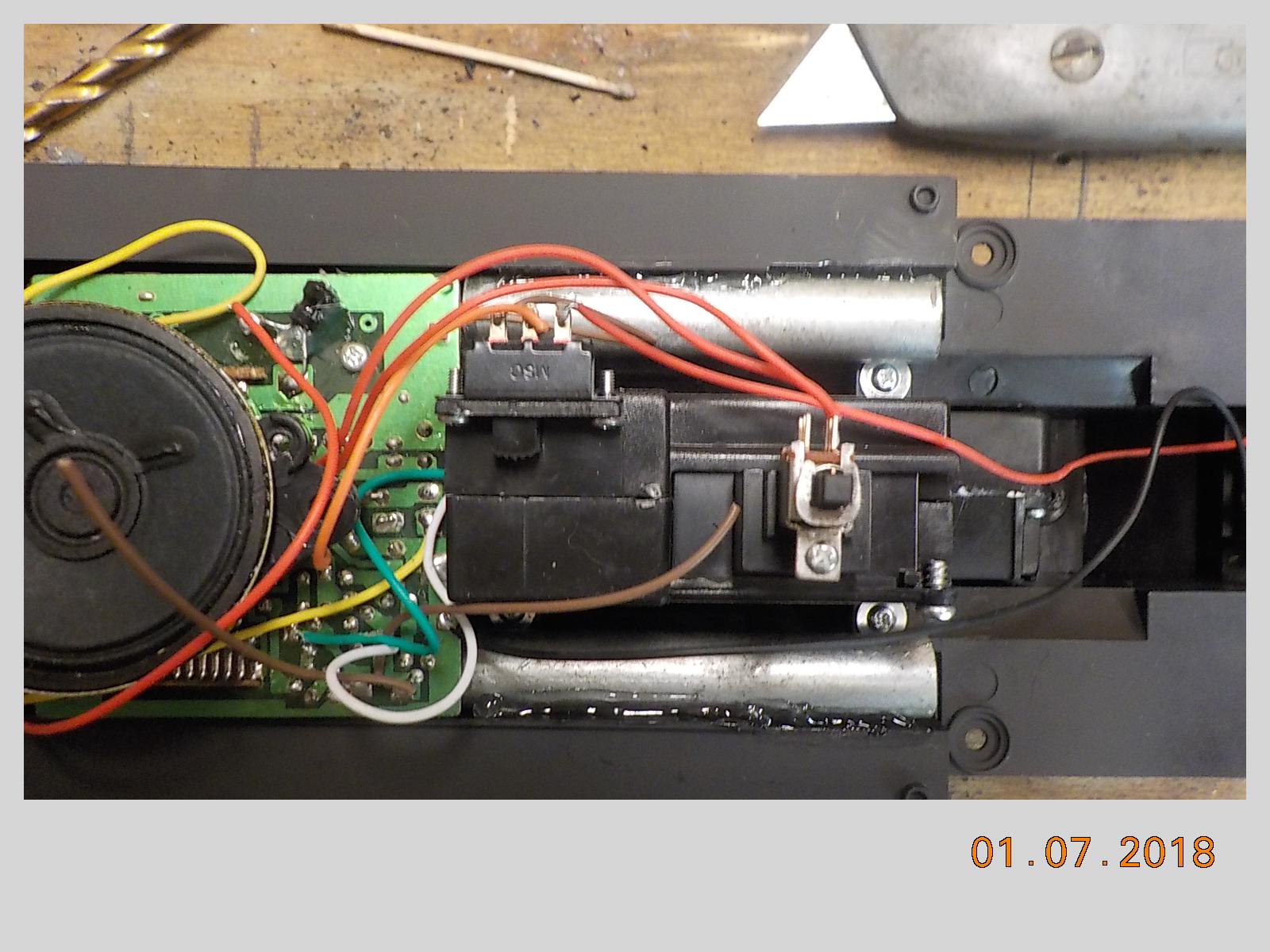

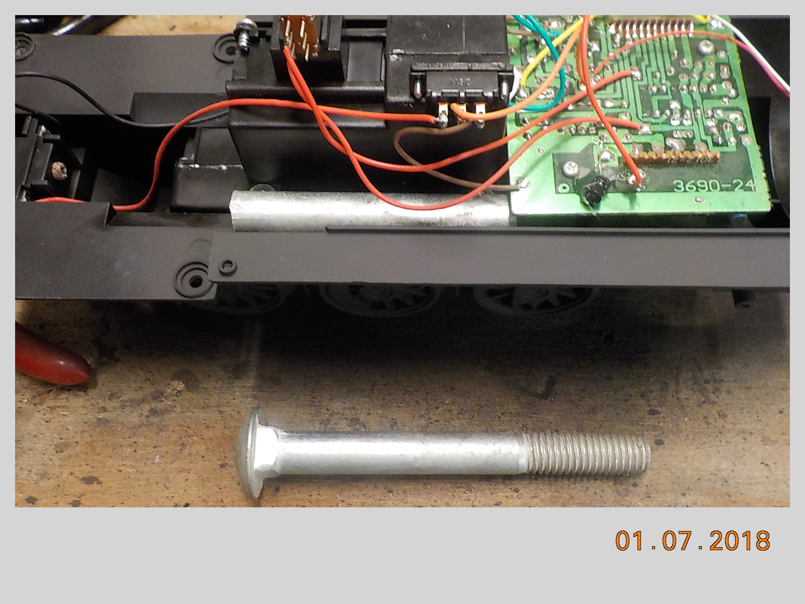

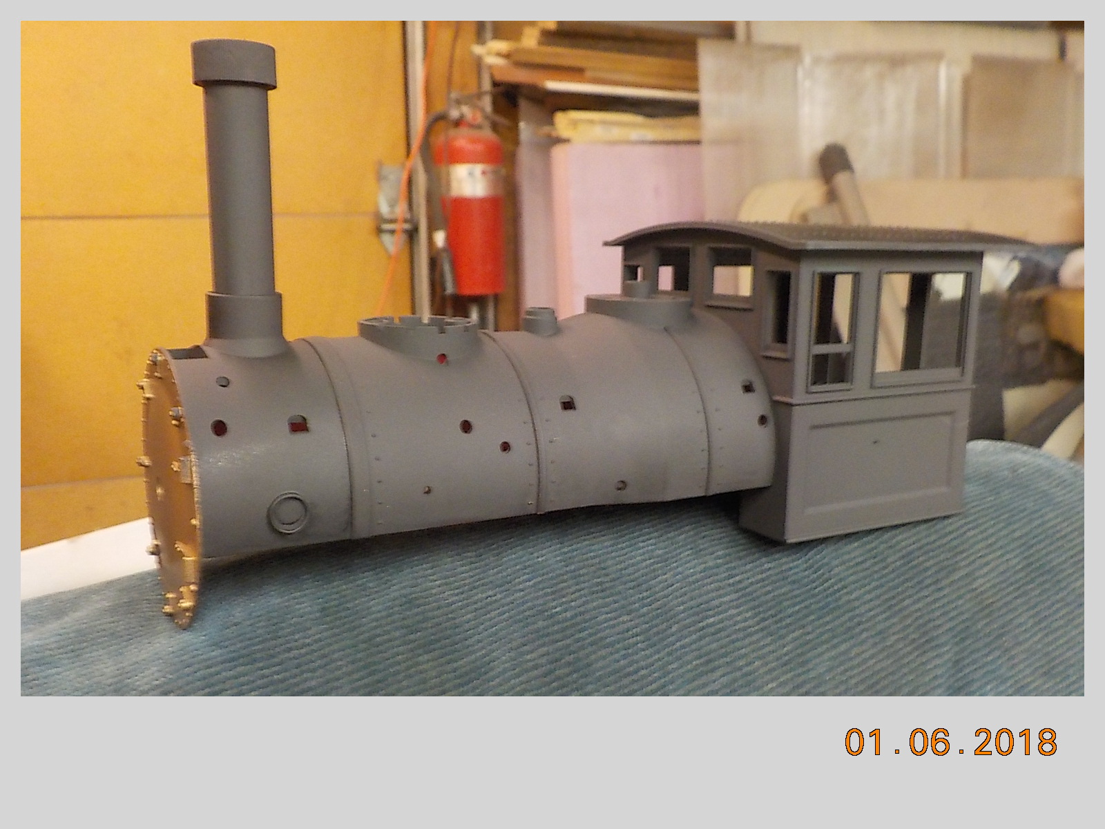

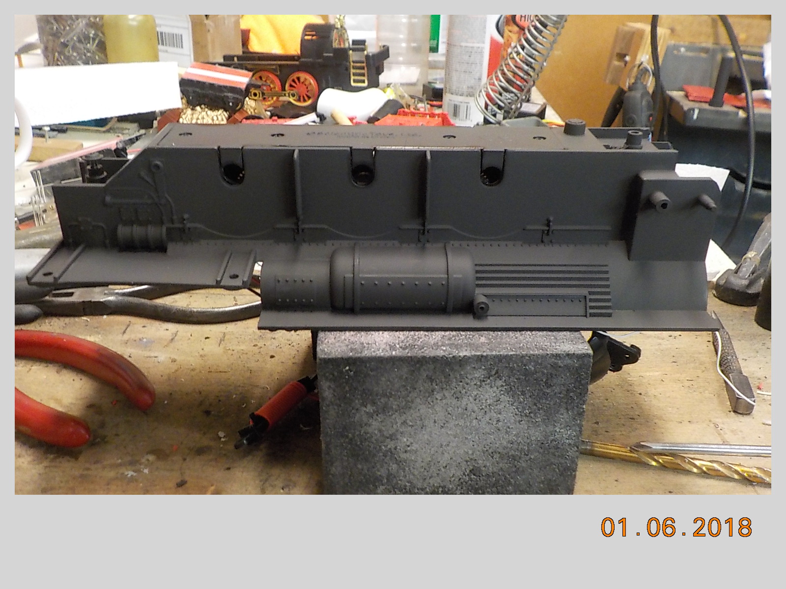

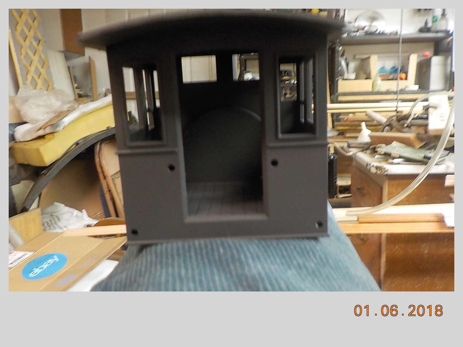

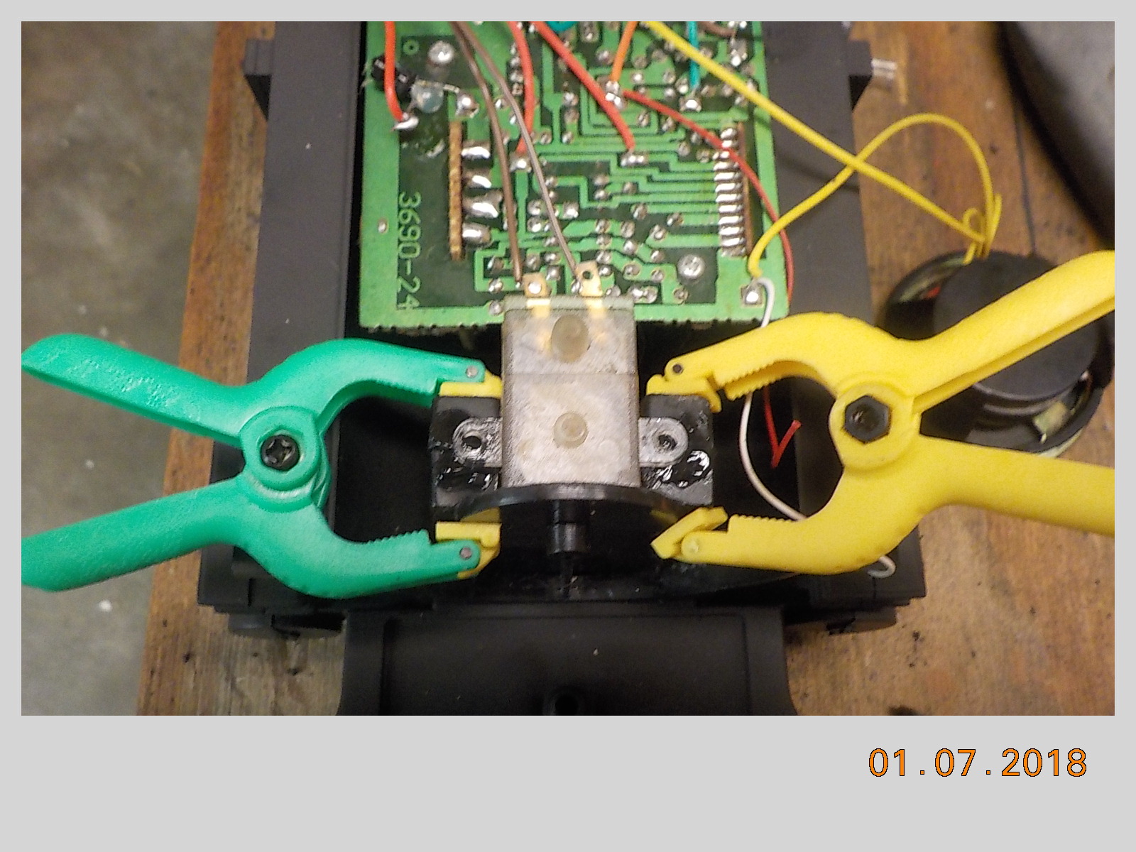

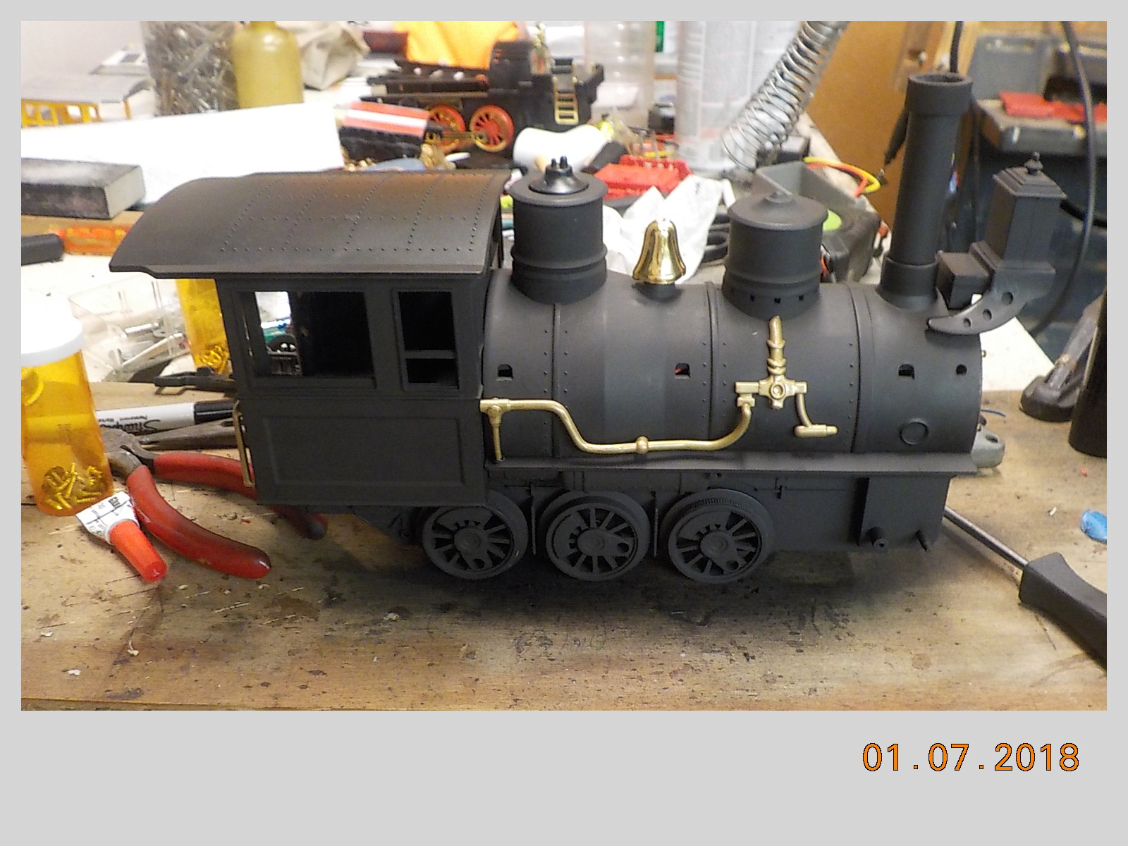

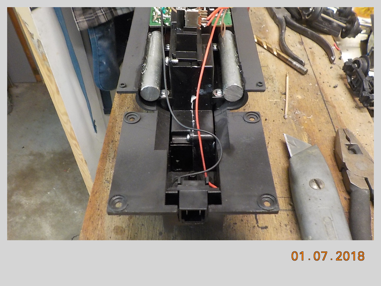

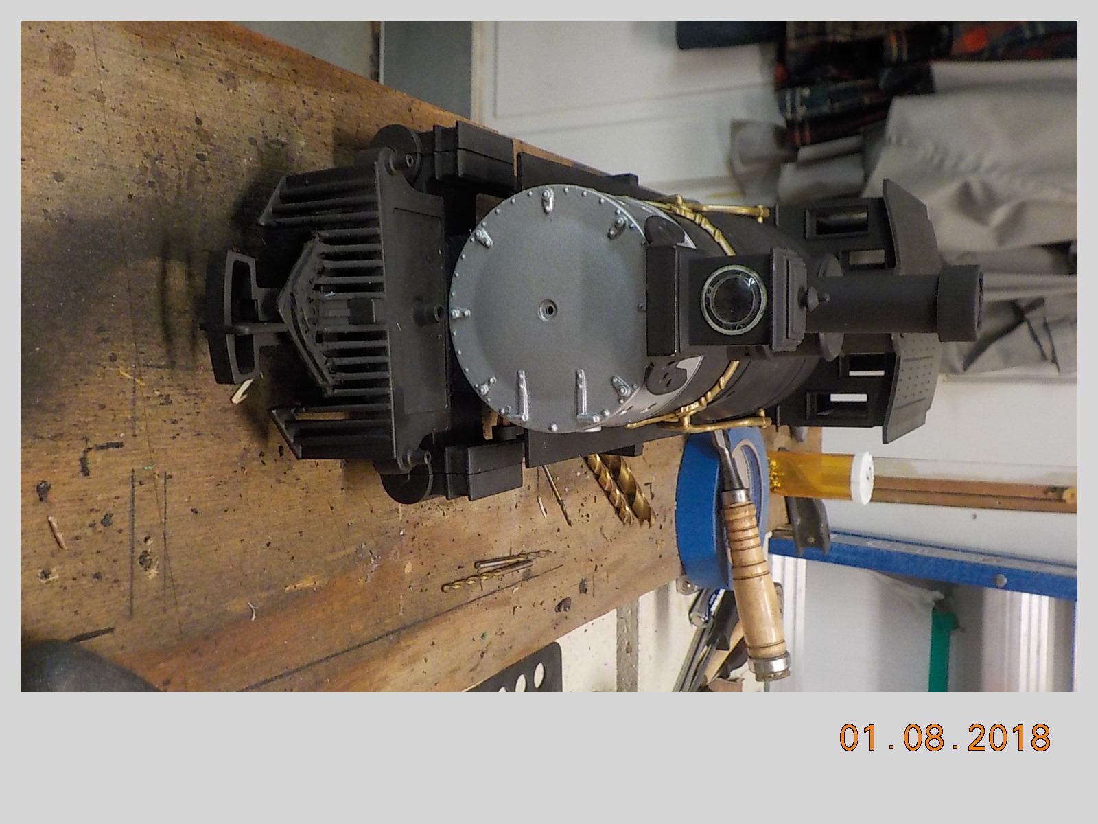

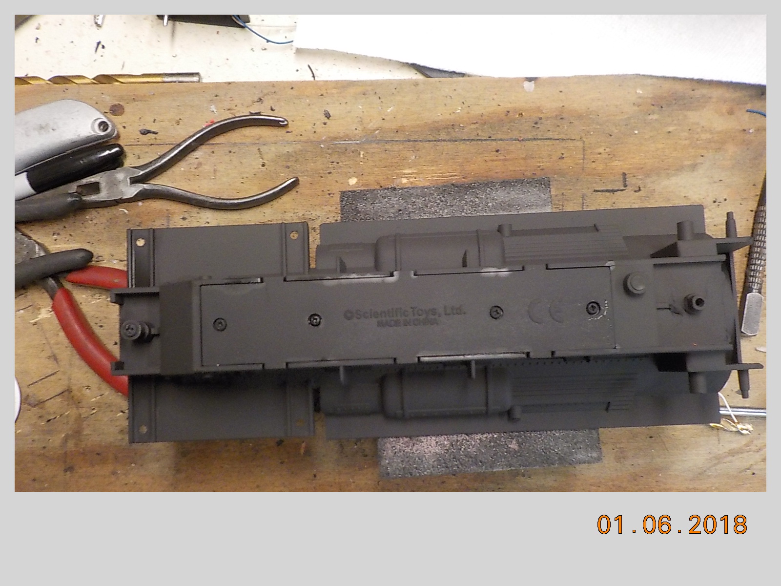

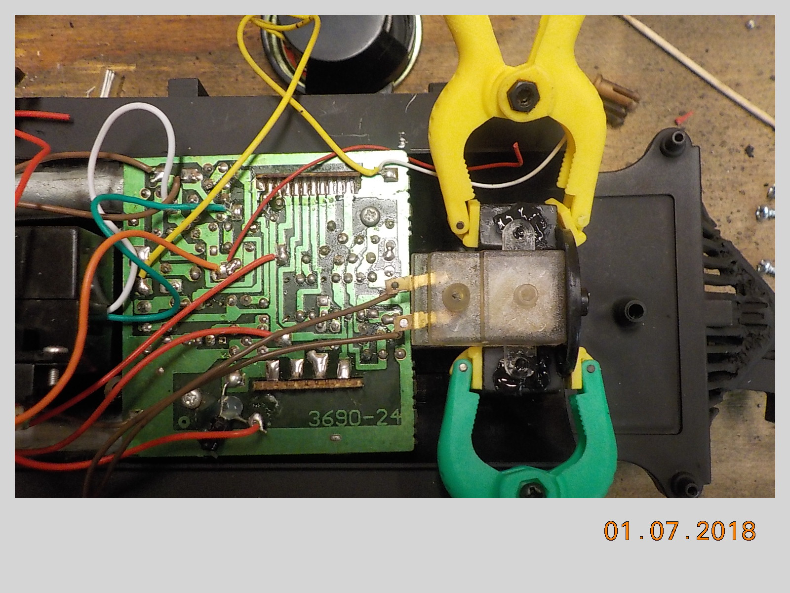

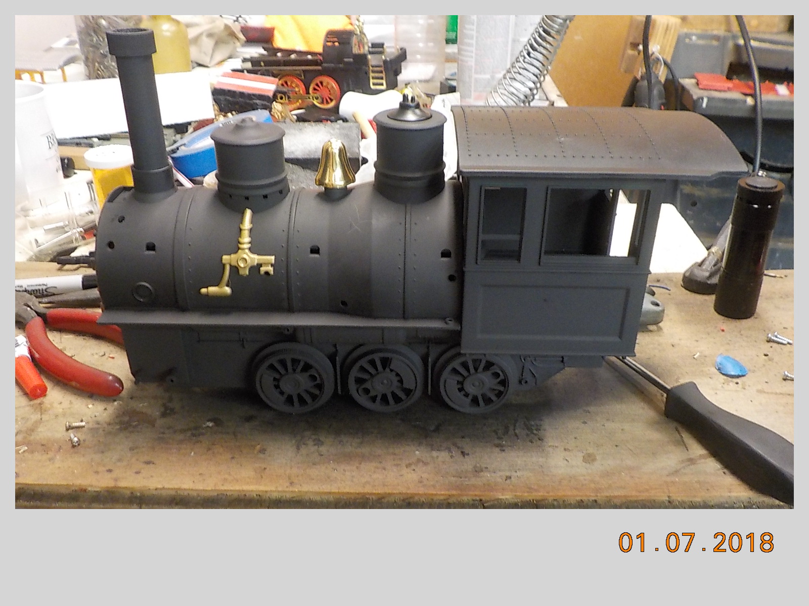

The pictures are of a Scienctific TOY engine getting a remake. Got rid of the gaudy shinny red & green plastic replace headlamp with a 9vdc white LED added bolts along side of the motor above drivers for added traction. Added Bull Frog Snot, that's right snot, to drivers. Tested out and was able to pull 12 New Bright cars around a tight circle under the Christmas tree. Bet Scienctific never considered that in a million years.
More pictures to come. I have even made my own plastic turnouts with Plastic New Bright track and they WORK!!
Nice conversion, I had one of these many moins ago and was going to convert it to one of the Irish Tralee and Dingle 2-6-0's the smaller one not a Hunslet as that is Big Hauler Fodder. Never happened and I sold it on, wonder if it is still eeking out a living?
Looks like you have got. Nice conversion project coming along there. I like it.
