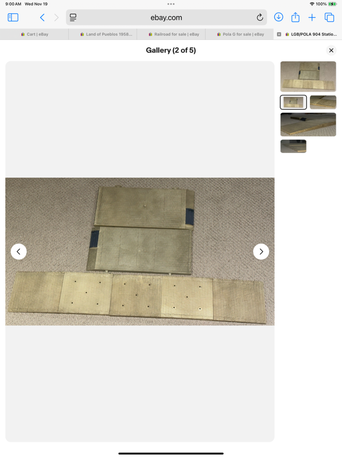

Fyi, so here is a pic of the large station baseplates, for the schoenwiler station, and, the elongated platform base plates with ramp sections. Click to enlarge.
The station fits on 2 plates, with little more than a sidewalk border. So, more may be needed.
Any building without a ‘built in’ base may be placed on these, as may be the fit/case.
