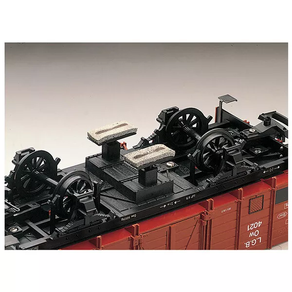

I would imagine it is not much better than the attachment for wagons

As someone who runs infrequently, with tree sap and bird dropping issues, the best thing is the LGB track rubber or a GaryFlex block with some elbow grease.
LGB Track Clening Loco is good for keeping the track clean after the block.
The PIKO one might help keep the track clean if left running for several passes. I use mine on the continuous loop at the end of my layout, where there is not so much crud. Really about as effective as the track pads under wagons. They help a little once the track has been cleaned with a block....
