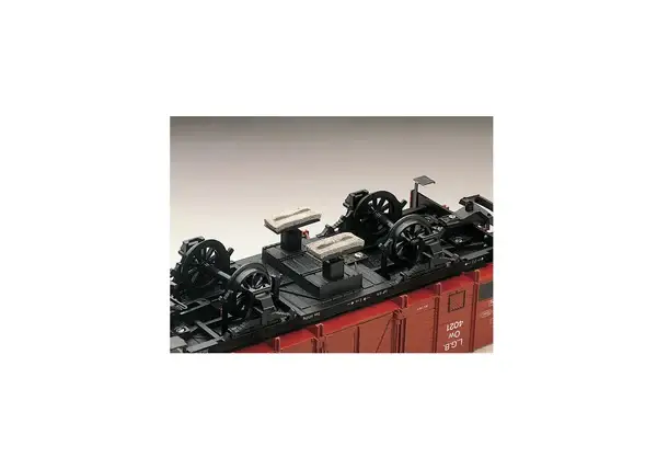

So in fact any battery powered locomotive with the LGB 50050 attachment under a goodswagon could deliver the same result. Or even a trackpowered loco with ballbearing pickups under the wagon.L50050.webp
So in fact any battery powered locomotive with the LGB 50050 attachment under a goodswagon could deliver the same result. Or even a trackpowered loco with ballbearing pickups under the wagon.View attachment 352918
Correct..
Although the Piko pads are a little more abrasive..
