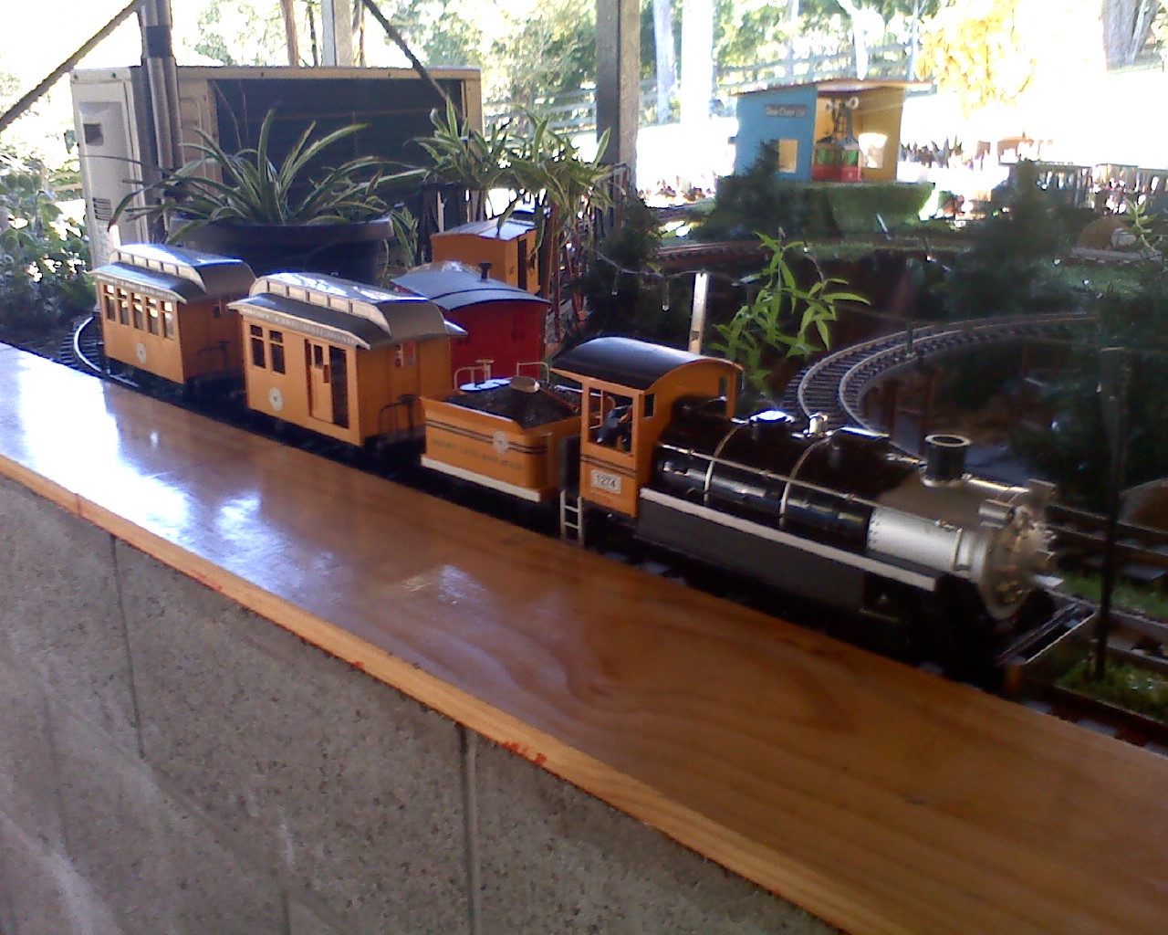

"Sucks Eggs" Really interesting couple of days......have to replace a faulty point (beyond repair now) but successfully fitted out first RC and worked out first rate.........good range of speeds and loco will pull up gradient no problem with extra rolling stock........top section of track runs through a 12" deep culvert for 3 metres and appears no problem with signal while out of sight......

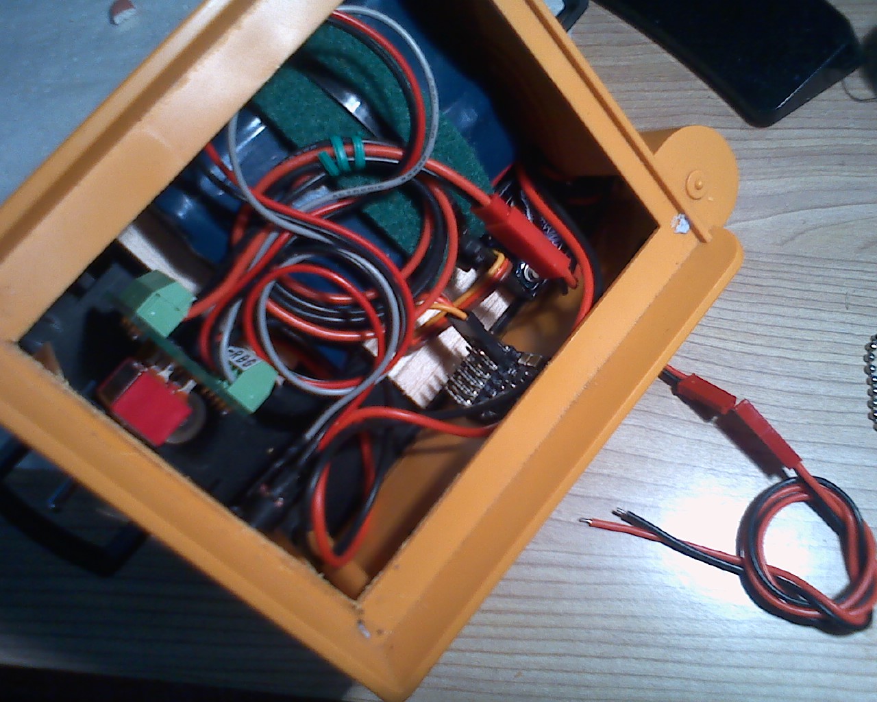

Need to pick a few brains.........A Grandee gave me a damaged rc car and I refitted the Rx pcb in a Piko BC80 powered loco with 9.6V battery feeding thru' 4 x 004 diodes and it drives steadily scale wise with 4 wagons (the first with the rc gear) and 2 Leds alight. However , with with the original Tx (cheapy) is restricted to stop and go.....is it possible to come up with some sort of speed control ??????? Thanks .........

Unlikely, I'm afraid. Even if you could find out the rc protocol used by system, the rx would probably not respond proportionally to the tx signal.
The only solution I can think of is to build a Picaxe speed control system such as that used by gregh gregh on this forum which could (possibly) respond to signals from the tx by stepping up and down the pwm 'voltage' to the motor. See Radio control-Sandstone & Termite Railway
Other than that, find a cheap rc car with speed control and strip out the guts from that.

Thanks Rik...have printed out Gregh's pages and been trying to get my head around them..........Had a lot of success with Gregh's PWM controller, both my OO's and cable car run on them after numerous failings with propriety controllers. I think I have built about 8 of them but have not got around to up grading one for the G's. Mardy
