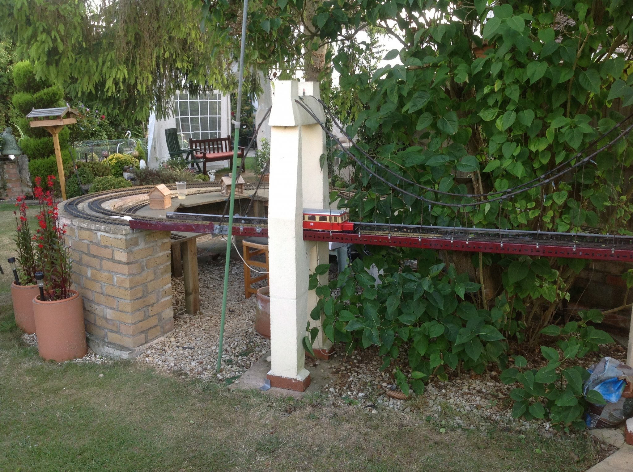

image.jpg Hi Sarah
Unlike 'Rhino' , I'm a big fan of cable tray, the bridge above was built some 10 years ago, there is a lift up section to the left, to give access . The hinge is a 'ladder hinge' which came from an old pasting table. The pillers are thermolite blocks, cut to shape with an old wood saw and glued together. The cut ends of the metal can be sprayed with Galvspray, obtainable from 'Toolstation' to stop them rusting . The support wire , which is purely cosmetic, is 10 mm earth wire. With 15mm copper pipe crimping 6mm earth wire and crimped and bolted with lugs on the deck. On the other end ( if you spin the wire in a drill chuck, while holding one end in a vice, it stiffens it up nicely) the tray is slotted , which provides drainage and allows me to fix track with electrical zip ties. I shape the cut rail at 45* in the direction of travel to aid lining up of the track, on the lifting section. I have seen people use weed membrane under the track, which allows for ballast.
I have used the tray on curved sections of track, cut with a jigsaw and pop riveted to fix it.
