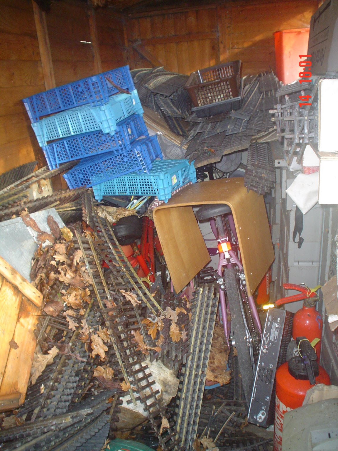

If you are buying track...
You are probably better finding a 'job-lot', as it will work-out cheaper.. - Anything you will DEFINITELY not use, you can sell-on..
Of, you just try to hide it, in the shed! :giggle:
