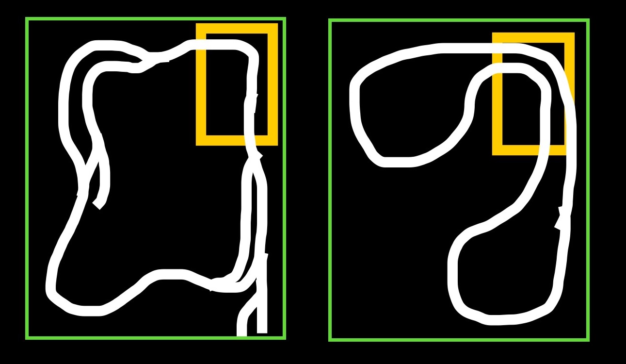

If I may I would like to describe my garden and ask for members thoughts on how I best utilise the space I have available.
The width is 15' and the length 19'. There is an inwards opening gate in the LH far corner. I think it would be reasonably straight forward to convert this into an outward opening one; or I'll have to put in a lifting section.
On the RHS is a 7' x 5' shed with the 7' along the 19' RHS fence. There is space all round the shed although not very much. There is 14" along the back and 12" along the side.
I would like my railway to be, say, 24" above ground level.
Thanks in anticipation,
Sarah Winfield
Sarah, good start! Now you have your measurements get yourself some graph paper and draw it out to scale, as big as possible, include your restrictions, shed etc., and go from there. You need to think if you will use the shed for storage and if so will you want drive-in/drive-out, so you can incorporate that now, even if you intend do that bit later. It's not too difficult, just requires forethought.

You could make a loop wiggling around the whole garden going through the shed so it easy to drive trains in to store on shelves.
If the stations were either side of the shed you could operate it as a loop or end to end depending on your mood.
Couple of very rough ideas on the phone.
Thank you for your layout suggestions and I have some graph paper to try developing my layout.

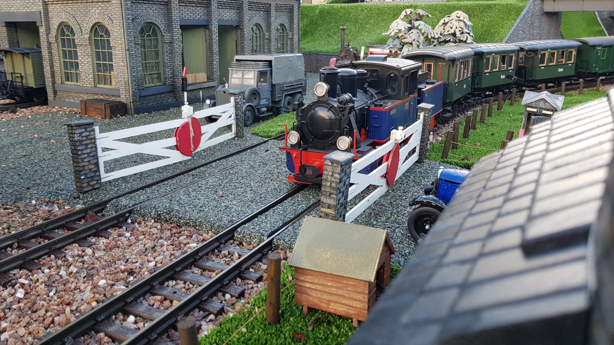

My lines raised up..about 36 inches but it varyes as the ground wasn't flat.
I run continues with a model village outlook..it has to look right as much as run right..best advice I could give build it big enough to be fun and small enough to manage ( time/maintances)20180126_132157.jpg
