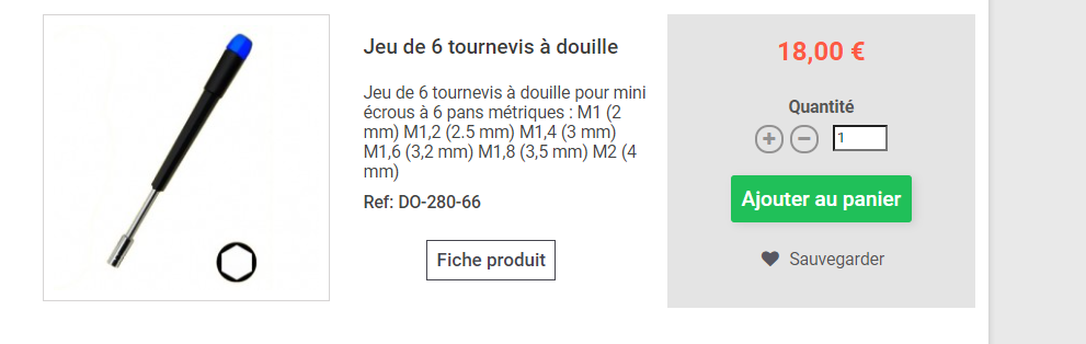

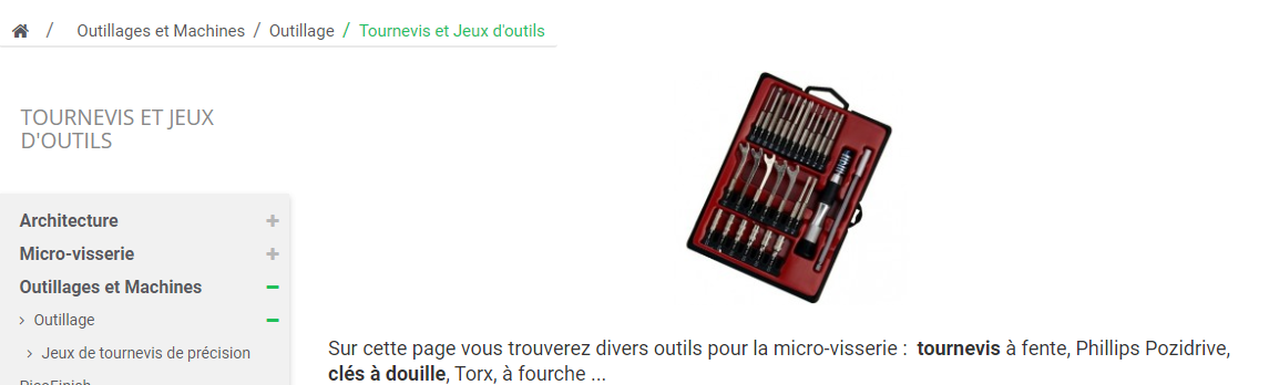

So im now really confused. I want the socket to help attach my newly acquired Bertram Heyn point levers to some points.
The info I have is that the nuts/bolts required are M2, so I ordered some M2 nuts and M2 washers off eBay and they fit onto the existing bolts perfectly.
Unfortunately, all I have to try and tighten the nuts are tweezers or pliers, hence my desire to get a suitable socket driver.
I’ll take a look at the site suggested by Gérard.

The M2 nomenclature, refers to the fastenings beings to the metric specifications, and the thread being nominally '2mm' in diameter..
The nuts, and hexagonal bolt-heads, will obviously be larger than this (in this case 4mm AF (Across Flats) so you require a 4mm AF spanner or nut-driver..
To save us having to remember which size spanner, fits which size nut, metric spanners are marked with the 'M' designation we use for the nominal thread-size.
