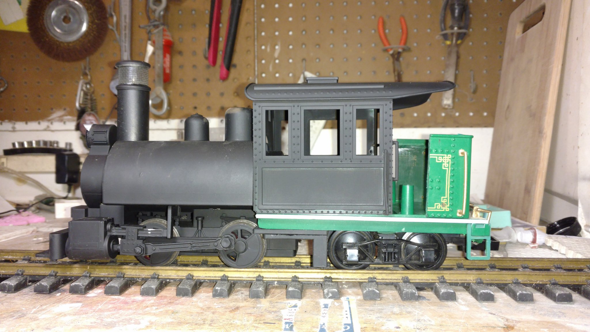

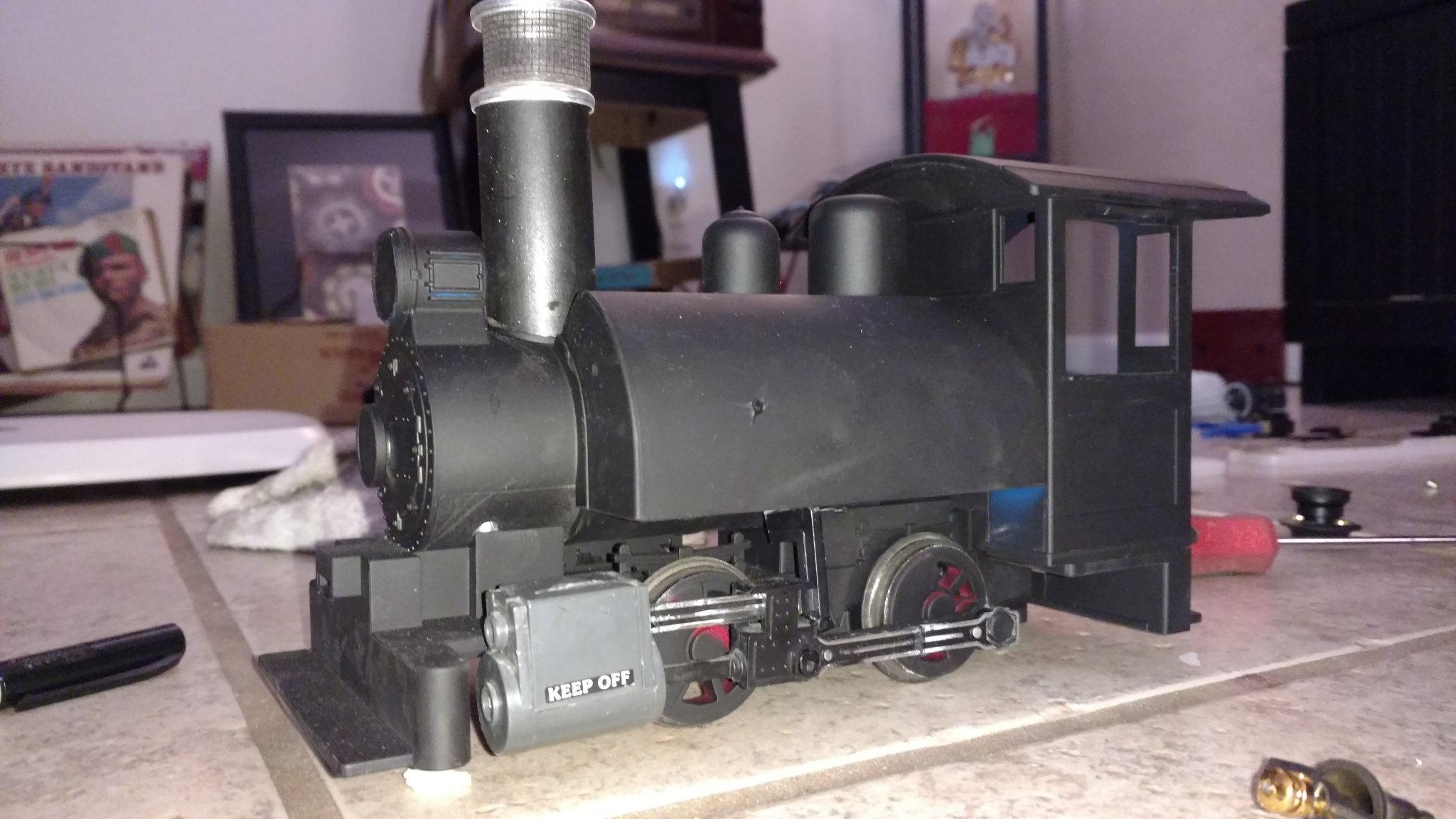

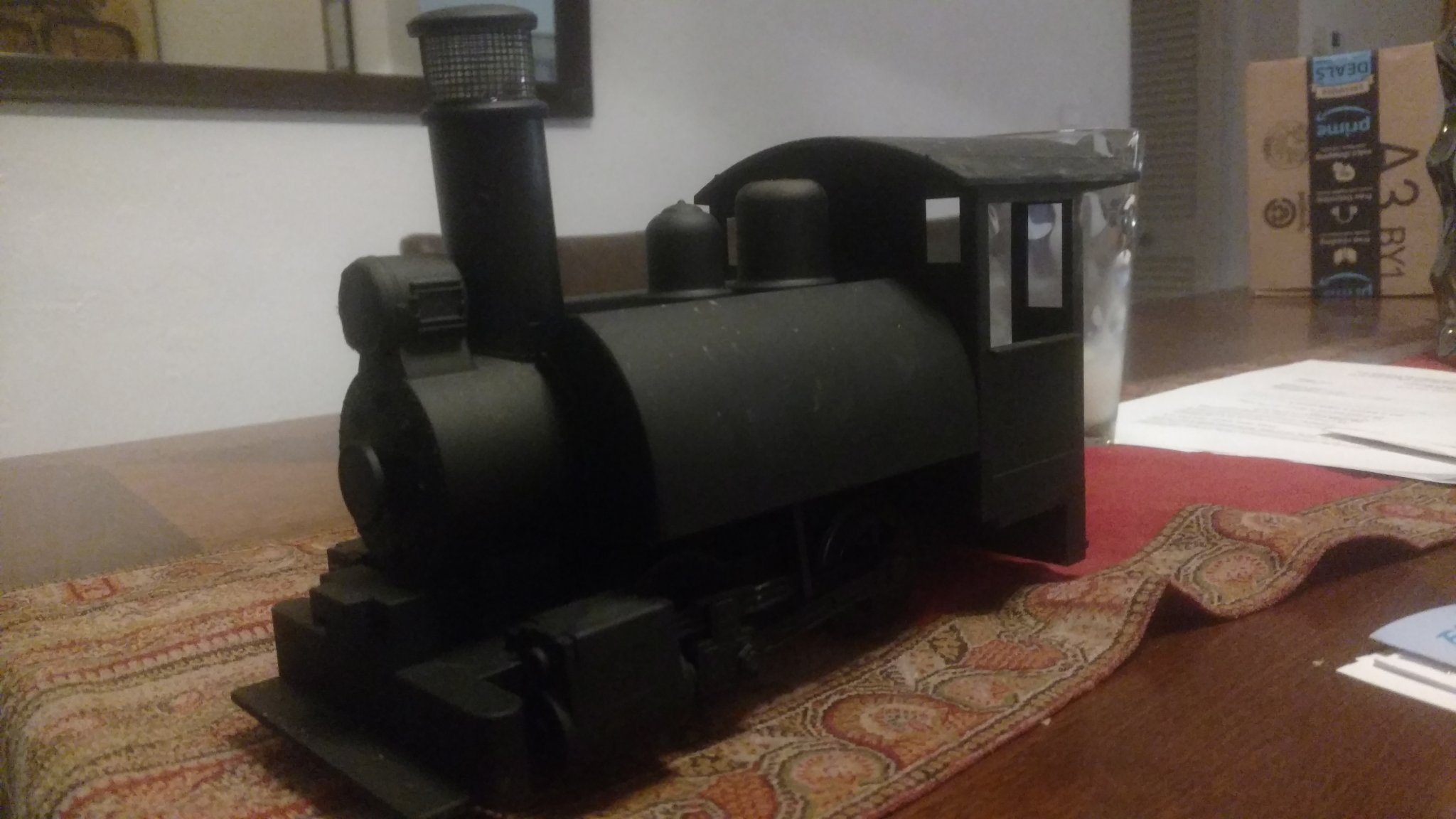

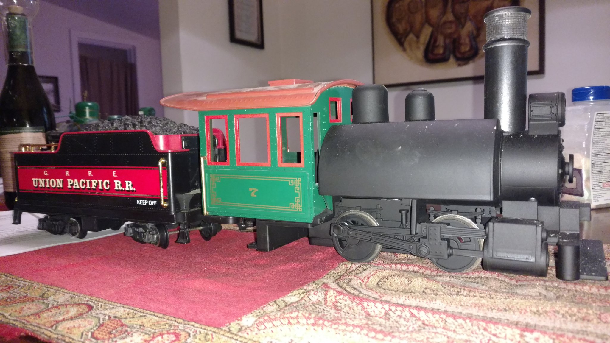

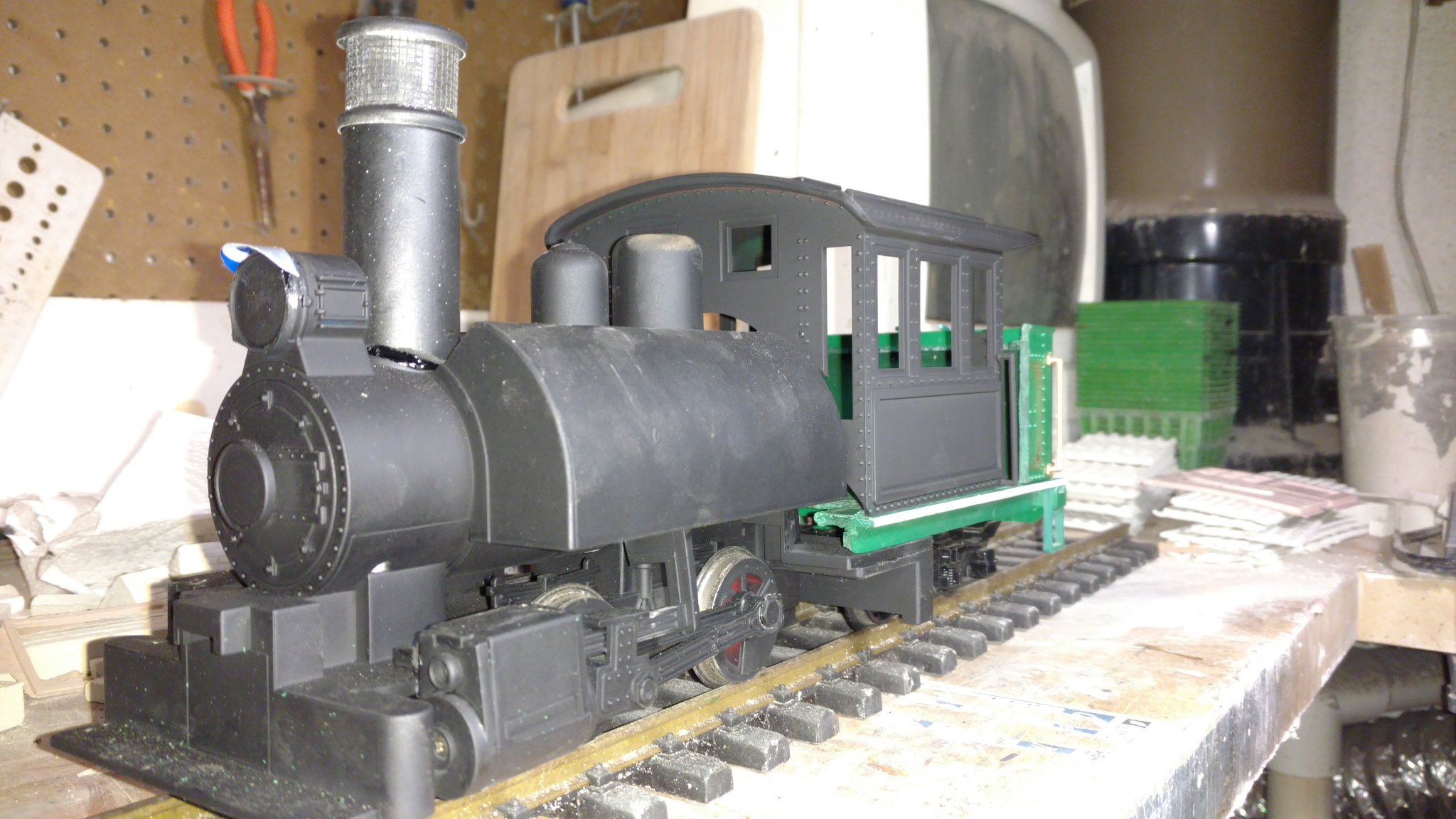

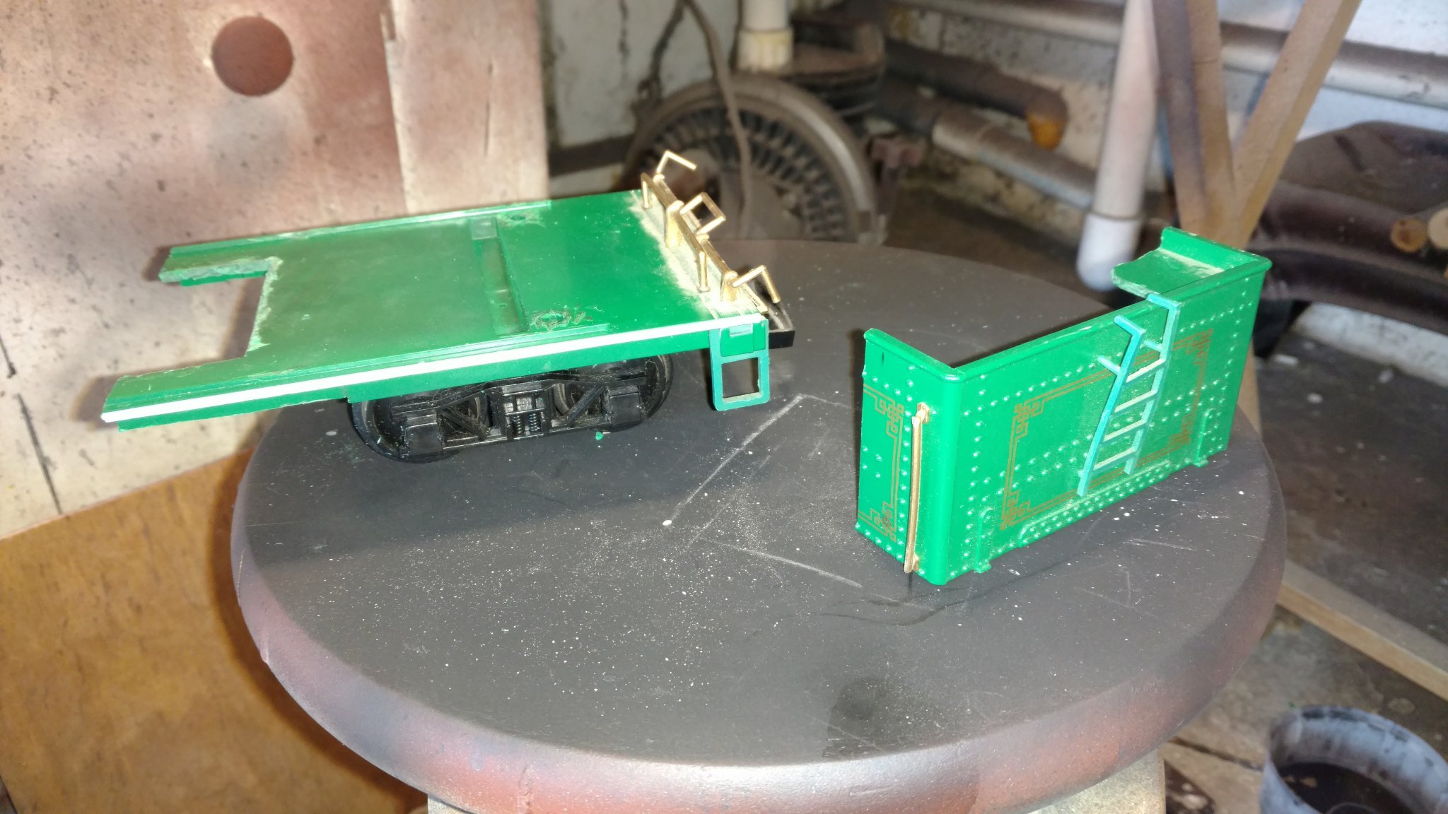

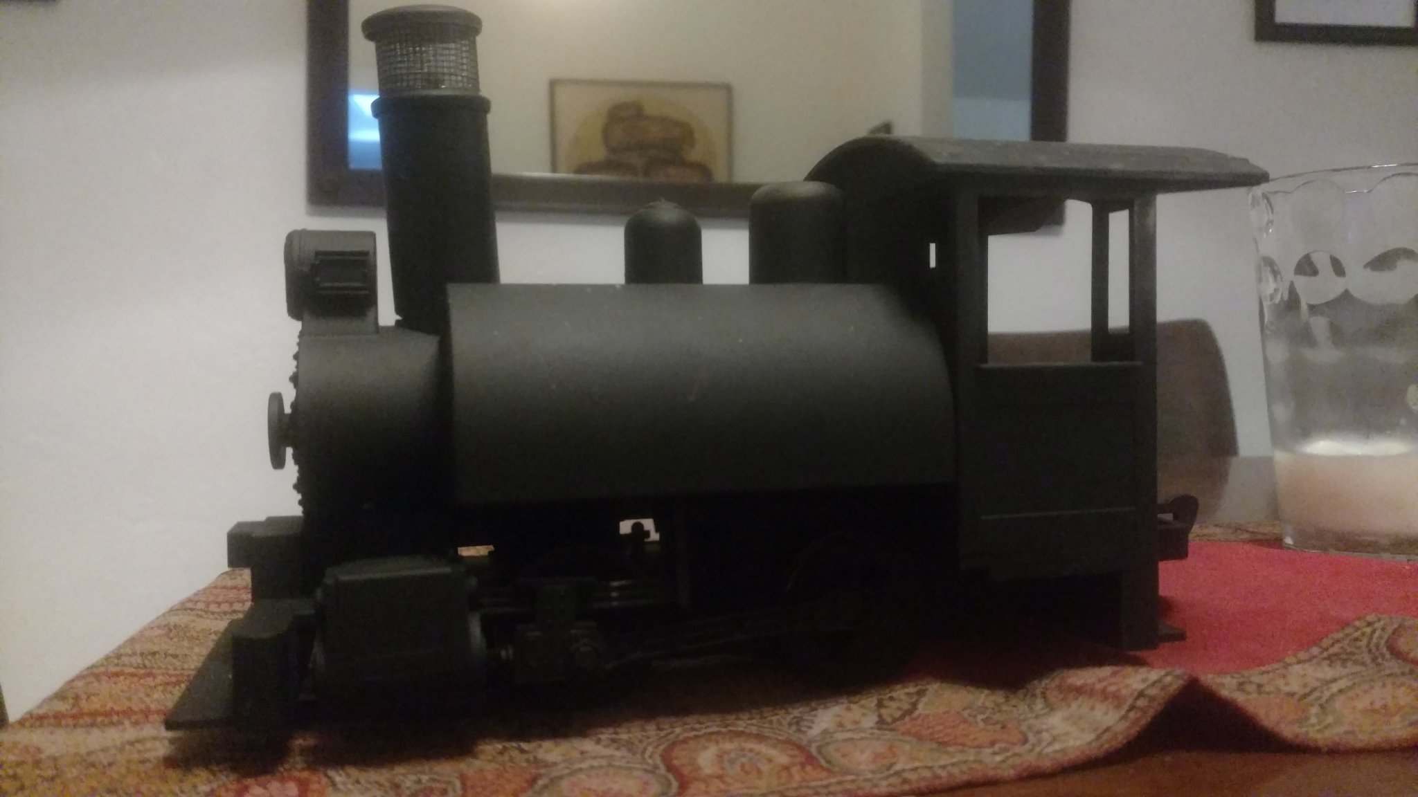

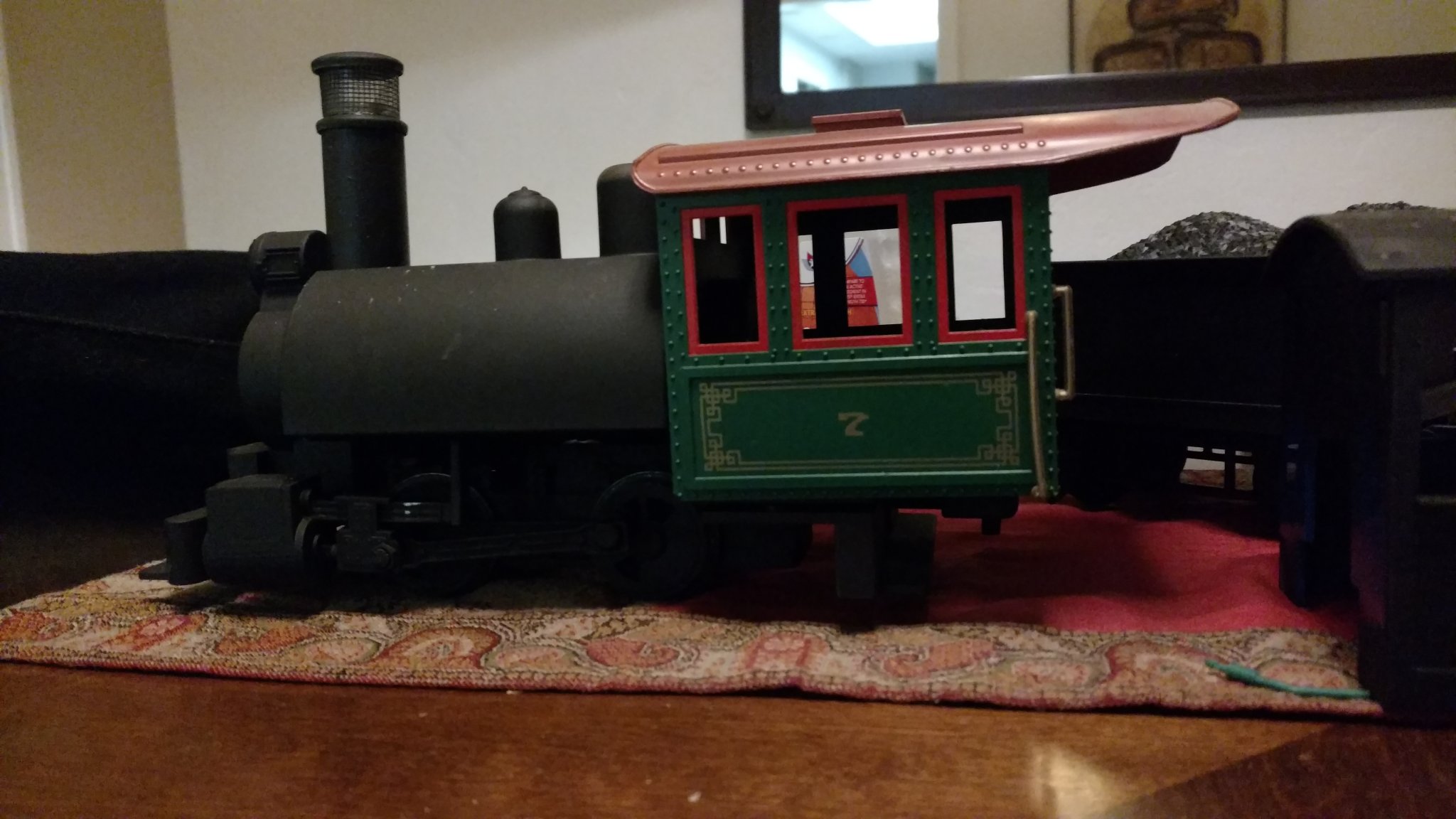

Worked on the lil hualer last night. Got the coal in the bunker. I don't want any more weight in the back so I cut a piece of styrofoam and hot glued black fish aquarium gravel to it and mounted it in the bunker. Looks ok . Wish I would have made the bunker bigger. Pics are a little dark sorry.IMG_20180227_231546416.jpg IMG_20180227_231542089.jpg IMG_20180227_233338876.jpg

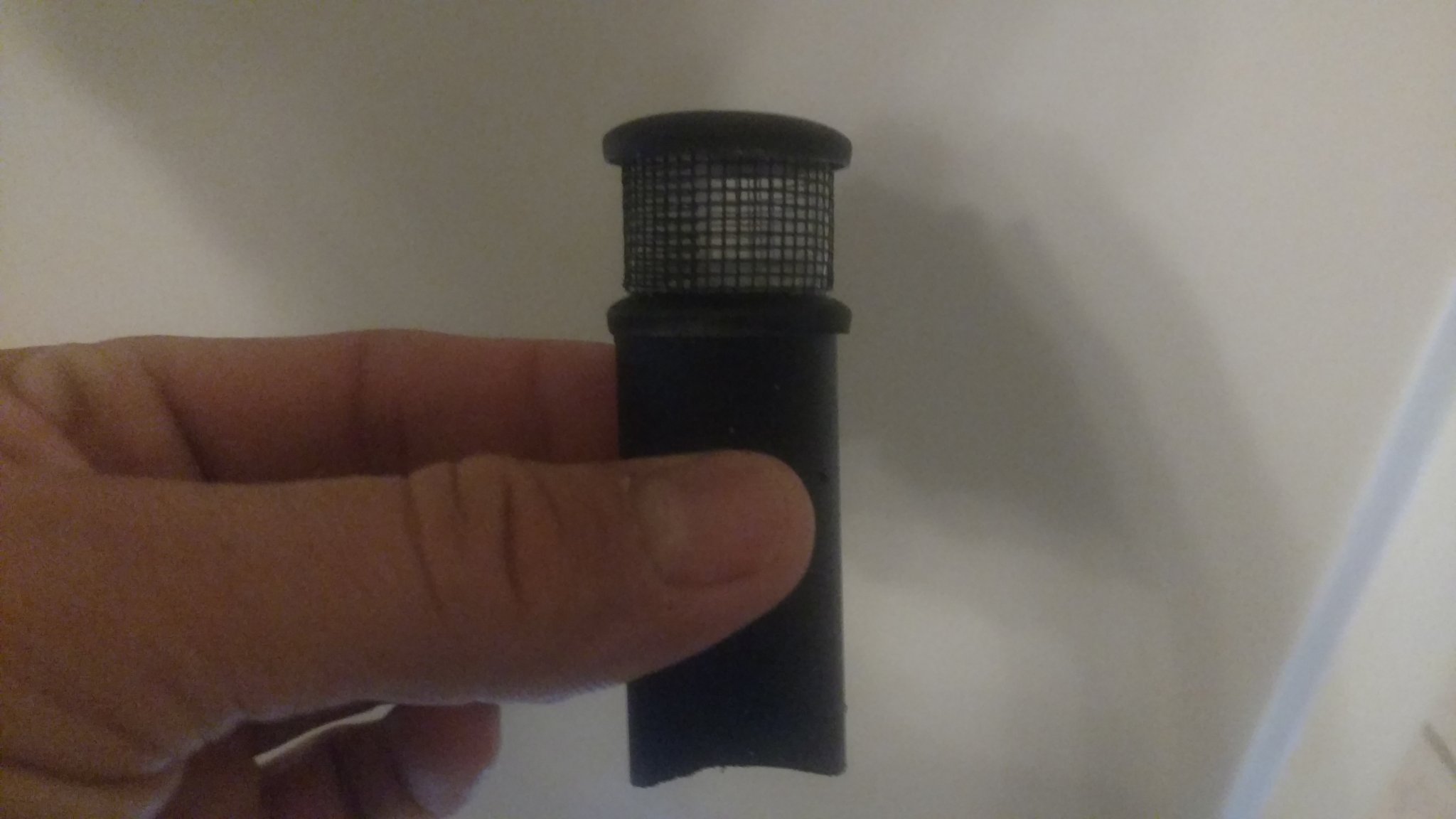

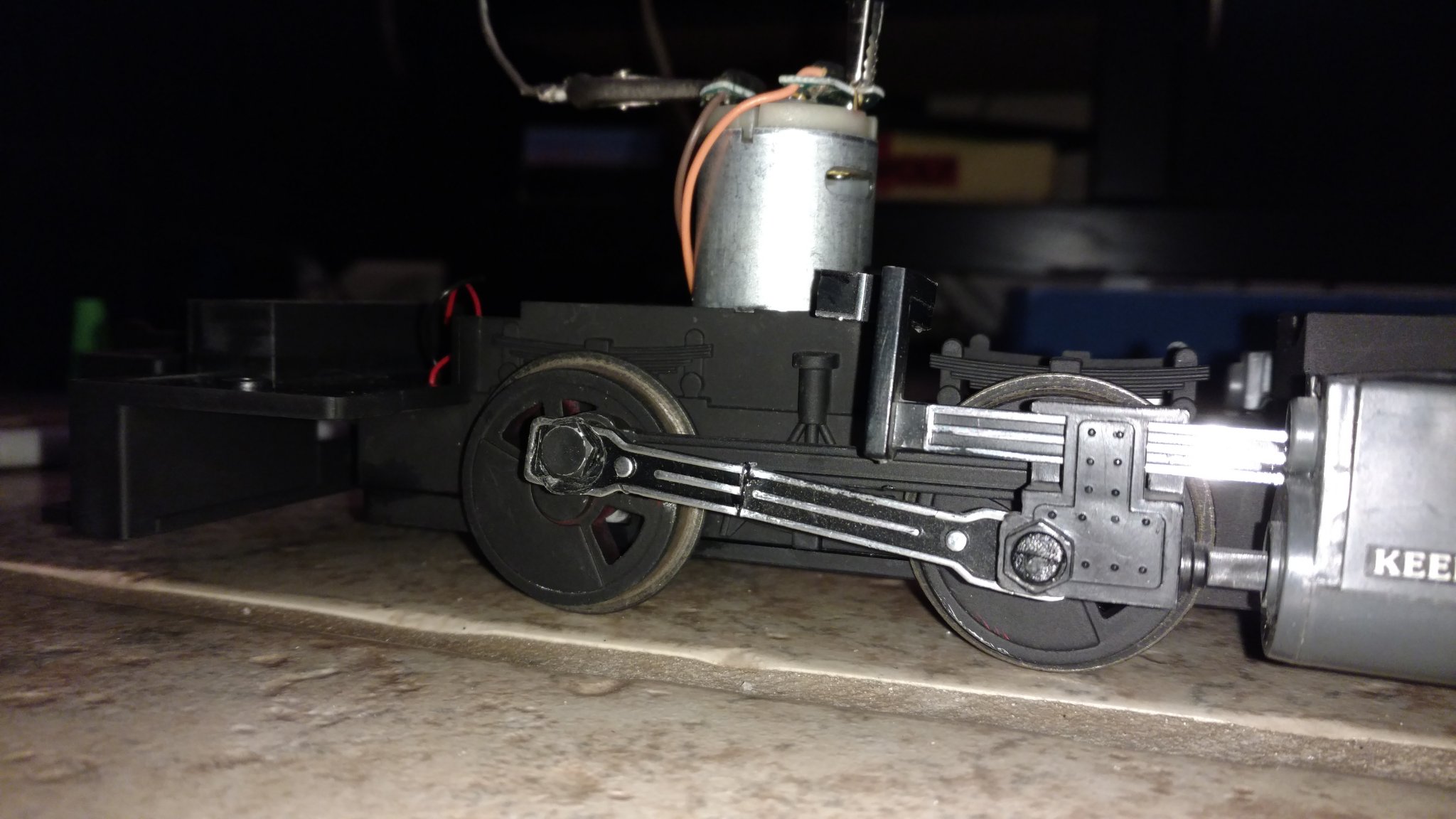

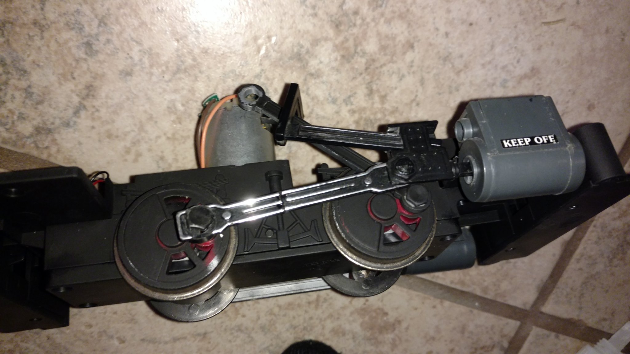

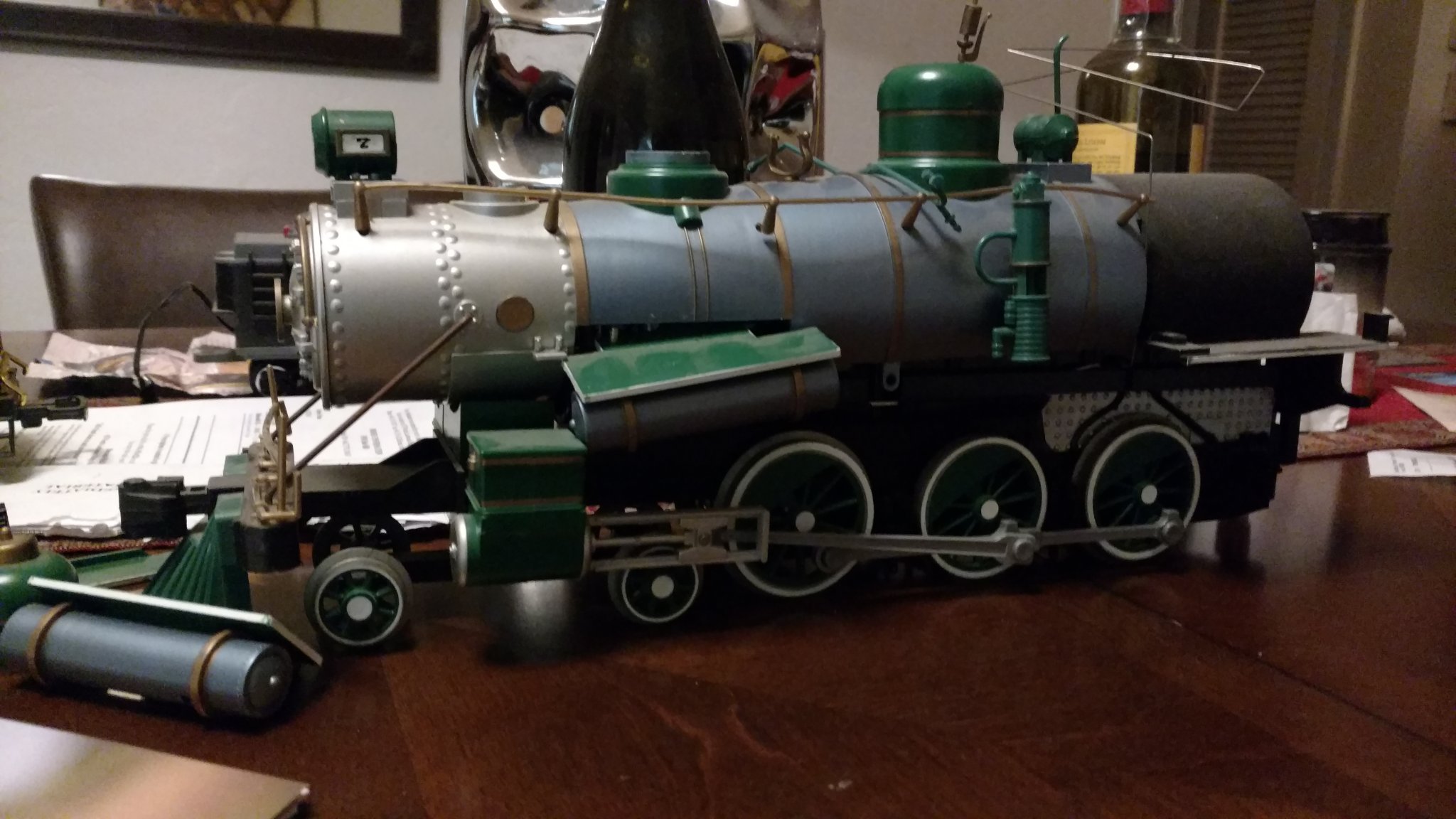

Jack I like the look of the Forney you have created think maybe the stack is a little large in diameter but if any not much. I know you tried running the creation when it was an 0-4-0 but have you tried it as a 0-4-4. I know when I did my Forney that it had a fair amount of rear end overhang because the drive system was not articulated, enclosed is a pix of my rear truck suspension, shorter is better but if you are operating on 1500 or larger it's not a problem. Really like the looks of the engine, tankers are one of my favorites, Bill
sorry forgot, you might want to add a saddle water fill pipe from one saddle tank to the other and I would say probable where you took the bell off and it would hide the bell spot and give you a plausible water fill
Thanks for the comments Bill. I was debating the size of the stack then I found a video on YouTube and the saddle tank loco had pretty much the same stack so I thought I would just leave it that way. I took a screenshot of the video. I can't zoom in or it won't fit to upload. I like the picture you sent pretty much exactly what I have underneath. I wish I would have made the bunker longer but like you said the overhang would have been even more. Do you have any pictures of the piping to join the tanks? I like that idea. Thanks for the great comments . Hopefully the more I do stuff like this the better I will get. I strive to be as good as you and others on here. You guys are in a different league lol..

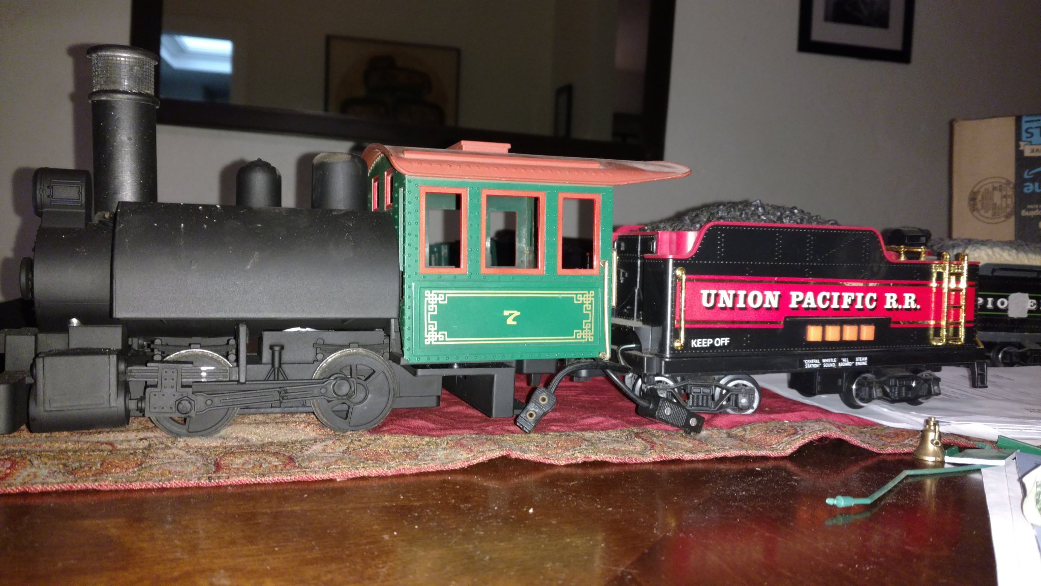

It's running as a 2-4-4 now. And so far so good...
Check out the 2-8-2 saddle tank engine in the forum, you can see it in between the first sand dome and the steam dome, Bill
