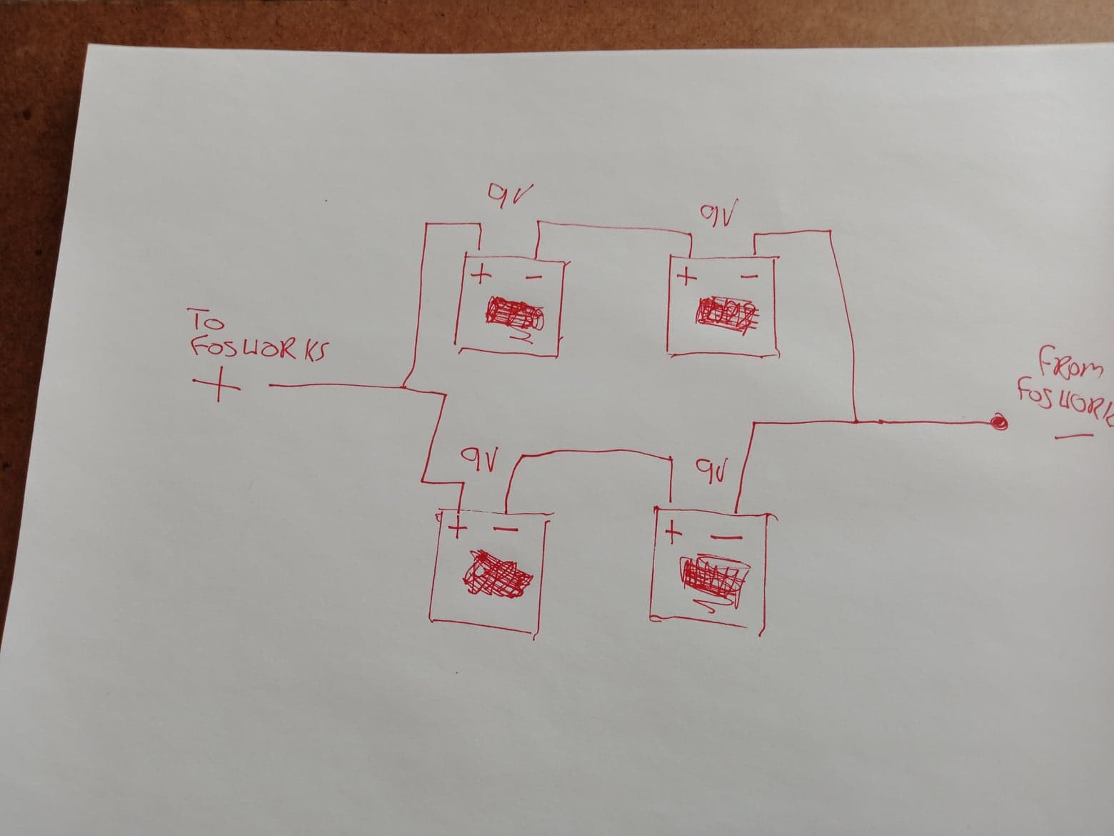

Right, this is doing my crust in. I have an Accucraft Plymouth locomotive and very nice it is too. Handsome, in a sort of American diesel sort of way. Originally, it was a two rail loco like all their electric locos. As most of my stock and locos will not work with a live rail set up, I set about converting it to radio control and batteries. I found a r/c from an American outfit called Monocacy and filled my old brakevan full of batteries for permanent coupling to the shunter. Soon, my crappy old phone siezed up so I decided to reset it, wiping the Monocacy program off it. Then I found Monocacy has gone bust and asked on here if anyone had a copy of the software. Someone did have (thank you!) so I tried to get it working again. I also managed to find the software for myself and kept trying. Nope, no dice. So says I, bu££er it, and I ordered a set of bits from Fosworks. Are you still reading this? Well done. My question is....can I wire up the "Amazon Batteries" like the photo below? This would give me 18v and 1200mAh, that would be enough I think.They would be removed from the loco for charging of course. It would be great if I could power the Pitman motor withough dragging round that brakevan.
