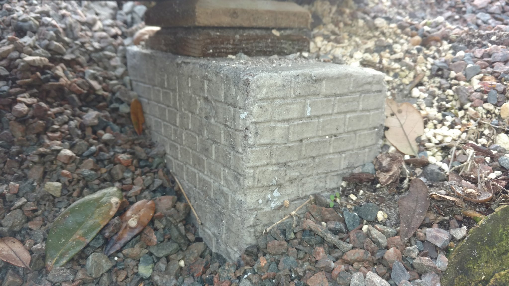

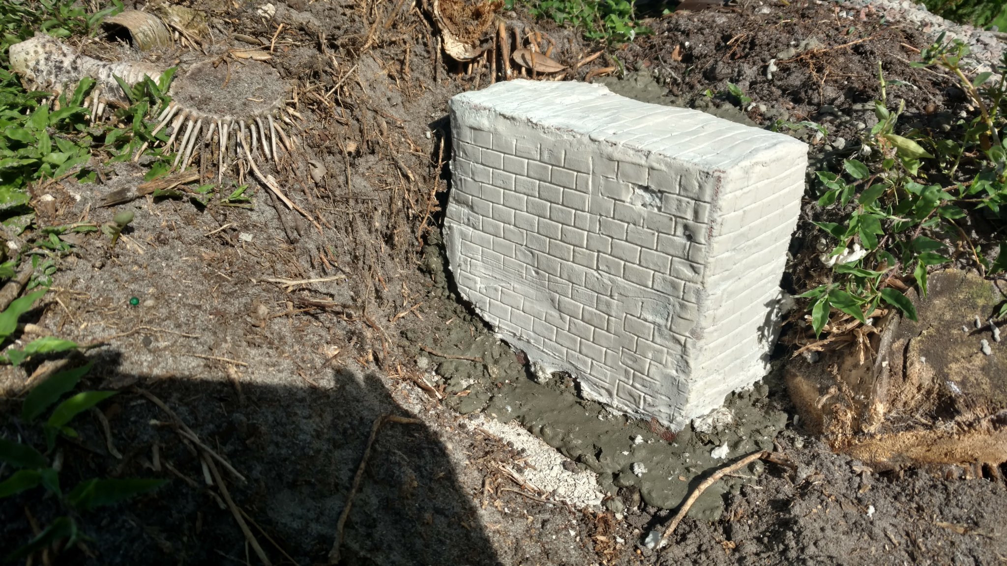

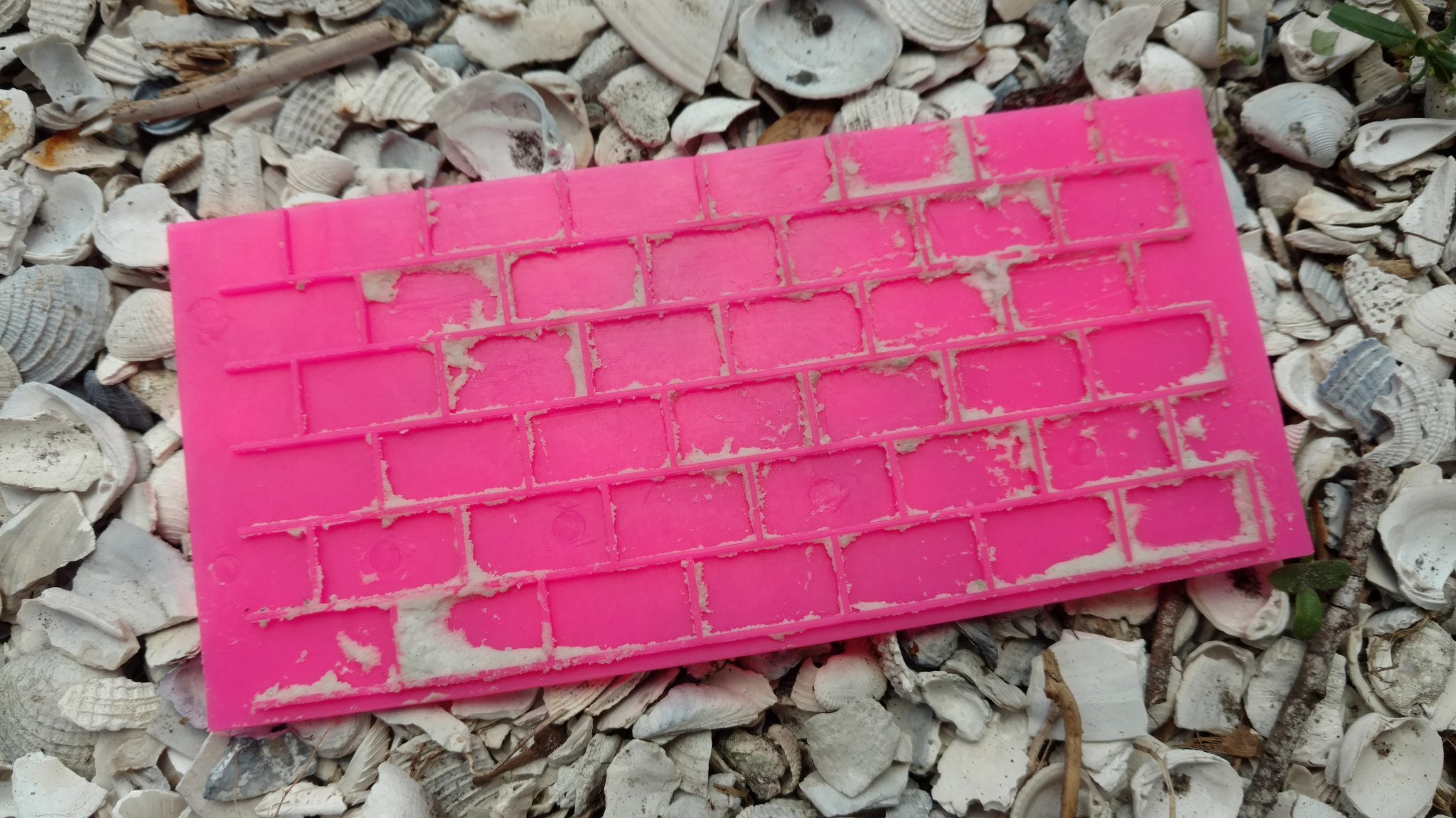

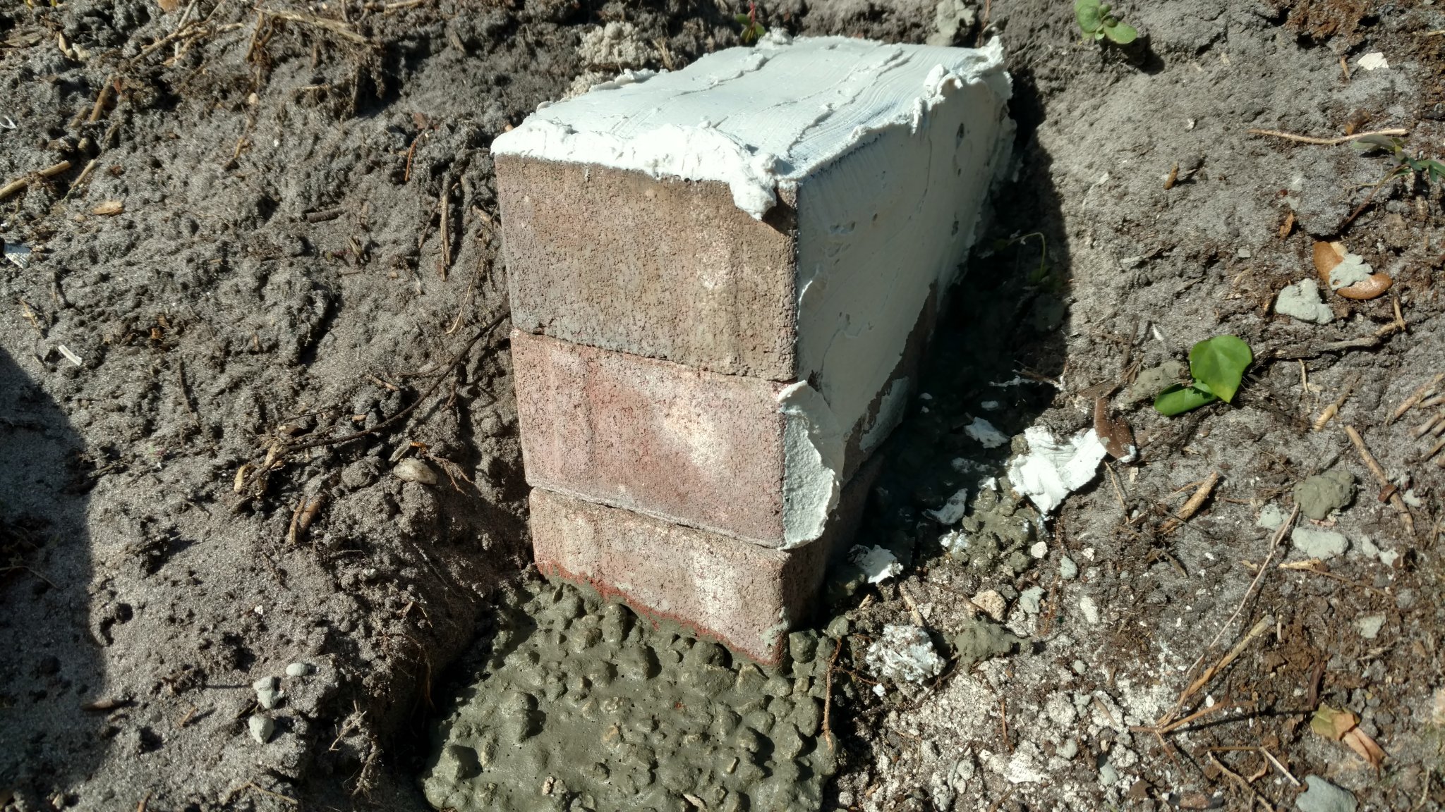

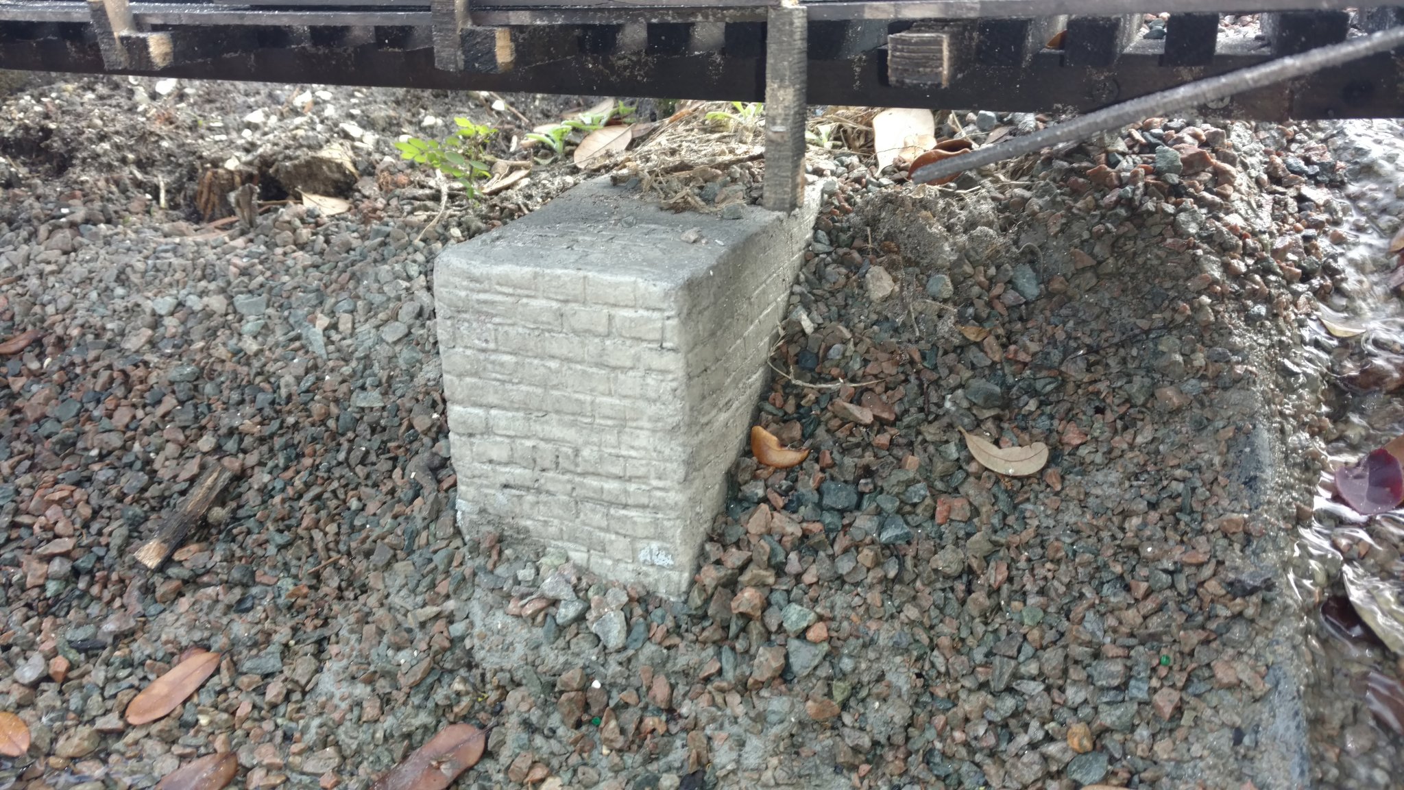

For my bridge I used bricks glued together . Then covered them with grout . Then used a cake mold to push in the stone work before it was totally dry. Looks decent and really cheap to do. After everything was dry I did a black paint wash over it to weather it slightly. Just another idea you may try.IMG_20180210_085341937.jpg IMG_20180210_085325121.jpg IMG_20170821_172823140_HDR.jpg IMG_20170821_172819069_HDR.jpg IMG_20170821_190156734.jpg IMG_20170821_172819069_HDR.jpg

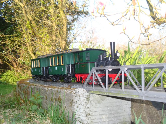

I did have a viaduct made from 3 and I made my own precast concrete piers. The formwork is quite easy to make form sheet of WBP plywood screwed together.
