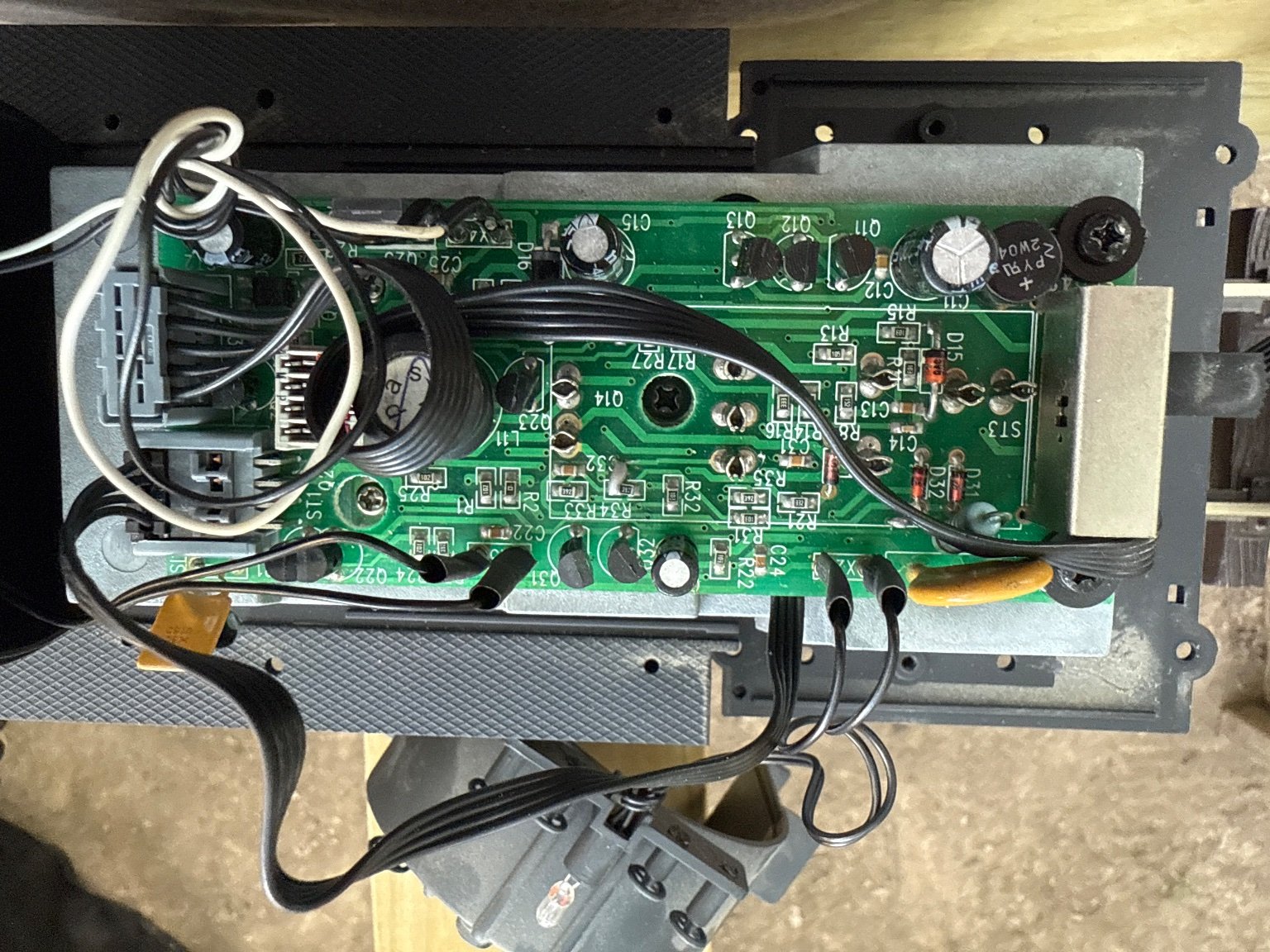

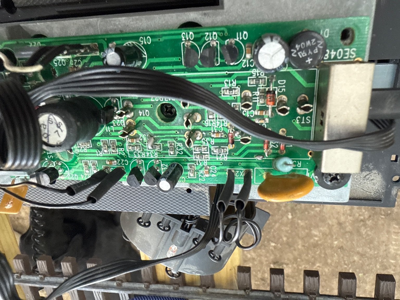

My poor little 0-4-0 has died!
I can see track voltage to the mainboard, but no further.
Would any of you fine folks have, and be willing to part with, the LGB mainboard that looks like the picture below? I know most folks that shift to DCC bin these parts, perhaps one of you has squirreled the old one away?
I will also look through evilbay and TrainLi, but I think you all are a better resource.
Of course I know I can bypass this board and build a simple analog control circuit for this project, but for right now I’d like to keep it factory-styled.

It is quite unusual for these to fail, but when they do, it is quite often the diodes forming the bridge from track-voltage to the circuitry on the board.
I am assuming you had this loco for some time, and it is not a new acquisition?
DIP switches are 'on', and you have tried different positions of the switch?
