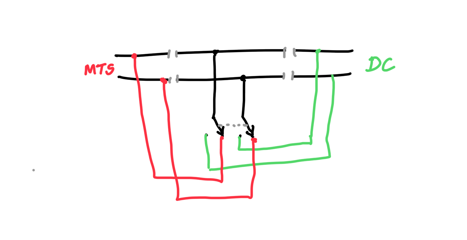

Thanks. So my best option is to run a separate analogue out and back line I guess. Just need to work out how to deliver an MTS loco to it. Would an isolated piece of track do the trick?
You'd need a short section (longer than the loco) that is isolated from both the MTS controlled track and the DC controlled track, plus a DPDT (changeover) switch to connect the isolated section to either MTS or DC.
