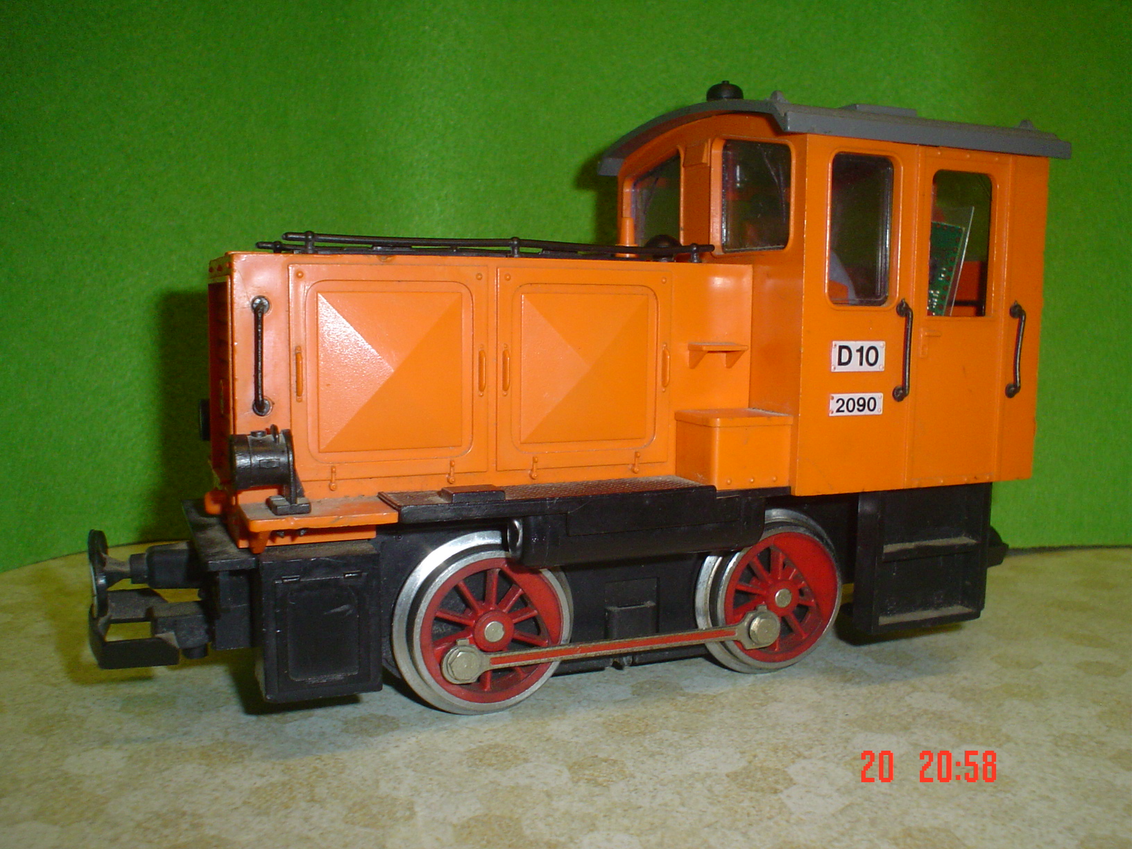

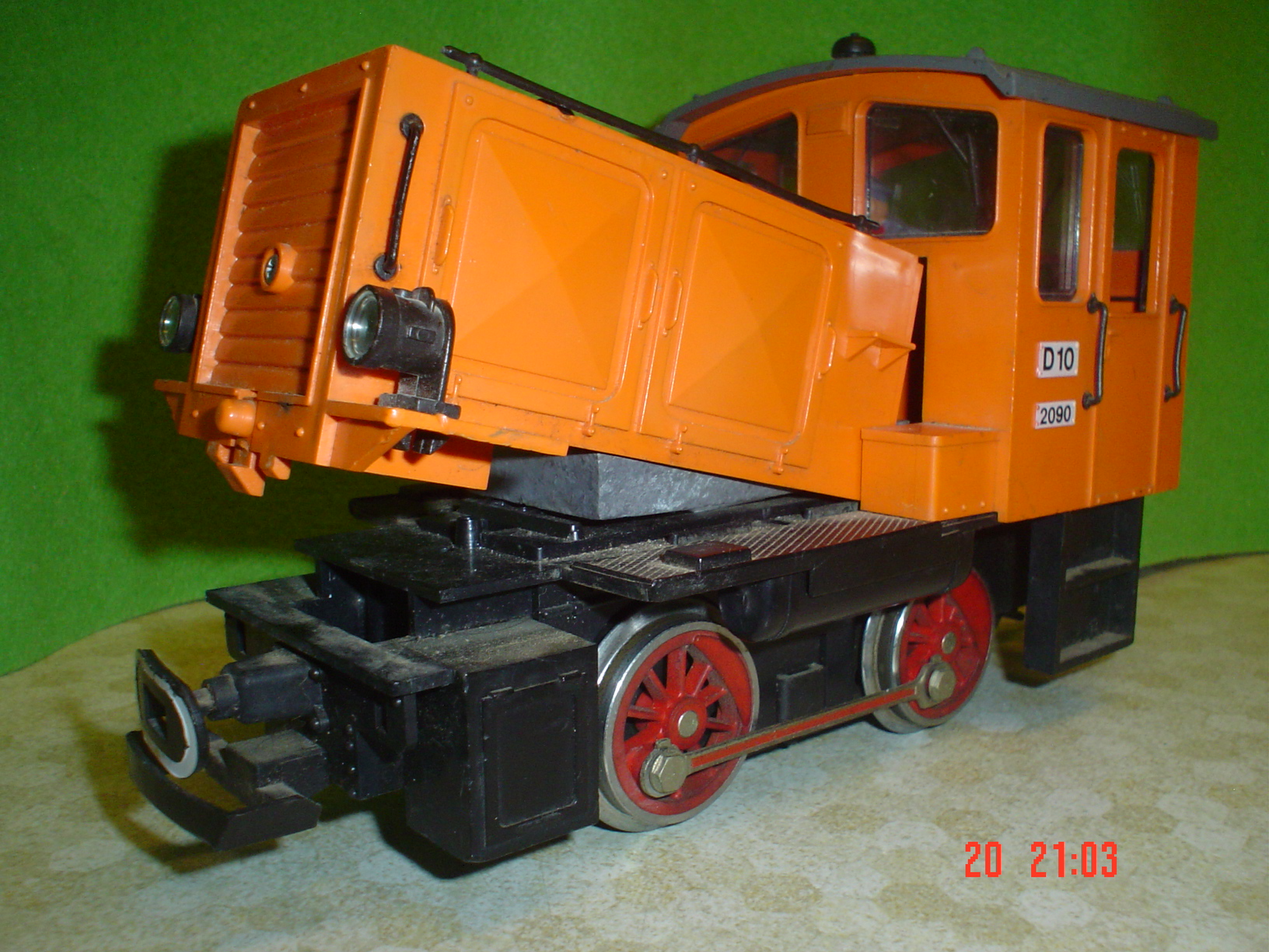

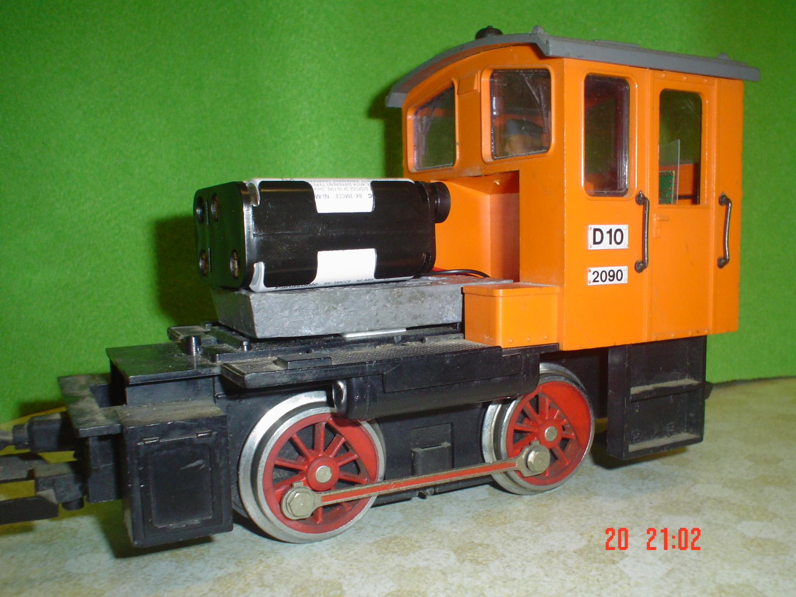

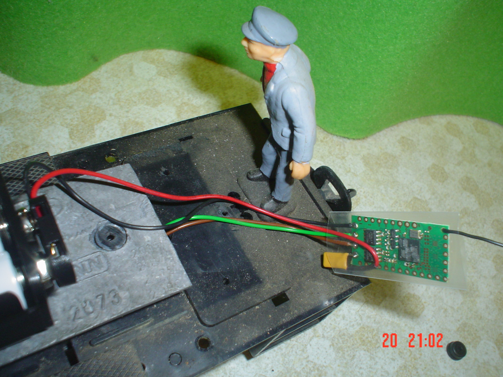

Possibly the simplest small loco to convert is a LGB starter set diesel...
You don't even need a screwdriver to get into the thing!
The 'electrics' you have to remove, is one small length of wire. You can even leave the pickups in place, if you are NOT going to put power on your track.
If you are prepared to remove the battery pack at the end of a running session, you can even do away with a switch, charging socket, and the like..

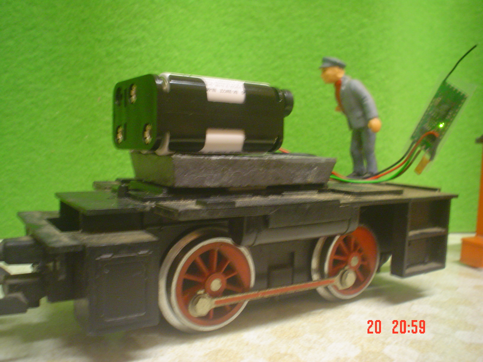

As promised..
She ain't pretty, and is a little neglected.. AND I do not recommend this as a permanent way of doing things, but hey! It works. :giggle::giggle:
I *know* the wires to the motor are the wrong colour, but they were the first I grabbed, with the right 'ends' on to fit the pins!
