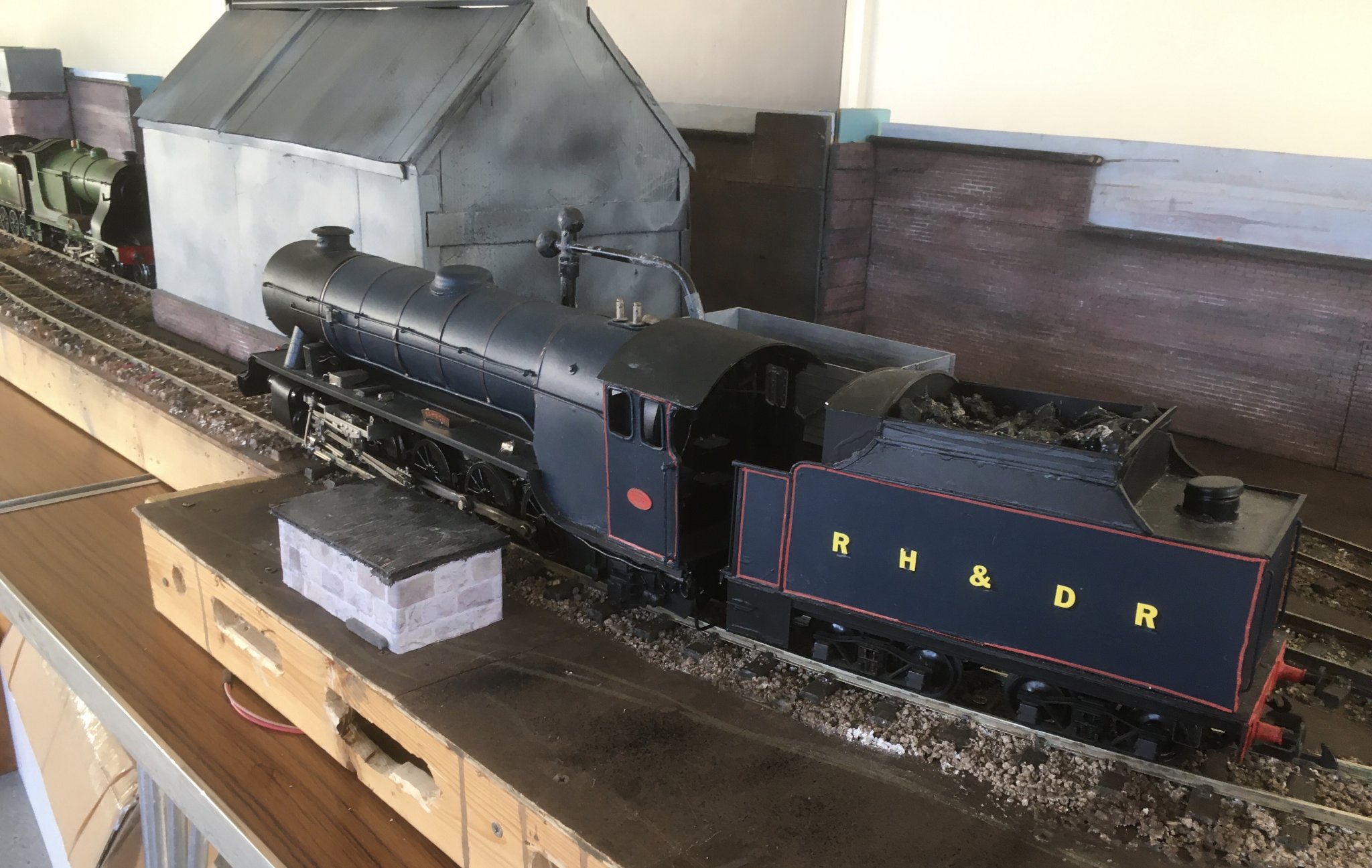

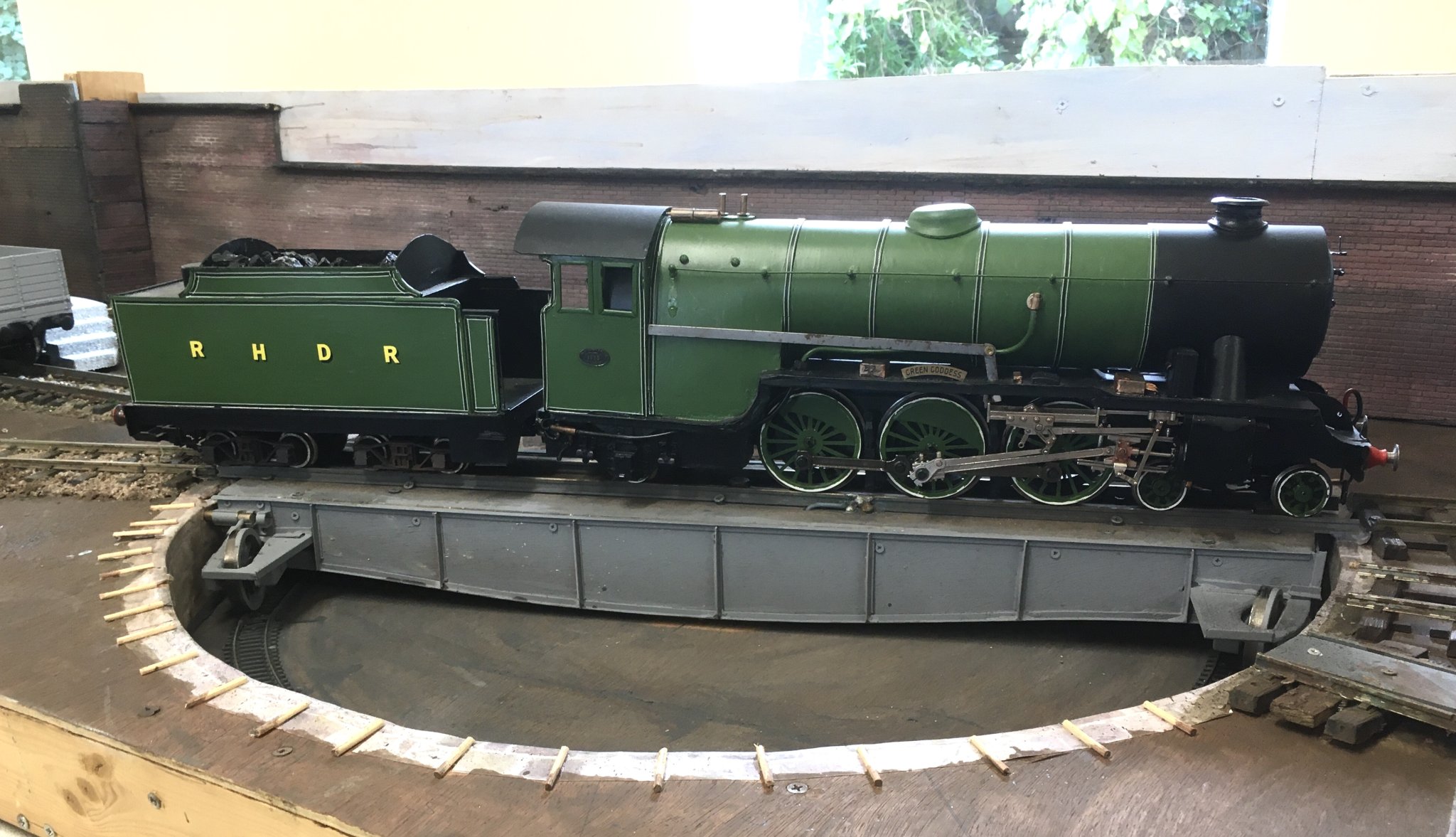

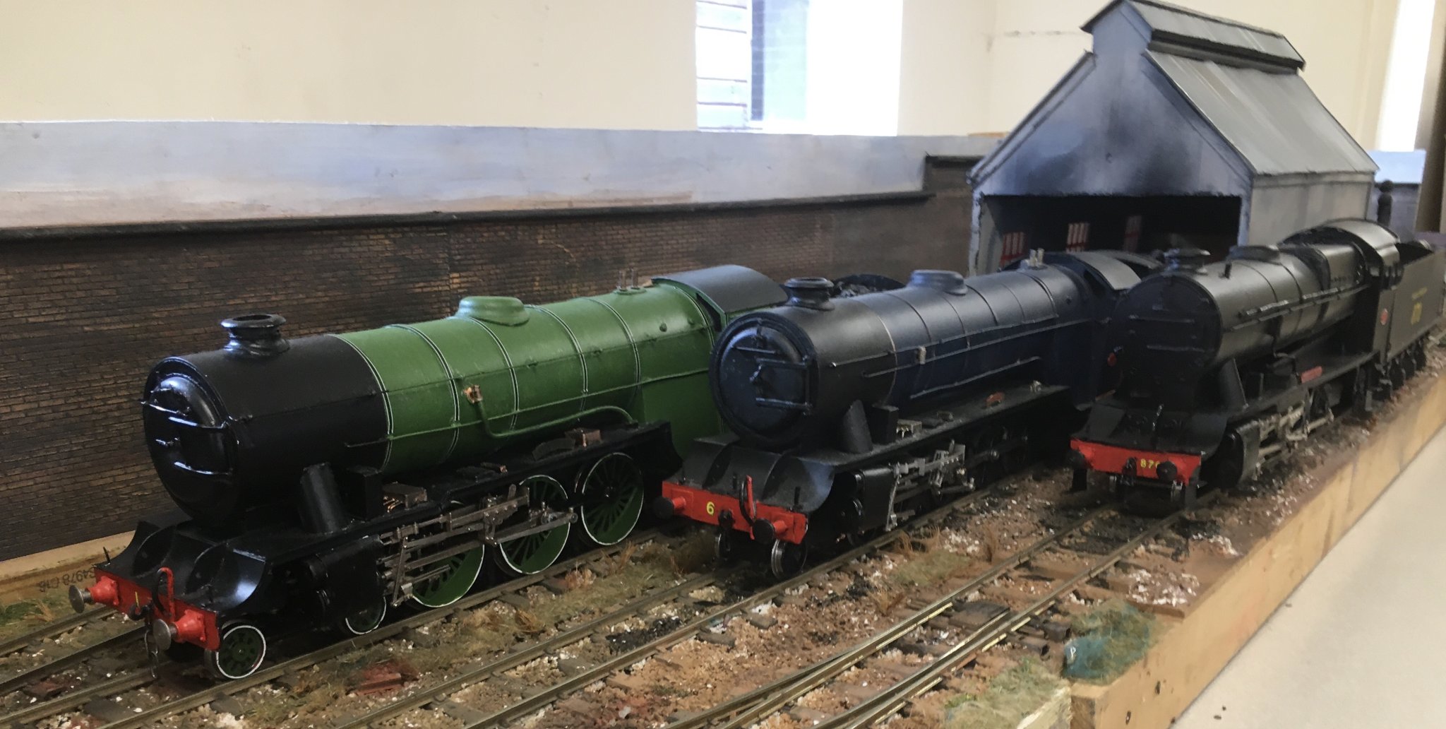

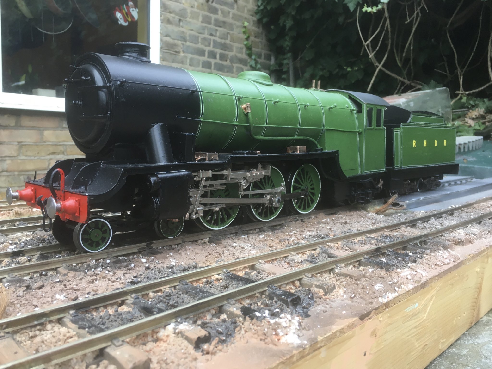

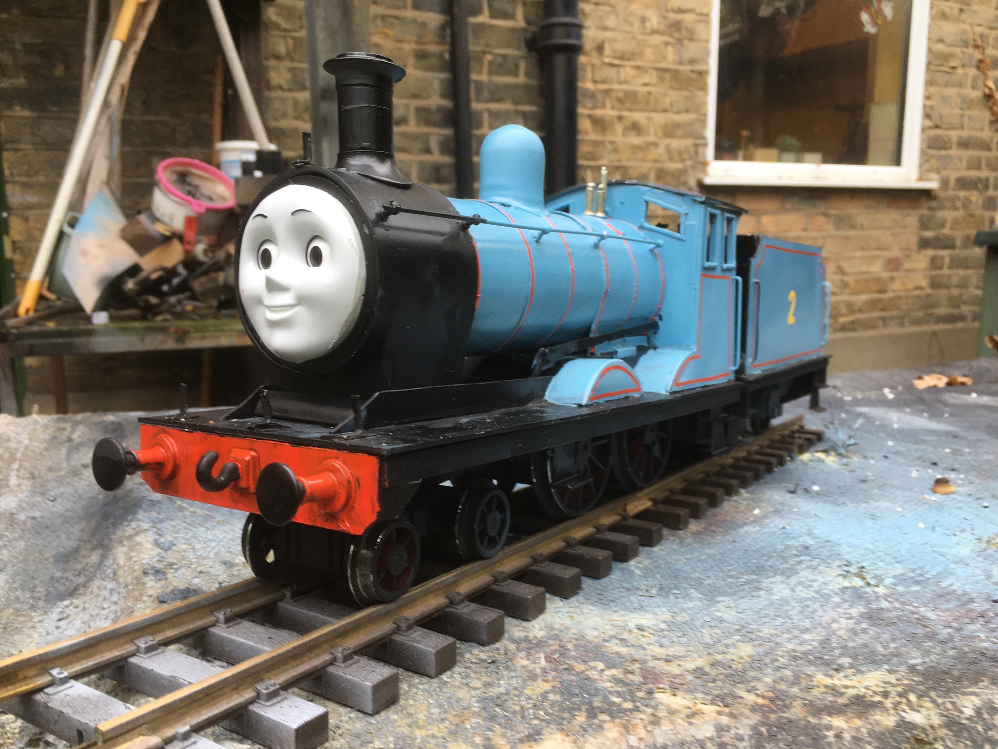

I’m Answer to the Gordon point whilst I E not built a replica Gordon I have built a couple of similar locos . Mine are based on the Romney Hythe locos.

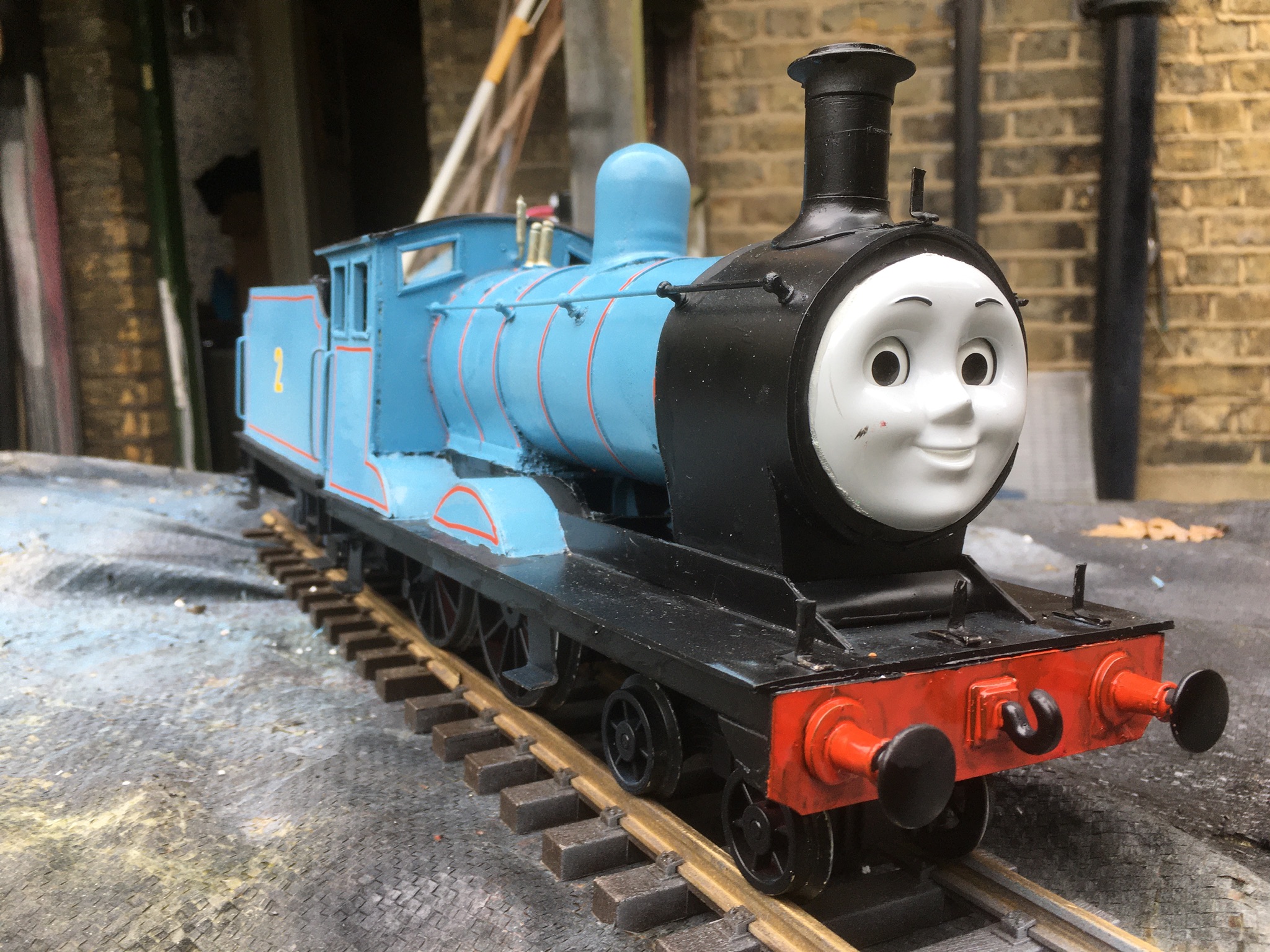

I’ve also built a model of Edward. Some where within this site my descriptions of building these locos exist under my Flying15 name.4FEAC63F-8F14-452F-A68C-E6FF934DCDFF.jpeg04893B16-1DD5-428A-B576-661D2E1C11D0.jpeg4D93C1EA-1CE7-4F2F-A9AF-DB7043DC3427.jpeg259CD272-B4E1-408D-862F-785D39AD3E61.jpeg690434BD-6155-41B0-9BB4-C0AF2344C5AD.jpeg496BFE72-16EC-406D-AFA5-68C234FD6F10.jpeg
Great models! I was surprised to realise there are real trains so close to Gordon - I'd always thought he was based off the Flying Scotsman - Im learning new things everyday off the Thomas wiki too, so I learned how to build his wheel layout from chopped up Marklin models before even what engines inspired him! Seems Henry is my sons favourite (perhaps because his favourite cat is also called Henry - all our pets have been named after TV shows from my childhood) so I may be making the big green fella in years to come rather than haughty ol' big blue!
Ive scoured 'threads created by' via your user profile but regret I cant find these builds: Im guessing stryene and lasercut parts? Or Brass? Do people use entirely brass at this scale if its electric, or is that the preserve of live steam crowd?

Hi the titles of the three threads referred to are:-
Edward-Thomas and Friends
Aristo Pacific motor block to Romney Hythe Pacific
RHDR 4-8-2 from Annie
I hope that helps

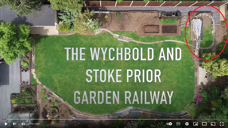

I too run Bachmann Thomas large scale trains in my garden.
I've been blogging progress at The Wychbold and Stoke Prior Railway

Keith - that is remarkably like what Im planning and a similar size space! I have to ask, what is the gradient here, my maths may be off but I'd imagined Id need a nearly five metre run plus the diameter of the curve back to get a station and bridge high enough to run back over the track with a clearance of around 9-10 inches? At 'no less than 1-in-30'.

The gradient is 1:40. The clearance under the bridge is just shy of 7.5 inches from the top of the rail to the Botton of the bridge. Tight curves add a lot of friction and severely reduce the length of trains that can be run.
This video shows a 20 truck train pulled by Diesel and banked by Paxton going up the gradient.
I will follow your progress with interest.
