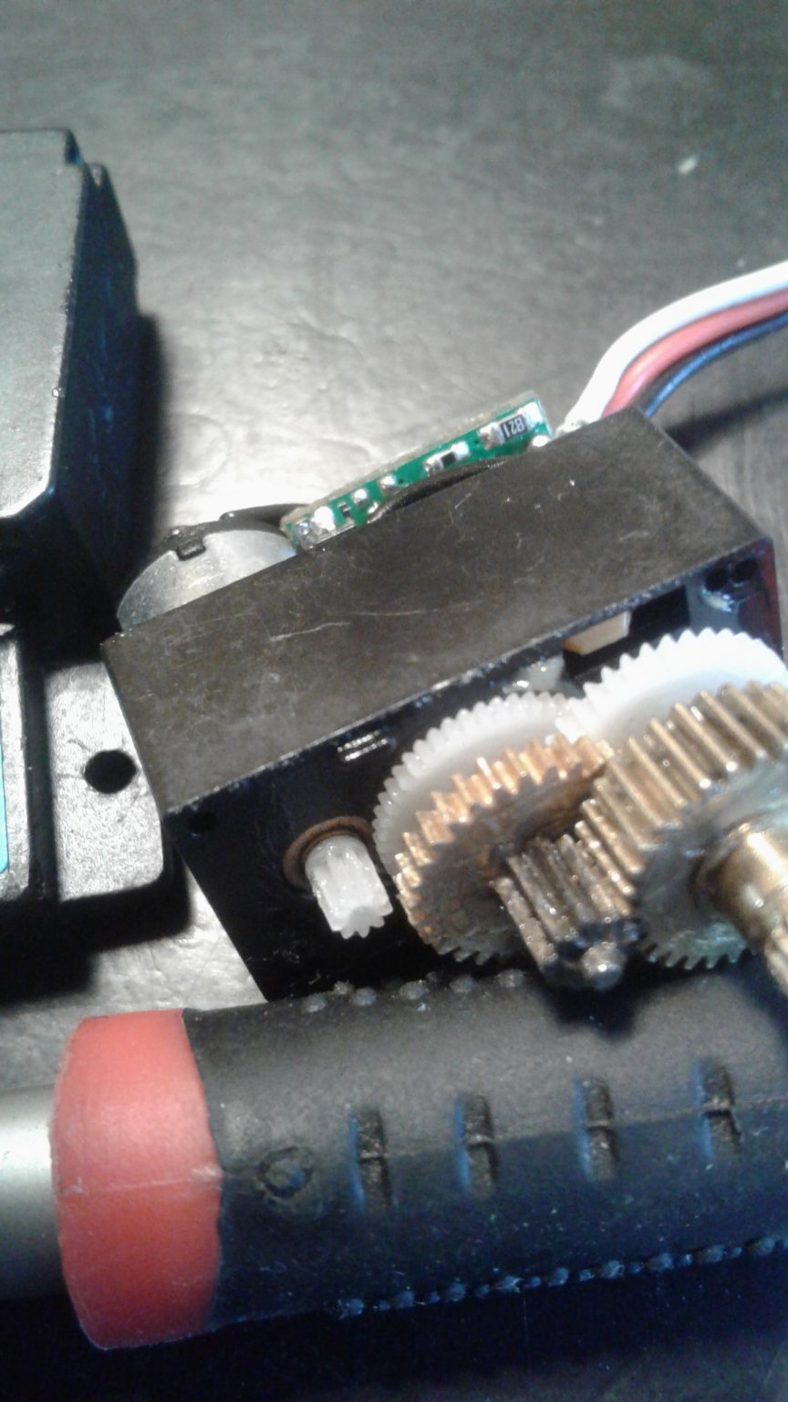

Gents, here's a dodgy picture of the offendingredients beastie. As you can see it's the link cog between the main drive and the rest of the gear chain. It's a Newpower servo, bought from a proper source.

Not quite sure I understand what I'm looking at in your pic, Paul - obviously I can see that the motor gear is no longer meshing with anything, but has the rest of the geartrain somehow moved out of contact with the motor gear, or is there a gear completely missing in the pic?

Yes Tony - one of the established names - Hitec, Futaba, Groupner.
Accucraft.de (MBV Schug) recommend HiTec metal geared servos for putting RC into their live steamers, and provide mounting brackets to suit. The reverser servo in my Wonky (Saxon 1K) is an extremely thin special type designed (I think) for control of flaps in RC aircraft.

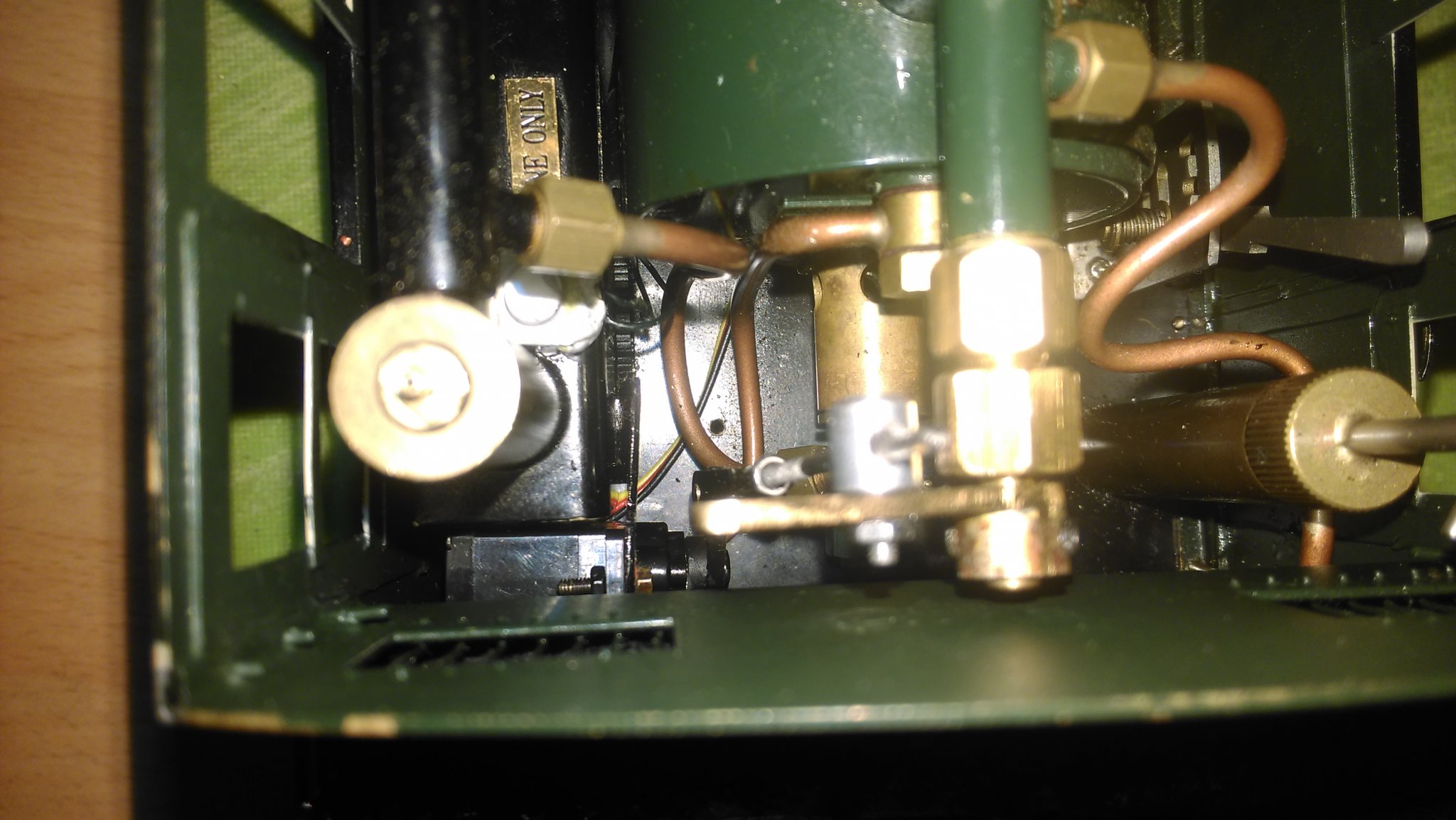

Right, OK, unusually for me, I taken on board all the advice given and made up a bracket, purchased and fitted a new Hi-tech all metal servo and put it all back together. As you can see from the picture it's not too obvious in the cab. Hopefully testing tomorrow will be successful. If not someone will earn merit marks for taking it away and putting it right for me!
