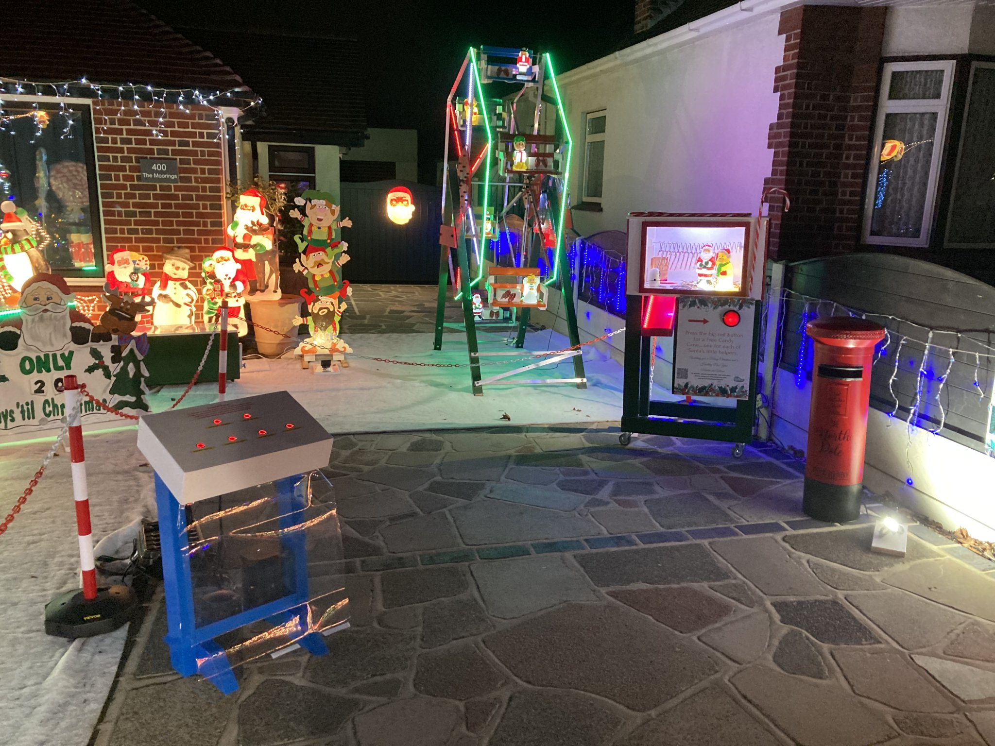

Cheers Dave. The kids won’t get too near it as I rope off the display area as there are so many cables representing a trip hazard. They just have access to the control panel, candy cane dispenser, and Santa post box. I would like to add a few straights to the circle to give it a bit more distance, and also need the track elevated to about a metre in height. Anything I build has to be removable and relatively quick to assemble, as the wife wants her front garden looking normal for 10 months of the year
Yes sure add a few more straights. Also kids seem to like tunnels. Elevated track would be a good idea as it would be running at their eye level. Maybe a bit less than a metre, 90cm? A couple of longish (2.4m x 0.8m) baseboards on trestles would be quick to make and assemble and would be enough room for an oval of track with approx 90cm straights and plenty of room for seasonal themed buildings and landscape in the middle.
