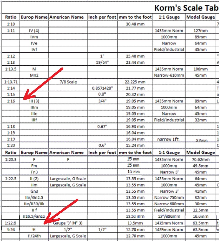

Ignore the gauge of the track, and reference the scale of the models to the prototype:
1:22.5 if metre gauge European.
1:13.7 if 7/8ths representing two-foot (-ish) gauge.
Anything else, you can do the maths! :D :nerd:

Within one of the links I posted is this little explanation of the history of the gauge#/scale standards adopted here Early Days of Gauge 3 | Gauge 3 I wouldn't get to hung up about the odd 0.5 mm on track gauge as even the major proponent of products for this standard don't seem to GRS 64mm | Garden Railway Specialists Tel:01844 345158 :)
Now, accepted ratio for 3' on 45 mm gauge is 15 mm scale, or 1:20.3 if you wish. This is the standard IoM modellers use, there is group who exhibit at the 16 mm NGM show each year. I model a lot of US outline D&RGW and logging NG locos and kit, 3 ft gauge. This to the US market is F scale, and as it models narrow gauge (n) running on 3ft it is commonly referred to as Fn3.
3'6" Gauge is sometimes referred to as "Cape Gauge", as it is used a lot in South Africa, and other nations that were part of the old British Empire. Used on tramways too ! There are a few on here who model 3'6" Cape Gauge on 45 mm track, likewise a few who do trams on that too, mostly our Australian friends here. There really is quite a broad church on here. Don't be afraid to raise and discuss anything. There are some G3 people here, and because of the crossover of their chosen scale (ok, near scale if we are splitting hairs) to Erupean narrow gauge modellers venture over there too. It follows 7/8ths on 45 mm gauge aproximates to 2ft gauge prototypes.
Really if you are going to shows just declare the scale of model you are choosing to run. I'm sure event organisers will put you straight on what they want/accept. Be creative. Keep a stock of props that can be placed on your layout to match the scale you are running. Then have fun switching them during the show. Most buildings you see on freelance large scale exhibition layouts are underscale anyway compared to the stock they are running. When you get to garden scales like16 mm structures can get quite large and unweildy - see the marvellous Brunel products if you want to get an idea.
Really, just do what you want to do and enjoy yourself. Max.
P.S. So how did 1:16 get to be such a commonly used scale for tram models ? It was also the scale used by makers of "ships of the line" when presenting models to the Admiralty as proof of finished product specs. Take a trip down to their museum at Greenwich some time.
To my thinking, your MER stock will be 1:20.3, running on 45mm gauge track; and, on the same track, Groudle stock will be 7/8ths or 1:13.7. But I suspect you know this already...:D
