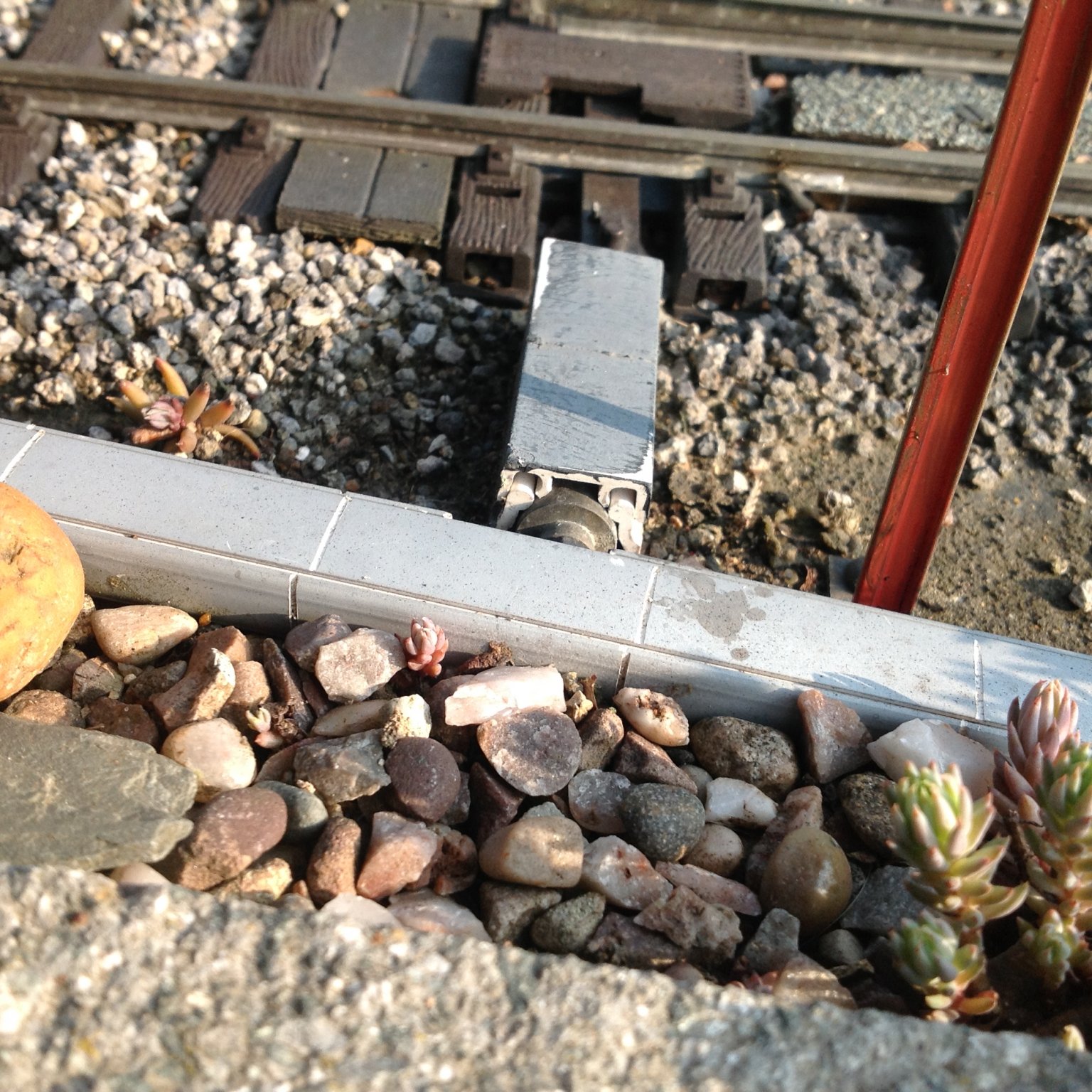

That is exactly what I use and it works fine. You need around 25/75 with a dab of washing up liquid. That is 25% PVA.
Only real issue is to ensure that you do the glueing on a warmish day, winter just does not work at all. Also be careful round points and try not to get any glue on the Rail surface. It is worthwhile to consider giving the moving parts of points a light brushing of Oil as this will stop the glue working where you do not want it to. I think one final point may be that if younuse overly large ballast then mixing with Cement will help and water in with the PVA mix. Here a pre spray with water and a little washing up liquid will help the glue get right into your ballast.
Pic a close up of some of my ballasted track using these methods, been down since around 2014 now. Big stuff at the front not glued.image.jpeg
