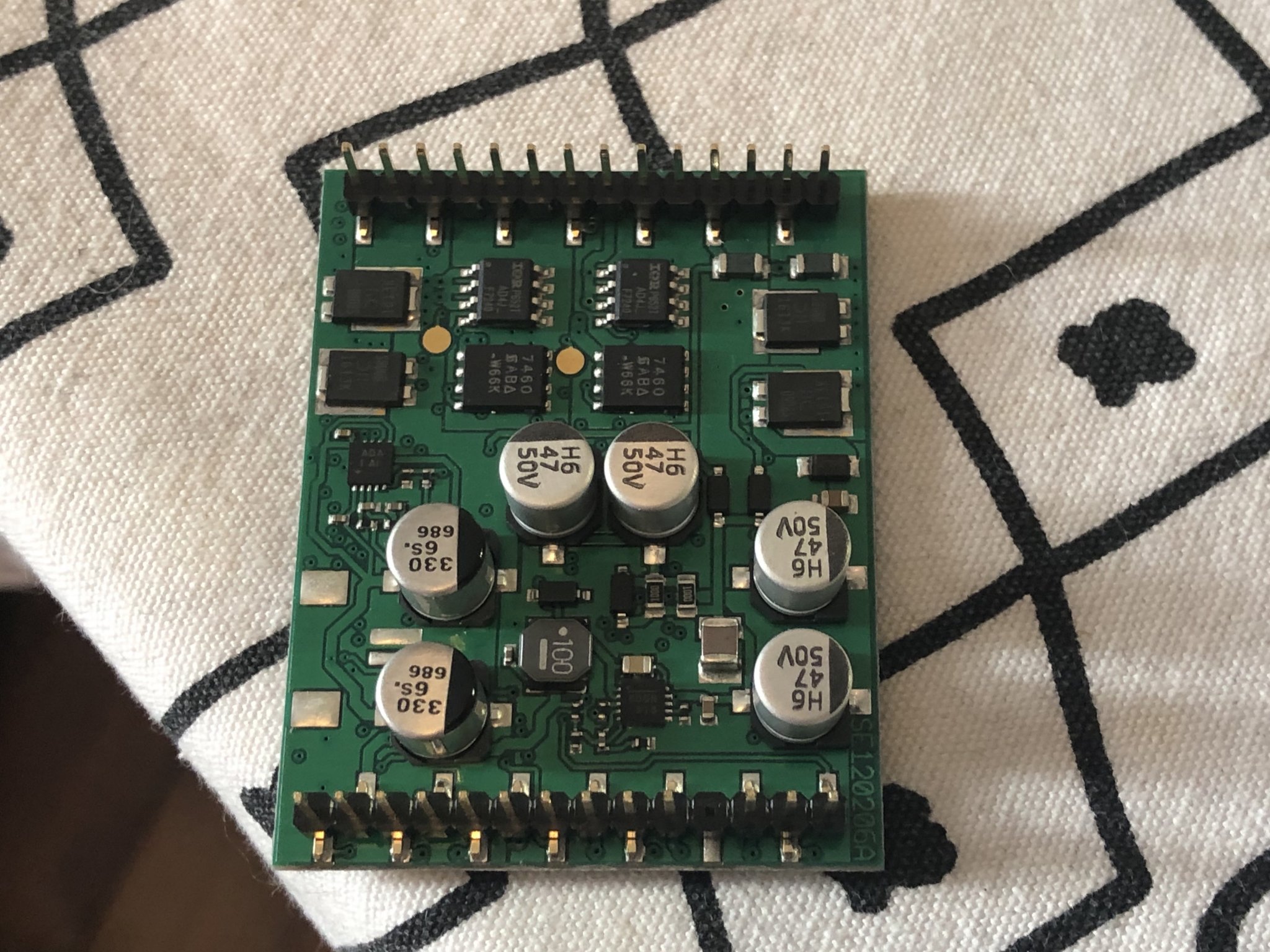

I think I've toasted the decoder on my LGB Furka DFB5 Rack loco (29272). :sweating:
Basically I was running a croc (with a first gen LGB decoder from the noughties), and the engine stalled, and *I think* this caused a voltage spike. The Rack loco was stationary, at the time, but it's now doing that erratic jumpy business, and now won't run at all. Textbook toasted decoder symptoms...
Can anyone help me with a) the decoder I'd need to source, and b) why this keeps happening? That's the second decoder that's blown on my now. They never used to do this. Aren't they supposed to have voltage limitation? All the wiring is correct. All I can think is that I'm running off a (reasonably old) LGB MTS system with a Mark II parallel CS...

What caused the Croc to stall? As to the FDB#5, I'd try a decoder reset before giving up on it if you haven't already. CV8 is the reset CV but none of the mfx decoder equipped loco manuals I've got say what value needs to be written to do a reset. You may need to find someone or a dealer with a Märklin CS2 or CS3. These have a loco reset "button" in the Edit Locos menu. Not sure what the replacement decoder is, 55028 or 55029, in any case you would need to find someone to program it with the correct sound file for you.
You might try writing the value 8 into the reset CV8. This is the value to reset the MLGB replacement sound decoder, 55029, to its factory values.
For mfx mLD/mSD decoders write 8 to CV8 to do a decoder reset.

Have you tried running the FDB#5 again since it "quit"? Sometimes a loco that behaving strangely just needs to be removed from the track for a few minutes till the keep alive is expended. This lets any temporarily scrambled instructions in the decoder clear. I had to do this to a mfx decoder equipped loco today. It runs and responds to commands fine after being removed from the track for a while. Might try re-booting the central station too if you haven't.

Thanks for your thoughts. I had a vague hope this might happen, but alas no. After a good hour of being off the line, I put it back...and nothing. Sometimes it races for a couple of seconds and then stops dead. And no response to any commands.
That's two mfx decoders pooped, now, and I only have a tiny ceiling layout in a city centre flat. It's a mystery! I know folk say it cannot be the running system, but I'm quite suspicious of my old LGB transformer and MTS II, I have to say... I'm running 4 locos -- 2 with with Lenz decoders and 2 with mfx. I think it's too weird for the old system... maybe it's freaked out by the decoder mix, or can no longer regulate voltage accurately, who knows? I also have a flickery old LGB RhB restaurant car; I've heard once that their capacitors can mess with DCC. Either way, I'm going to take the plunge, and update to a newly (albeit simple) running system.
Here's the culprit decoder from the sound-equipped rack loco. Going to send it away to get looked at, after which it'll either be rebooted by some miracle, or I'll have to folk out for a new one!
