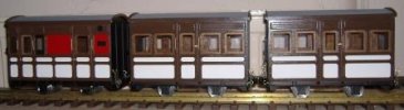

And here`s some I made earlier....3 years ago.
