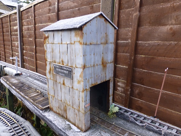

Why not try used Baked Bean or Dog Food tins? Worked for me. Rust well in time even after they have been rattle canned. Oh take paint well too.

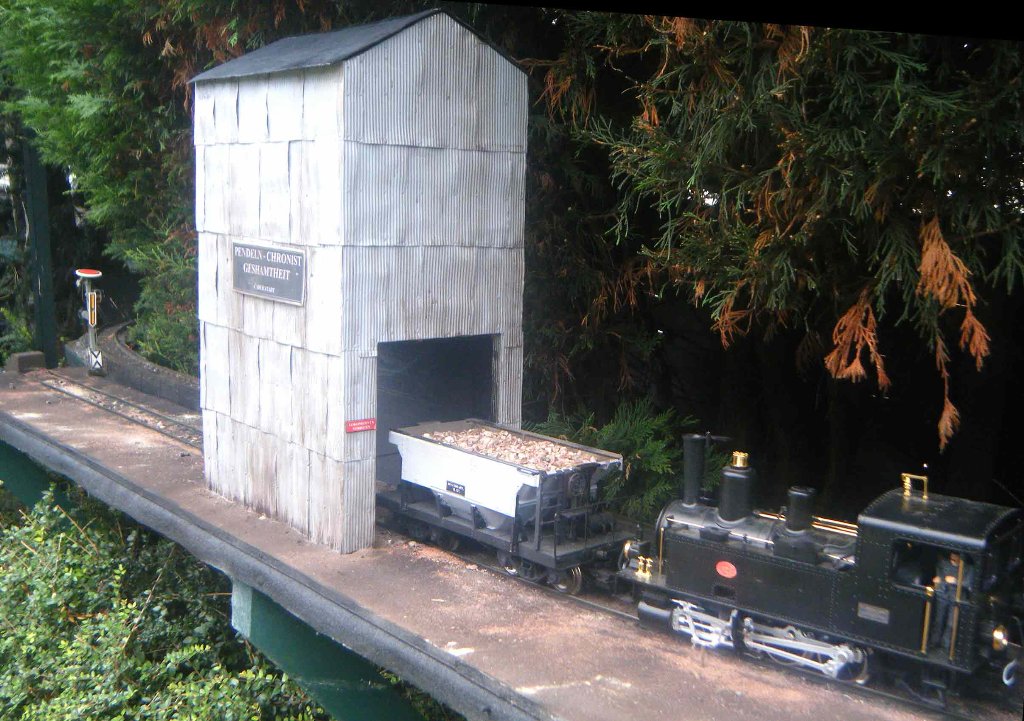

As built for the Ruschbahn.image.jpegNow that some rust has taken hold.
Still in the same place as built but that part of the layout moved to my Garden on closure of the Ruschbahn.
Heavy Timber Planking used for the sides and clad in the Corrugated Tinplate salvaged from Dog Food Tins, nailed on with Steel Nails. Only changes have been a new removable Lead Flashing Roof and the inside modified to hold the Gravel Loads that go into the Hopper Wagons between loaded runs.

Indeed it is but in all things you get what you reap. I just happen to prefer the patinia of real rust and am prepared to work to get it. As for flattening the Tin, a friend used to heat the cut pieces to Red Hot then put em on a heat safe surface and plonk an old smoothing iron on. Works pretty well for flattening them out and also gets a good start with the rusting/weathering process.
