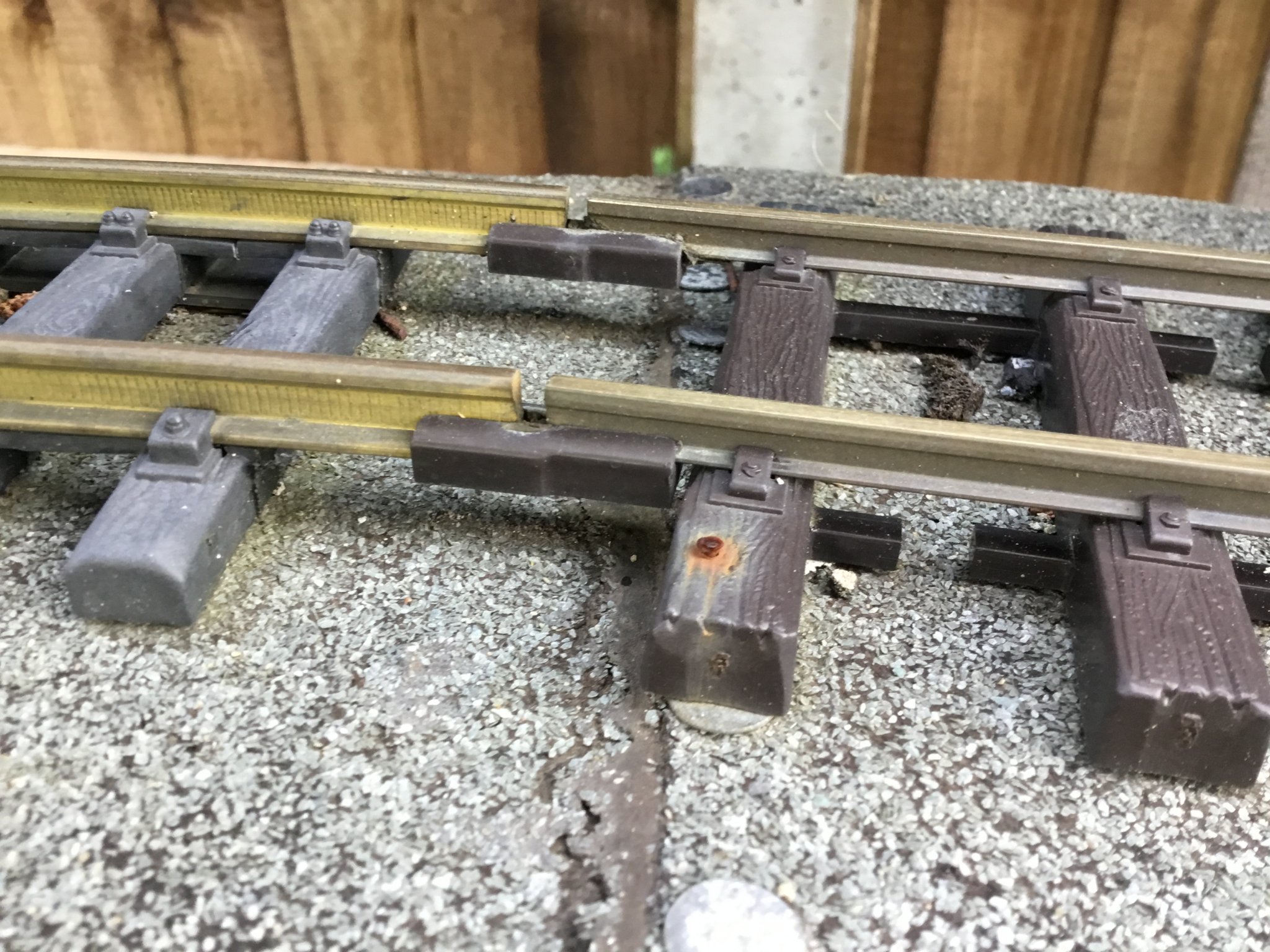

Yes I have done it using the Peco Adapters. I use them to make convinent Power Districts though they do have thin flat plate to carry juice. I would still prefer to Bond at Electrical Joints. SL 912 Dual Joiners.5B1F5648-3FE2-4957-9479-18E689357EF9.jpegThis is actually Peco to Aristo butbis exactly the same for LGB joints.
Thanks both for your most helpful replies. The track I have is G45, SL900 Flexi track, so provided I get some of these adaptor joiners I could well be in business. Thanks again!

The Peco joggle plates work well but the metal insert to carry power is totally useless - use a jumper wire instead.
