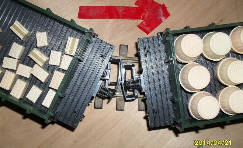

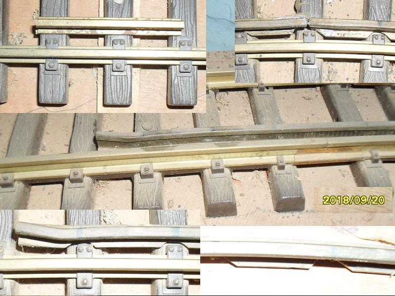

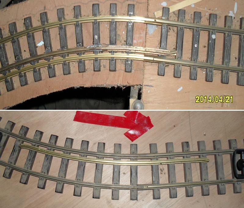

i had derailments on four axle flatcars from chinese Newqida. (with truck-mounted "bottleopener" couplers)
i found out, that the derailings always happened where after a R1 curve came a straight.
repeated observation showed the following:
when a car entered the straight, its rear trucks straightened up - while the front truck of the following car was still aligned for the curve.
i could remedy the problem with a guardrail (partly on the curve and partly on the straight)
