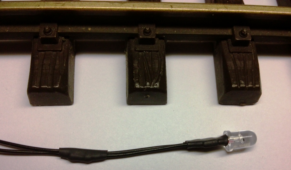

I just bought on an ebay-shop the below simple firebox flicker unit and will test it soon.

Firebox flicker LED for steam locomotives G, 1 and 0. Technical spec:
- 5 mm single LED incl. build-in flicker-control
- Flickers at about 6-22V DC and AC
- Ready for connection with approx. 40 cm / 15,7 “ long cables
- Suitable for G, 1 and 0
The two cables can directly be connected to the motor or to the track voltage. The polarity does not matter. The connection cable can be shortened if necessary. The LED can be placed in the cab near the boiler back wall / firedoor.
Note: The LED must not be bent or kinked!

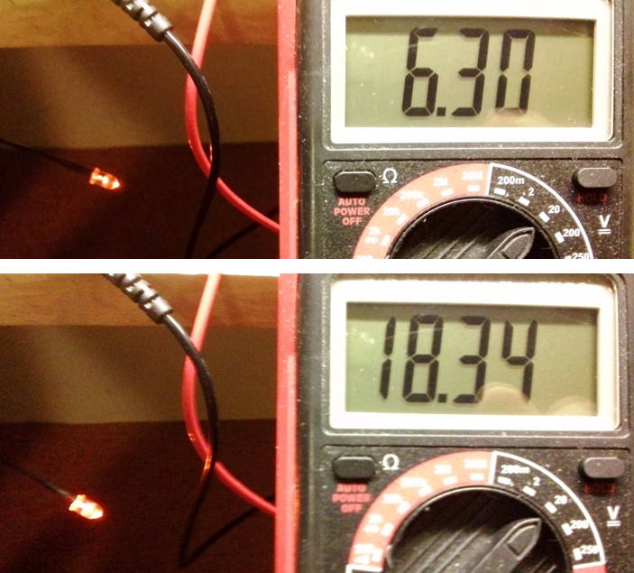

Analogue powered: The flicker starts already at 3V, with sufficient intensity at 6V, which doesn't change a lot up to 19V (just slightly more brightness)
DCC powered: I don't recomment to connect the flicker unit directly to the full track power since the flicker is not visible anymore and the electric gets hot. It will work when the voltage is reduced / dimmed. I tested it with an Uhlenbrock fuctional Decoder - PWM at 32 (ca. 50% dimm)- and it works reliably again.
This is the size of the unit incl. the flicker-electric in the heat-shrink.
A single diode, in series, might help with this? - A bridge rectifier being better if there is a chance of DC running..
